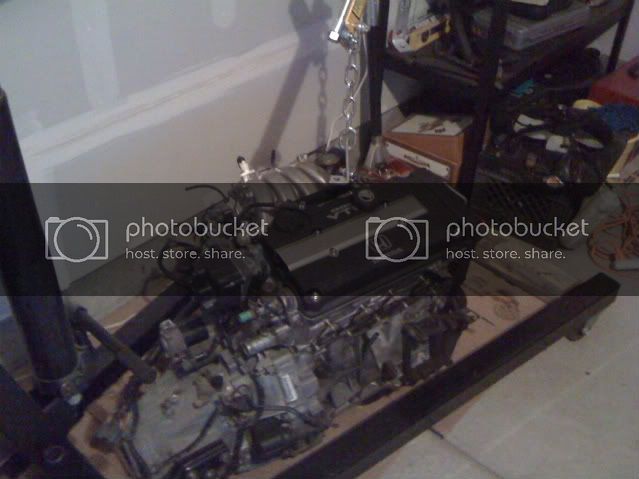

I did some more engine work, trying to get it ready to drop in the EG. I got a bunch of parts from hondapartsunlimited and went to work.

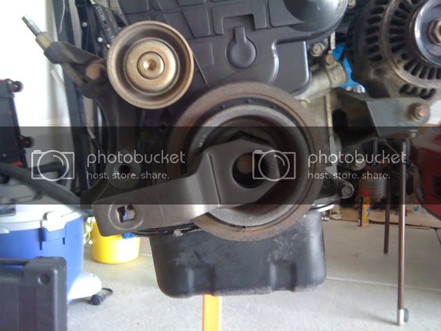

First off, I needed to get the crank pulley off and get access to the timing belt. Found this sweet little tool at the local parts store. This thing saved my life since I don't have an air wrench.
I replaced water pump, the tension pulley and spring, and also the timing belt as I was putting it all back together.

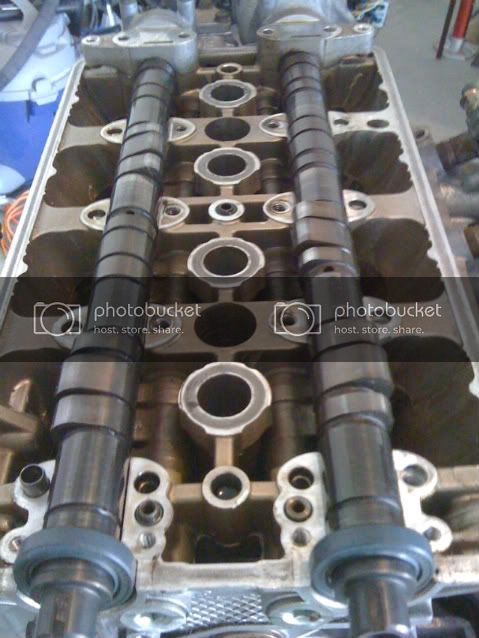

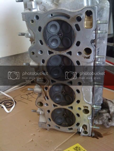

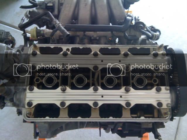

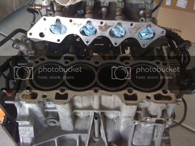

Got the head off and started getting at the cams and cam gears. Everything is looking like its in pretty good shape from what I can tell.
I like to take pictures as I take things apart so if I'm ever completely lost I have a reference other than the manual. I got a bunch of seals and o-rings with my parts to replace why I had it all apart.
Sat the head off to the side and later cleaned it off as best as I could.
Scraped off that damn intake manifold gasket (what a biatch) and inspected the head for warping before installing a new head gasket.
Got it back together and installed a new Excedy OE replacement clutch before putting the transmission cover/bell housing back on.

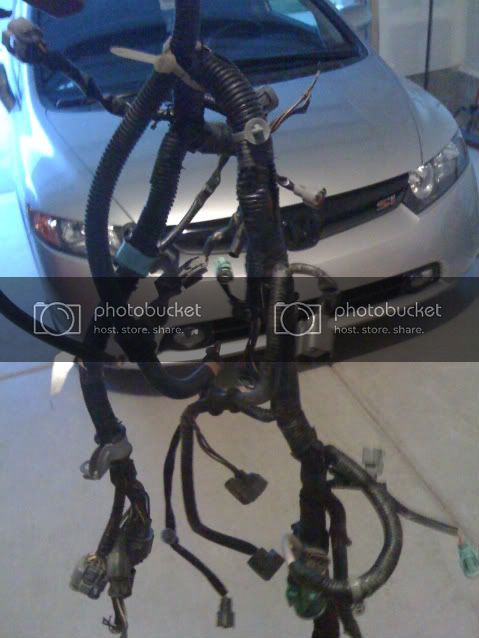

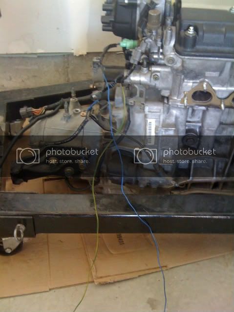

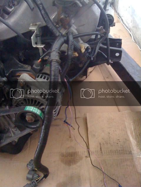

Well now time for the fun part :D .... wiring!! I yanked off the JDM engine harness. I'll use it for wires and spare connectors as needed. I transferred over the EG harness to the b18c and plugged in everything I could.

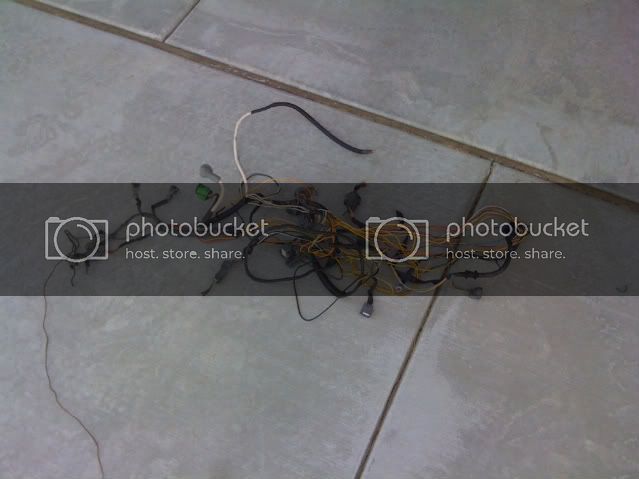

Here's whats left of the JDM harness lolz. So much sticky tape :mad:
Getting ready for VTEC yo! (sorry had to put that one in there) :happydance: Got the wires and connector ready for the VTEC solenoid and pressure switch. Yes this JDM engine had a pressure switch (green connector). After reading a lot of confusing and contradicting info on the net, I finally came to the conclusion that some JDM motors have the pressure switch, and others don't. I think all OBD1 engines have the pressure switch like the USDM version.
The start to wiring for knock sensor and the secondary butterflies.

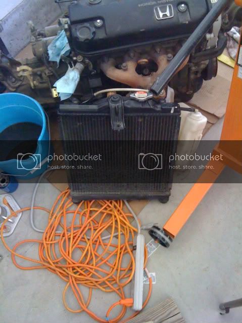

My radiator looking super ugly and just begging for a replacement......

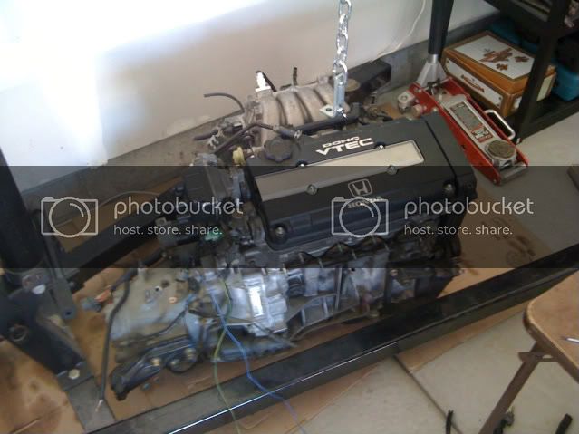

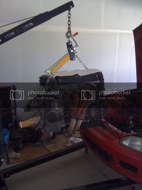

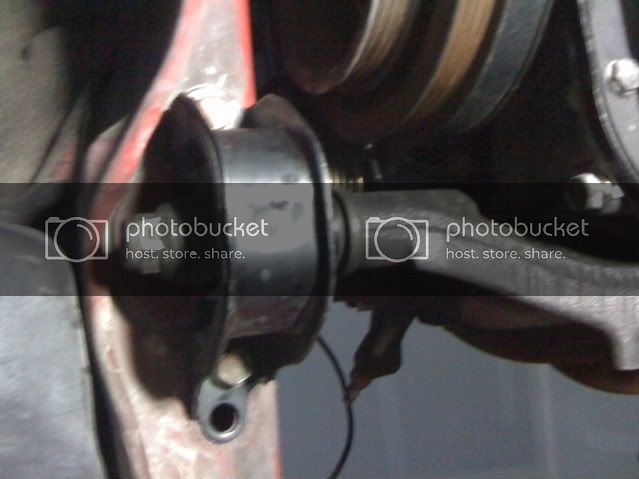

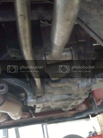

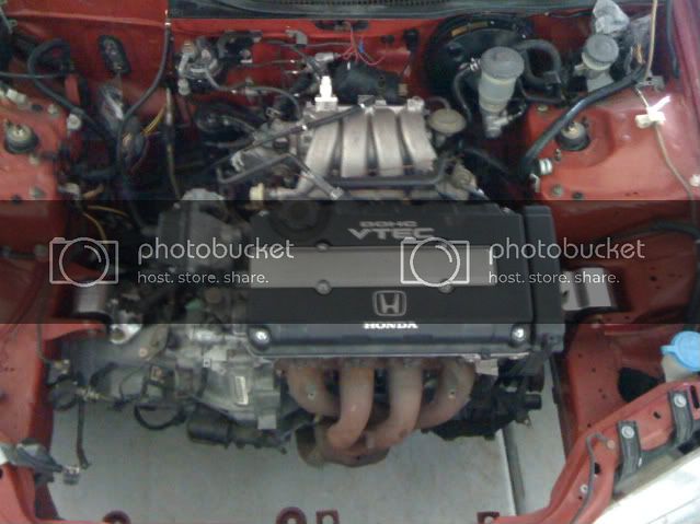

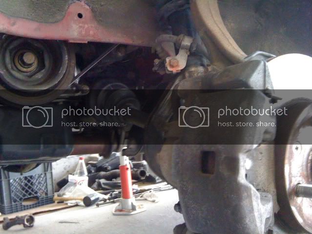

UPDATE !!!!! (8/29/2010) So my friends, it's getting close! I've been busy this weekend with the car (despite the fact that school started back up :( ) The formatting on the page right now is kinda acting funky so you'll have to bear with me. I left last time with a few wires hanging out and an engine ready to be dropped in. Got the wires ready to go and right about then my wife comes home from work. "What ya doin?" she says. "You're just in time," I repy, "you're going to help me get this engine dropped it!!" Now if you knew my wife you'd understand the humor in this. She is a beautician, and probably doesn't even know how to swing a hammer (no offense honey lol). Well she proved very helpful and we got the damn thing in there in only an hour or so. I think she even got a little grease under those pretty nails of hers hahaha!! Got the upper mounts in and stared in on the hoses and vacuum lines. I got the axles and shifter linkage in to place. Put the lower fork back on as well as the axle end spindle nut. Then came the first moment of truth. Did I get the damn clutch and shifter fork back in place right when changed the clutch?? I crossed my fingers as I stepped into the car and attempted to shift the transmission. It works!! Now on to the the lower engine damping mounts and throttle cable.

Car is up and running!!!! Everything seems pretty good. VTEC hit nicely. I do have one check engine code so far that came on after about 15 min of driving:

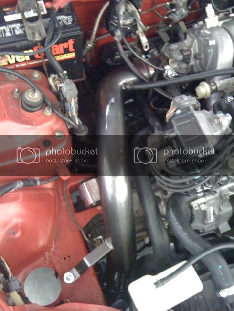

So I'm currently figuring that one out as well as trying to get my hands on a catalytic converter so a muffler shop can fix my loud exhaust. Running straight headers down the road makes a scene lol! I plan on replacing the entire exhuast, but not quite yet.

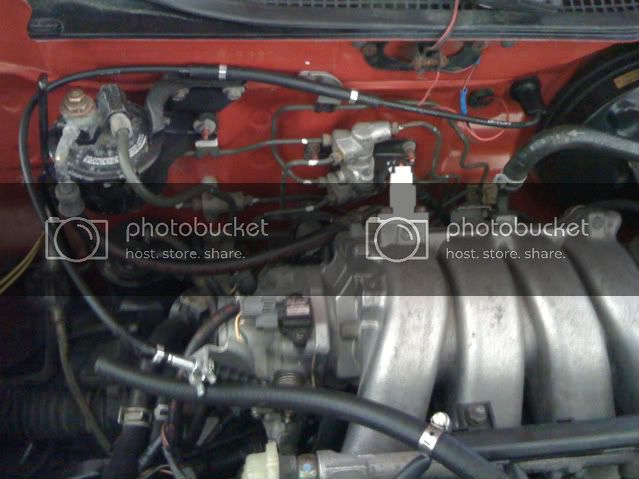

Got the intake put in:
