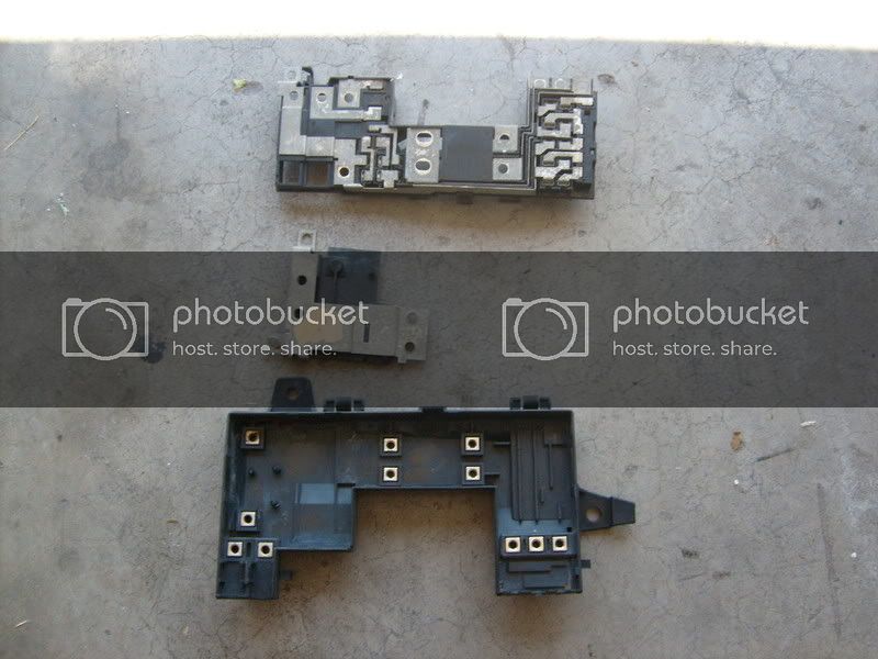

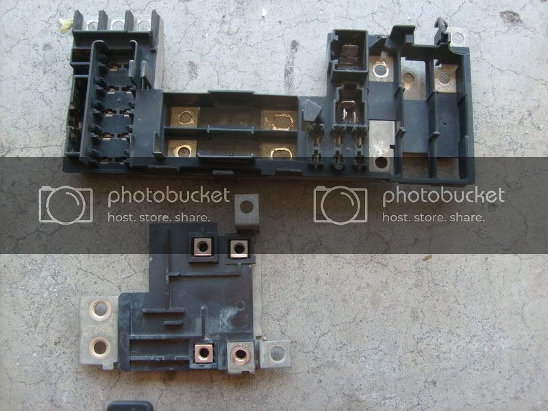

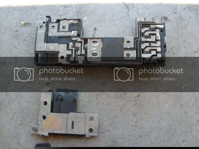

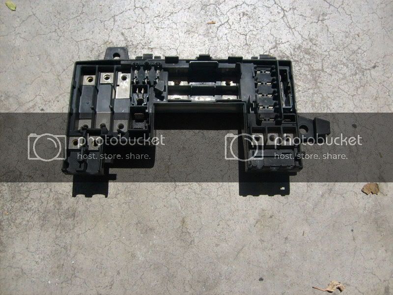

Well, I got another underhood fuse box from the junkyard. I disassembled the entire fuse box, down to the smallest part. I did not see any kind of "box" in there. Is the ELD some sort of enclosed box, or just a series of formed metal that leads to fuse ends? I'll take a picture today if anyone is confused on what I'm talking about.
Also, the fuse box is from a 93 integra, the same year as my car. I haven't installed it yet, because I wasn't sure if it was missing the ELD or not, since I did not see any "box"... Thanks for all the help so far.

What do you mean "nice try"? I said I took the junkyard fuse box completely apart down to the smallest part and that I'd post up pic's when I get home from work if you don't know what I'm talking about...
I'm telling you that I did not "see" a box... If you have a good pic of an electrical load detector, maybe I'd recognize what I saw in there and say: "Oh, I didn't know that was the ELD..."
Huh? The ELD is part of an integrated circuit. I have no idea what you think you can do in there, but I know what it looks like. Your not going to be able to solder off the chip that needs replaced.
You will not see any box inside the fuse box...
The fusebox that is located under the hood, next to the battery.... it all needs replaced. Remove all your old fuses and relays, unplug the harness, and slap the new one in.
