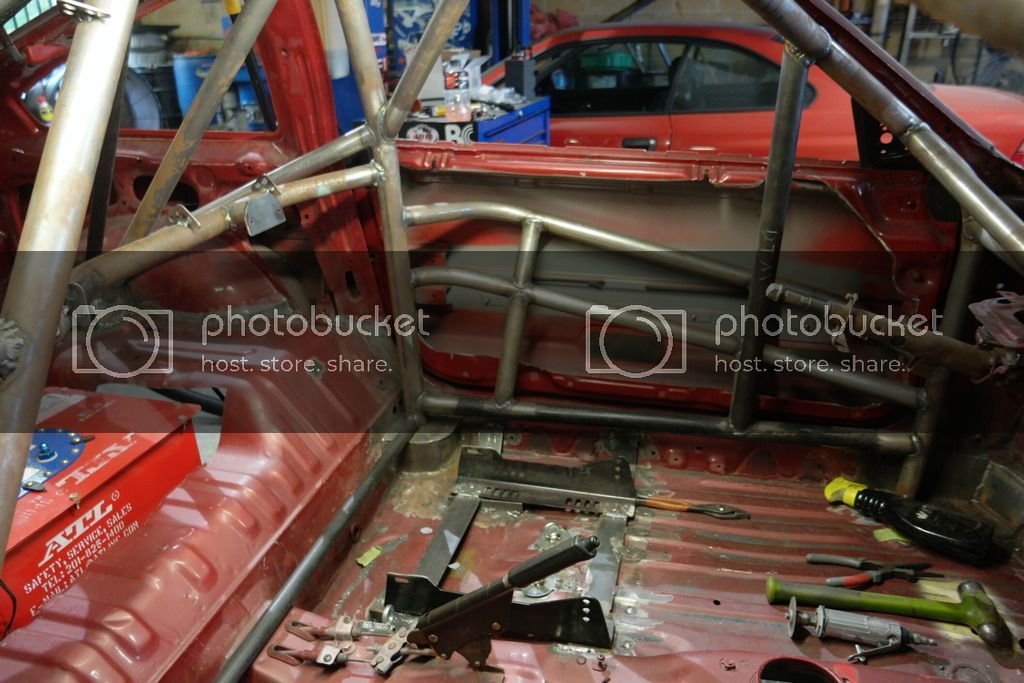

Once the seat was mocked up, we realized that my tiny little T-Rex arms weren't going to be able to reach the shifter when belted in - partially because tiny arms, partially because seat so far back. No worries, it's only metal!
are you moving the steering wheel back too? seems that easier accomplished with a spacer or something though, right?
Someone didn't notice that the steering wheel position IS already drastically changed... #unobservantian :D
