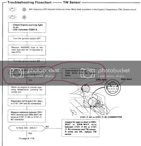

Yes start every time, but don,t start 2-3 time when is themperature outside "traverse"
38 º C. Problem has being in main ralay. Sorry for badly english.

reckedracing said:
code 6 is the ECT, correct
but manual what?
thermostat for the motor...
the ECT is the 2 wire coolant sensor off the head
tells the ECU how hot or cold the motor is to adjust fuel and spark
unplug it and try to start the car
i have never seen an ECT sensor make a car not run, it may run all fucked up, erratic idle, etc, but it should still start

Manual for civic 88-91 1.5i page who illustrated troubleshooting flowchart TW sensor.
Step 5 it my case is NO.
