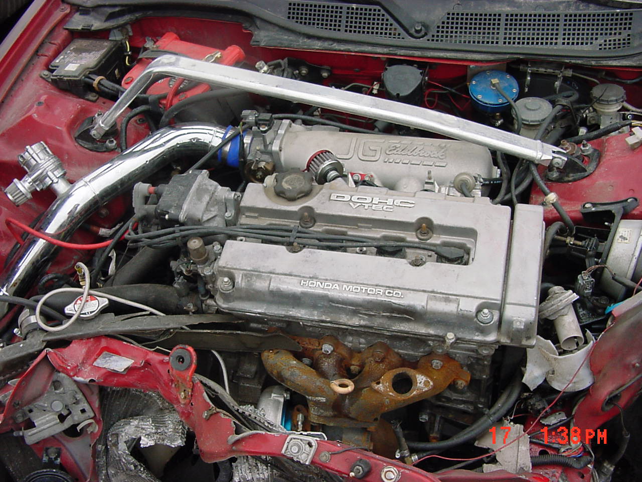

#1 - unless you can get that crashed POS fucked up car for 1 grand or less, don't. its not worth more than that. 90% of the turbo parts are useless and cracked/broken. the exahust manifold probably ripped a stuf or two out of the head. the turbo is crushed and bent. its useless. i cant see it, but i guarantee the intercooler is gone, along with the piping for it. basically, i see a good IM, and a bov. The waste gate is not there, which means water and everything else got into the entire turbo system, and the motor... who knows if a rat or something crawled in. in otherwords, buy the JG IM and BOV if you want, the rest in my opinion is useless.

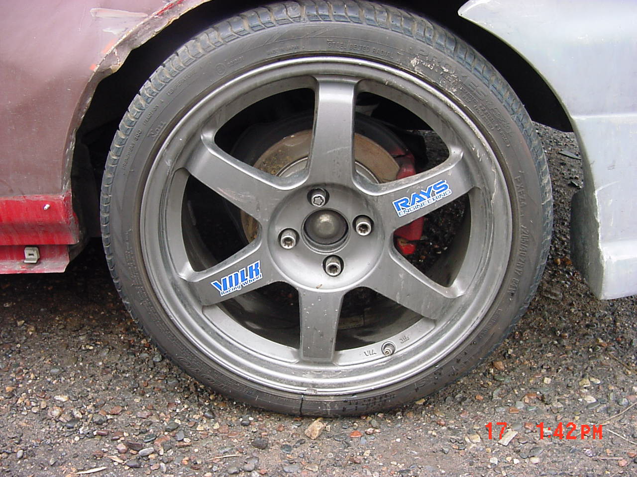

run at 16ish psi on 17's full interior
Having a goal of hitting a certain psi is stupid. go for a power gaol.
running on 17s is even stupider. 15x7 is all you need for street, 13x8 for the track. if you want to argue this in ANY manner, you are a ricer. you will never get the traction you need on a 17, and you will be slow.
