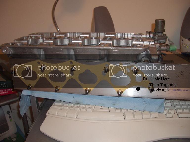

i was working on making the coolant hole work last night. but it will reqire partially filling it back up. i just drilled a hole straight through the thin edge of the plate then drilled the collant openings on corresponding sides of the plate. its not pretty as i dont have anything that takes a good amount of aluminum off at a time and i get frustrated, lol. ive tried stone bits, and other shit with the dremel but nothin really cuts that well. the little sand paper bits work well but wear out really fast. so its really hard to take off a lot of material and make everything smooth. like i siad its not pretty but it works.
pics:
kinda dark i know but the flash was fucking it up, lol.
this passage i made by drilling all the way through the edge. it goes all the way up to the passage seen (ITR side) the edge is were its gonna have to be filled/welded back up so coolant wont just fall out the bottom.
this is looking all the way through one hole and out the other.

Anyway, good thing you found that 'illegal stuff' clause. Regarding the coolant passage, you shoulda just drilled a straight hole in the plate where the actual passage in the head is, and just threaded a nipple in it, and not even used the itr's IM passage. Alot easier IMO than carving a passage to use the itr passage.
hmm. thats a good idea too. haha. im honestly surprised i didnt think of that. either way im not using this plate as it would mostlikely be illegal. im thinking ill make a few of them then sell them or something. but thanks for the idea. thats definitely something ill look into when i make the second plate.
