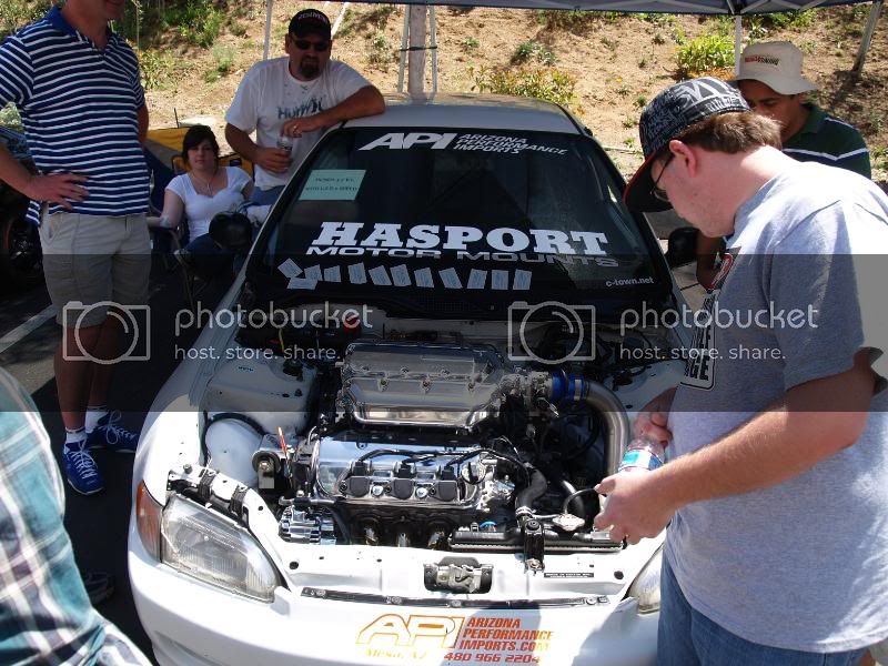

speaking of API .. i remember taking this pic at the Eibach meet last year... MDX swapped hatch.. they'd be the ones to talk to
