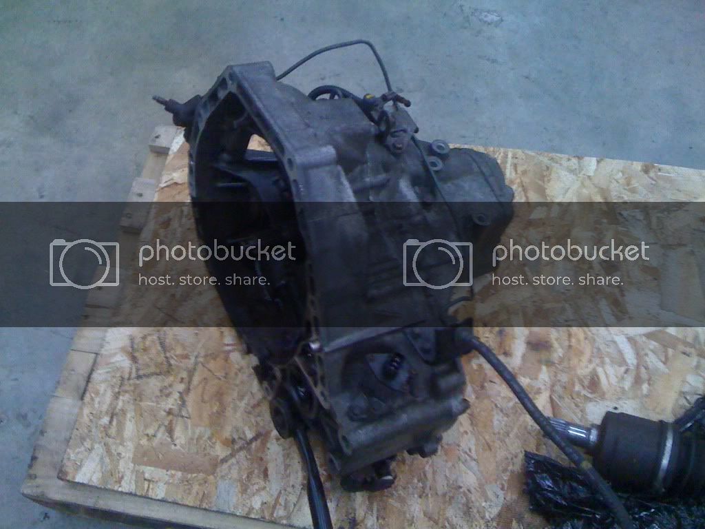

what a fucking nightmare has this been with these people at jdmenginedepot.... i was sent a trans, who the hell knows what it is or it came out of!! it is stamped E5 LSD any one who what the F!!k is that?
[/IMG]

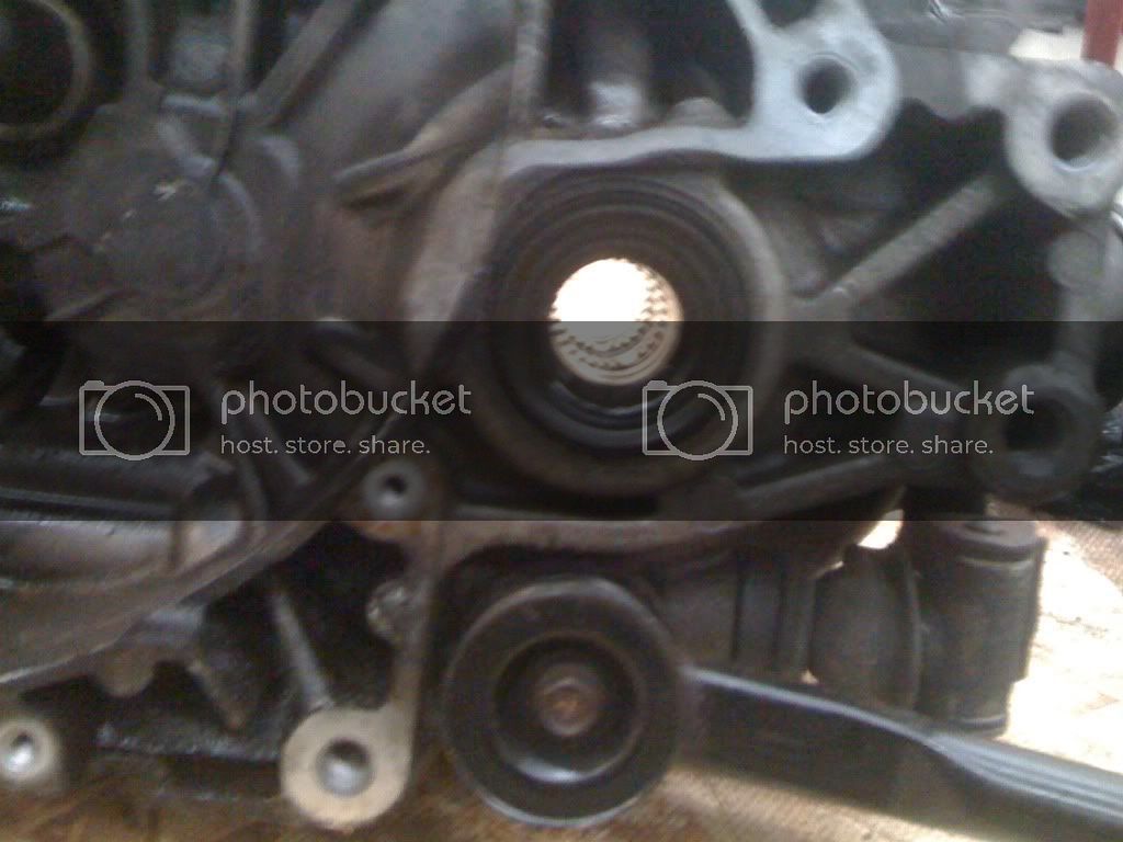

another pic, right hand vehicle for sure, but from what?
uh.... elaborate what you mean?
lsd trans were stamped or had the acid etch saying it was lsd.
will it not bolt up?
looking at the pics, it looks right to me.
no other numbers on it anywhere?
its out of a Civic Aerodeck
UK model that came with a B18C4
S9B

what you got was an LSD GSR trans pretty much
chances are they just saw the LSD stamp and figured you would be satisfied w/ that..
now looking at the specs E posted.. its geared lower than a GSR trans.. they're trying to screw you or something..
