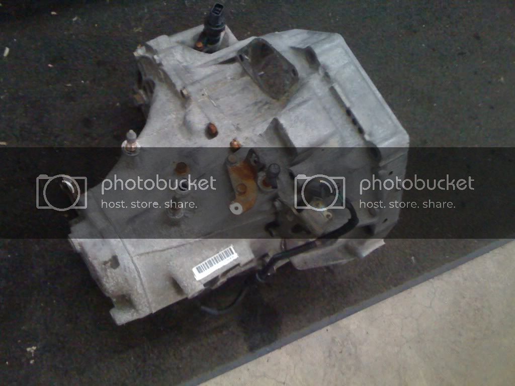

Its a pretty nice transmission! Glad the long trip scored you a kick ass transmission ready to rock (within reason :wink:)

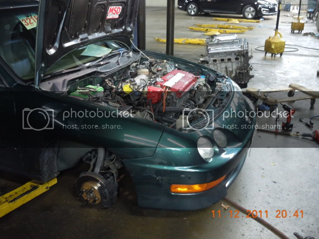

finished car on 11/13/2011 drove car home from work about 25 miles. trans felt weird but shifting, did not drive it at all monday or tuesday drove it today could not get into gear and when it did go into gear it would get stuck. something i did notice trans is loud at idle.
