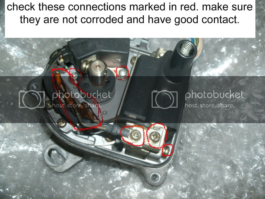

we were watching the a/f ratio the whole time and my tuner has all the information on his computer. it pretty much stayed the same throughout the pulls, even during and after the 6.5k miss. thinking that the wideband isnt fast enough to do anything about it.
The wideband should be more than fast enough to catch a change in A:F If its not it needs to be calibrated. When there is a miss your fuel to air should be really fat because there is no combustion going on. Especially when it hangs from 6.5k to 8k.
try using a buddy's dizzy see if that helps. if it doesn't then your problems are somewhere else.
yeah got to poking around i think i may have found the problem. i sure hope so, because its lot cheaper than a new dizzy!
just now, i was poking around and saw that the battery lug on the neg. side was cracked all the way through. i touched it, and it is super loose, like just resting there. who knows how long it has been like that and i didnt notice. at a glance it looks fine. ill be getting a new neg cable ASAP... keeping my fingers crossed that this was the whole problem!
dose your tach jump?
little update....
decided to get a new cap, rotor, plugs before i got crazy replacing my whole distributor, and it seems to have cleared the problem up. i need to get it on the hwy and do a 4th gear pull to be sure (it was only breaking up under high load). i could usually feel it in third gear and now i dont... but i want to be sure before i make another dyno appt.
