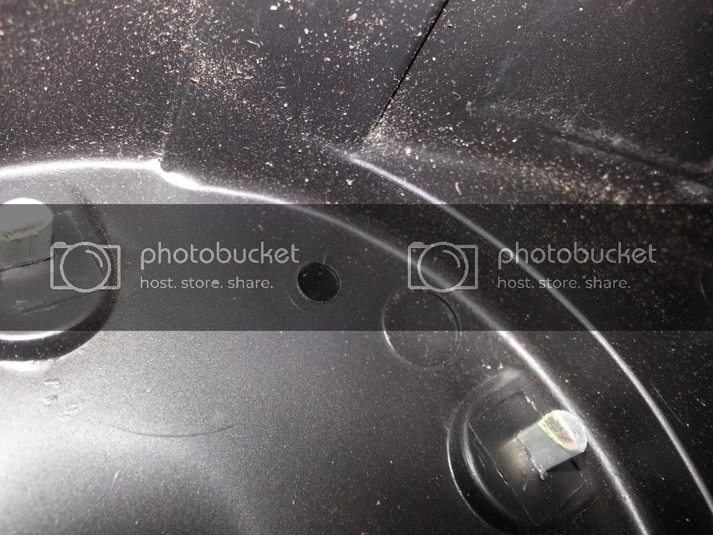

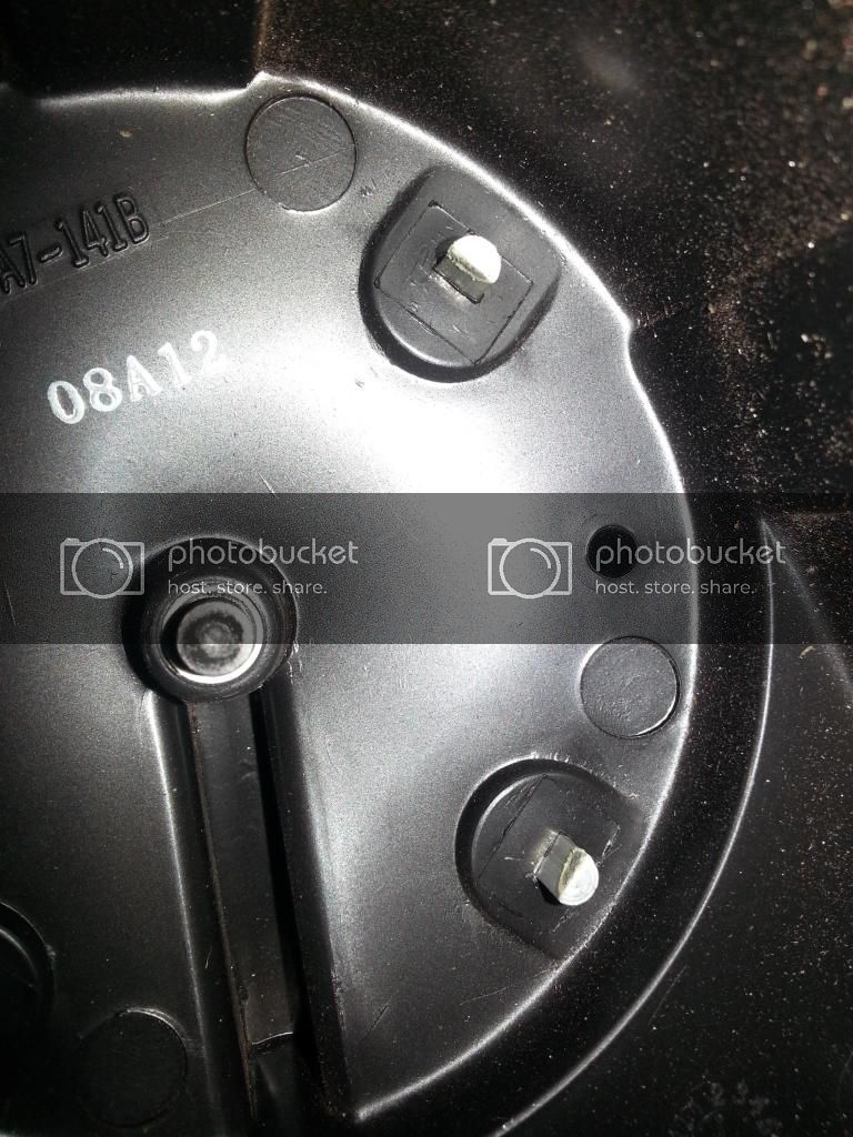

I replaced the spark plugs, plug wires, distributor cap and rotor button, fuel filter and I even readjusted the valves back to factory specs (they were really loose, it may have made a little improvement but it definitely made the engine quieter) ^_^
