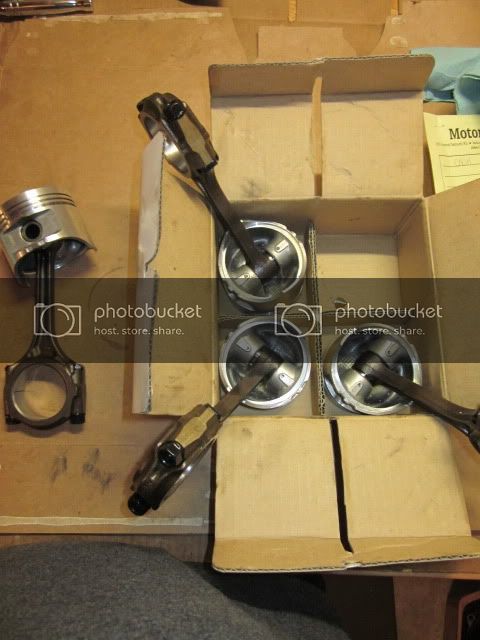

PG6 Pistons on D16Y7 rods with ARP rod bolts:

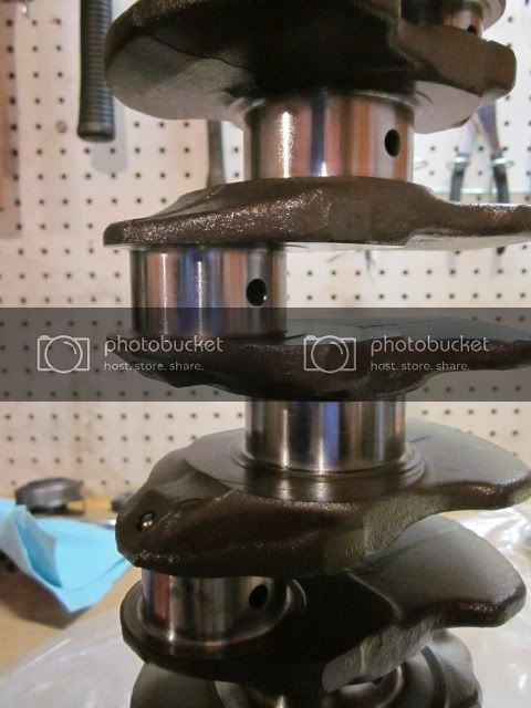

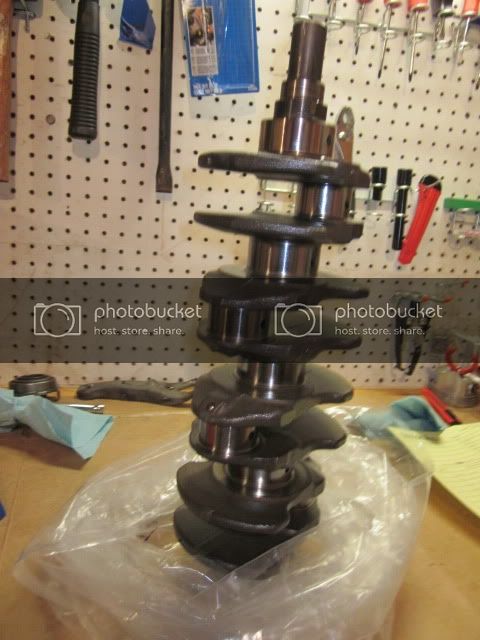

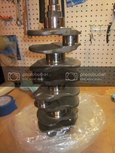

D16Z6 Crank ground down to .020 mains and .030 rod journals:

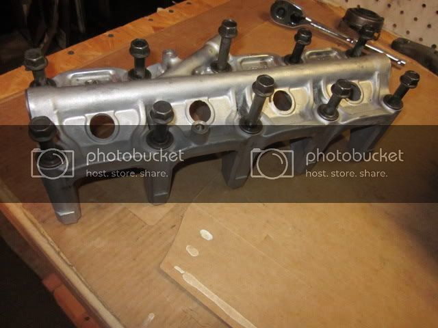

D16Y7 Griddle:

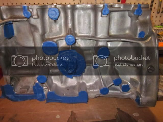

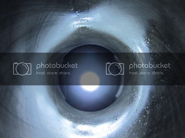

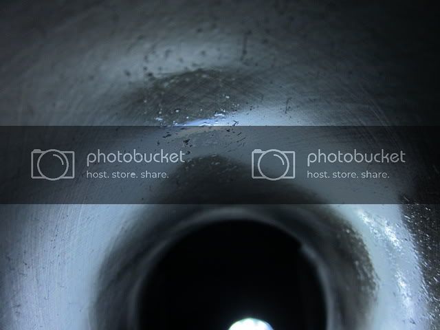

The trash in the cylinder left over from the machine shop that you can't really see with the naked eye:

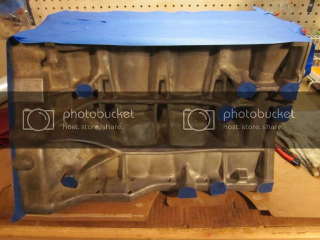

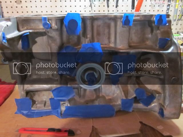

I figured I'd paint it up real fast too:

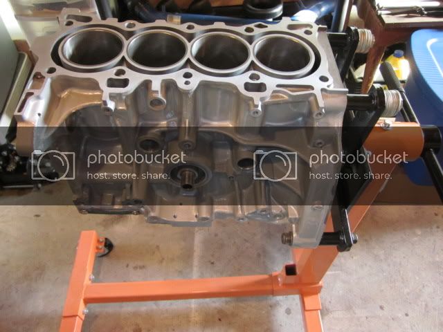

D16Y7 Block = 2 coats of block primer, painted aluminum silver (iirc), and 2 coats of engine clear:
Back to it's display stand lol:
