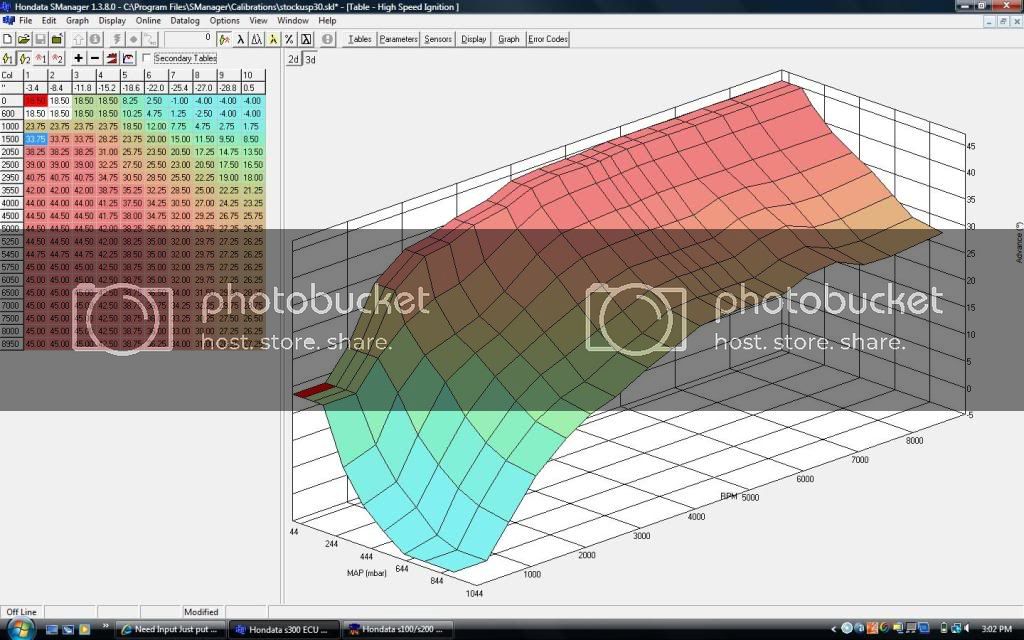

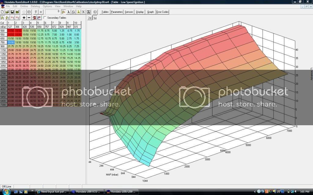

Looks like the JDM map is a bit more advanced. Ill pos pics in a bit.
USDM P30 Low Ignition map
USDM P30 High Ignition map
JDM P30 Low Ignition map
JDM P30 High Ignition map
So I "got on it" after work and it (CEL) still didn't pop up. It drives perfectly fine (except I still need a new Main Relay) and I'm wondering if its even worth worrying about.
In terms of the different ECU's....looks like the fuel maps are different. Better MPG?? lol
