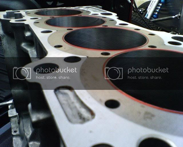

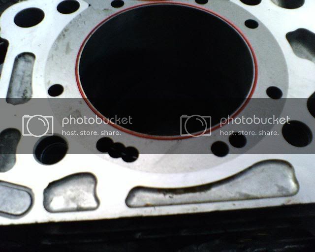

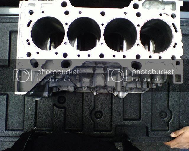

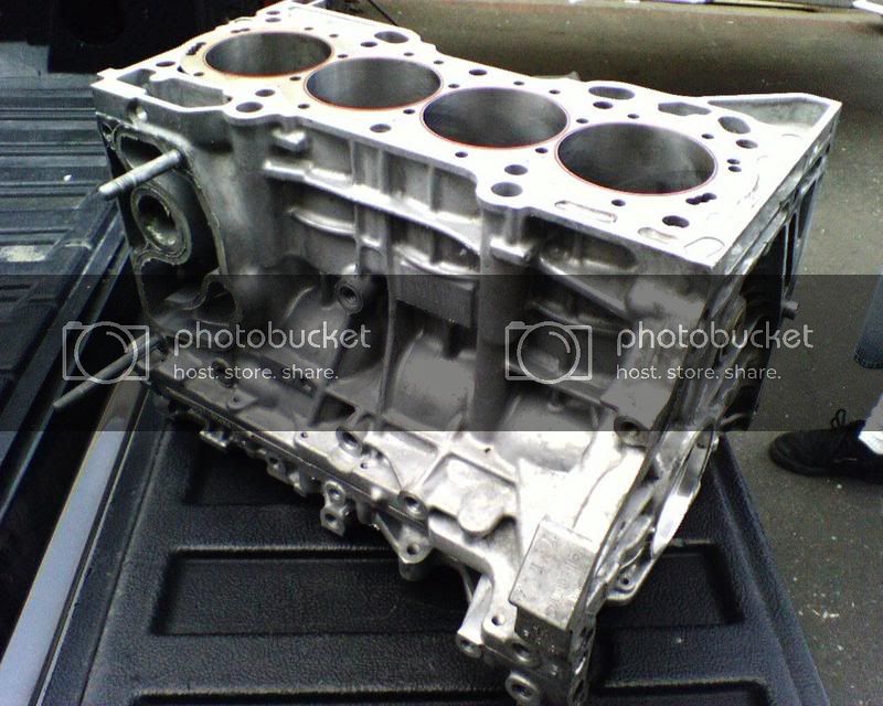

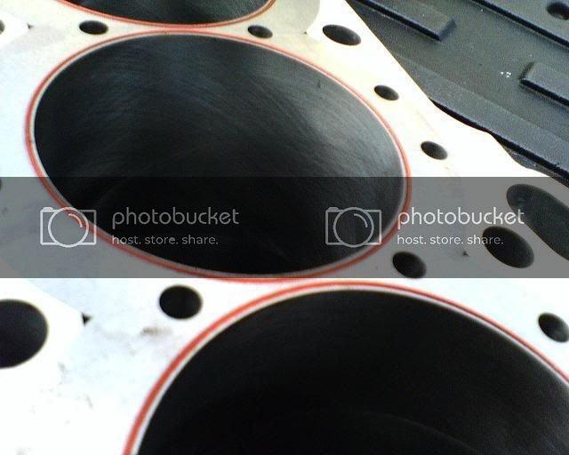

here it is she's a beauty... Aebs T-Sleeves, Final Bore and Hone 89mm, Stainless O-Ring... sorry for the crappy sidekick pics...

really? what price range you get? i talked to darton but i decided to go with AEBS the OG's of the T-Sleeve with solid deck... every one else started doing this after aebs.... plus most other sleeve company's had sinking problems, cause of how much material they removed when installing there sleeves... i have never heard of AEBS sleeves sinking... i pick AEBS sleeves over anything but different stroke for different folks... i think these were engineered really well that's why i chose AEBS... they can handle i believe 44psi or more... but mine will never see boost...
here you go from the site...
Bulletproof sleeve design featuring three-dimensional supports that greatly reduce dynamic side loading commonly experienced by conventional replacement sleeves. AEBS T-Sleeve with solid deck technology provides unsurpassed head gasket surface sealant area. All sleeve work comes with matched cooling ports to the factory head gasket. This ensures optimal cooling efficiency for both the cylinder head and block. Engineered for Naturally Aspirated, NOS, Turbocharged and Supercharged engines.
* Patent pending allowed
* Same material used in top fuel cars
* Successfully tested to 55 lbs. of boost
* "Best engineered sleeve" ... Sport Compact Car
* Application for B16A, B18A/B, B18C, B20B, H22 (97 up), K20 (RSX), and K24 (CRV)
