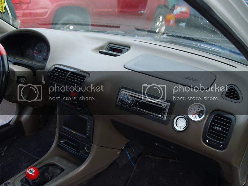

Just got the integra dash swapped in using the integra harness.
Everything works except the blinkers and dash lights. (Hazards do work)
Anyone have some insight on what I need to do for the dash lights and blinkers?
I figured that the yellow/black wire from the teg harness needs to go to the yellow from civic harness but that's as far as I have gotten.
Any insight? Thanks!

Let me ask this. On the
DIY over at honda-tech it says to put the yellow/black wire from the GREY gauge cluster plug to the yellow wire on the GREEN gauge cluster plug.
Can I just cut the wire/take out the pin from the grey plug and then solder it into the wire on the green plug?
Also the blinkers and dash lights are in no way linked correct? I probably just connected the dash light wire to a wire on the teg harness that isn't even used. Or the SRS .. I just need to get back up to the shop and start lookin around.
There are like 5 different wires on the integra harness that aren't used.

Update: I just checked out some wiring diagrams in manuals at O'rileys. Now i'm not the best at understanding them, i think I have a better idea of whats going on.
it looks like the dash lights (integra) are in the same switch/relay/box thing lol, that the blinkers are. My guess is that when the blinkers are hooked up the dash lights should be active as well. Anyway, I'll update once I get off work and try it out.
I would leave your car's plugs alone and splice/soder the wires. You can do it how ever you want but IMO the plugs should still be there (take out the pins or just chop and connect)
update: got the blinkers working. Now the only issue is that the dash lights still don't work........... ??? back to the board tommorow! please feel free to add any suggestions.
Yea, Everything is out of the same car. a 1997 Integra LS.
This is where I think the mixup is. The Honda-Tech tutorial deals with an OBD-1 teg. This one I'm working with is OBD-II.
