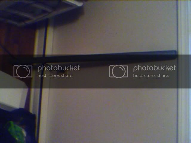

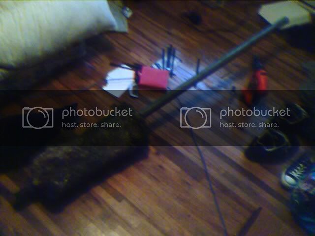

im gonna cut this end of this bar with cement on it off and use that.
its longer than 3 feet!
before..
after..
ima use this shit to try to break that sucka!

dude... that fence post is weak ass metal... lemme guess. it bent/broke?
no, it didnt bend or break.
and like i said before, the jack i have has a handle thats only about 1/4 across, and it has a little pole that goes across the inside anyway, so even if i got a breaker bar that tiny, it wouldnt fit.
aww thats too bad. my crapsman (craftsman) handle is about an inch across.
