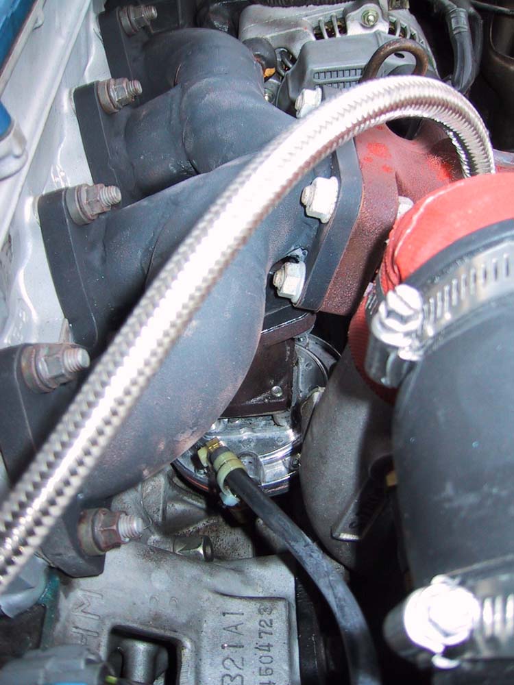

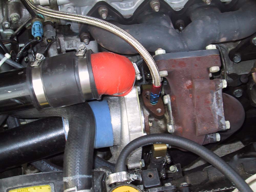

*Since we are talking about Tuning, we might as well cover TurboCharging and the Parts for Boosting, here are the choices as of the date of this write up*:
1. Have a local shop custom make a Exhaust Manifold and Downpipe to your specific needs.
2. Call and have lsdmotorsports.com sell you their kits and or parts for your Boosting pleasures. LSDMotorpsorts is the only one who is actually carrying custom made parts for 3rd Gen's on their shelves. I personally have purchased a Exhaust Manifold and Downpipe from them. Mike(sales@lsdmotorsports.com #1-877-573-6686) - is the guy I talk to every time I call and he has been extremely helpful and non-biased about setting up my car. I highly recommend them and I know you will be happy too! (sorry just wanted to give my little testimonial...hahaha!!)
3. Ebay for a lot of miscellaneous parts like Turbo's, Gauges, MAP Bypass links, Oil feed and return kits, used ECU's, Conversion Harnesses(I recommend emailing the Harness sellers to ask if they can build you one with the pinout above), and high flow injectors. And so forth.
4. Here is a picture of the www.LSDMotorsports.com T-25 Manifold and Downpipe:
These parts are made of all stainless steel metal and are of good quality craftmanship. You have other options, I am only using my setup as an example for all you wanting to know - parts etc..

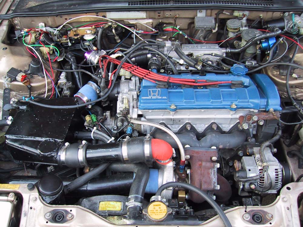

*And for the record, my setup will be:
T-25 DSM Turbo w/7psi wastegate, www.LSDMotorsports.com - Manifold & Downpipe, PR4 ECU(chipped and Tuned on Crome), www.Boomslang.us OBD1 Conversion Harness, 450cc DSM Injectors, 255lph fuel pump, 12" and 10" 2.2" 1250cfm Slim Radiator Fans, I will add a Wideband O2 sensor and gauges at a later date, that is why I had the extra O2 Bung installed. A Custom made side mount Intercooler. And of course the necessary gauges and oil feed and return kits. All this is on a Stock B20A JDM engine and stock internals.

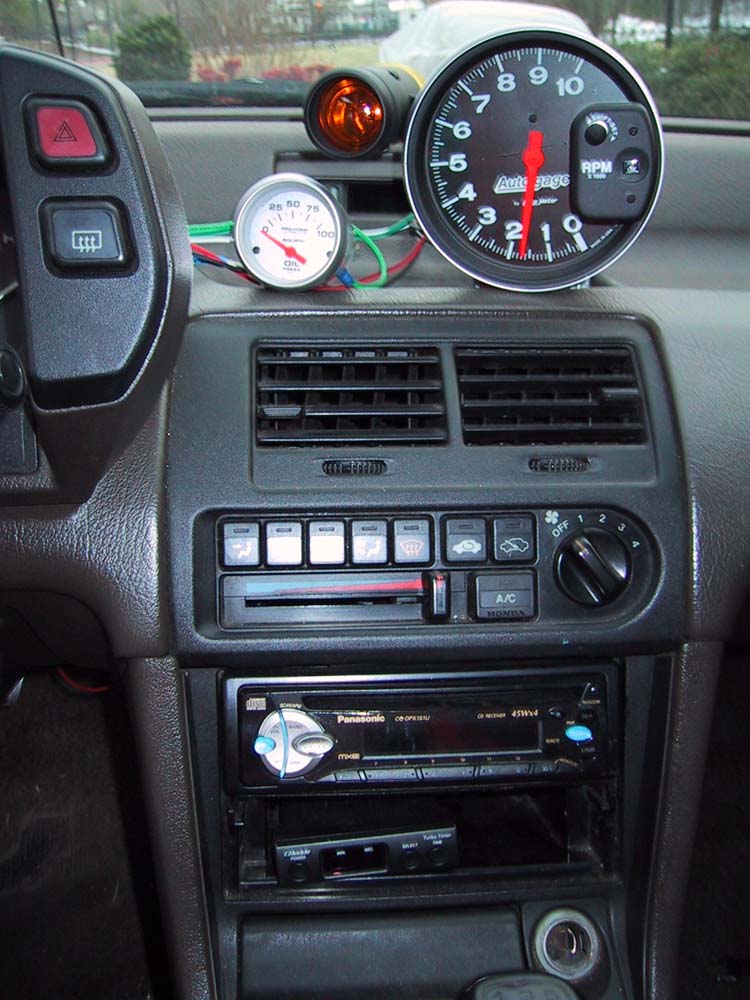

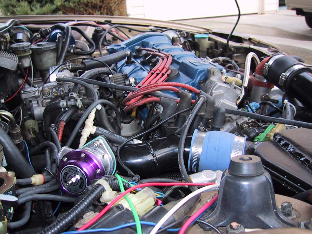

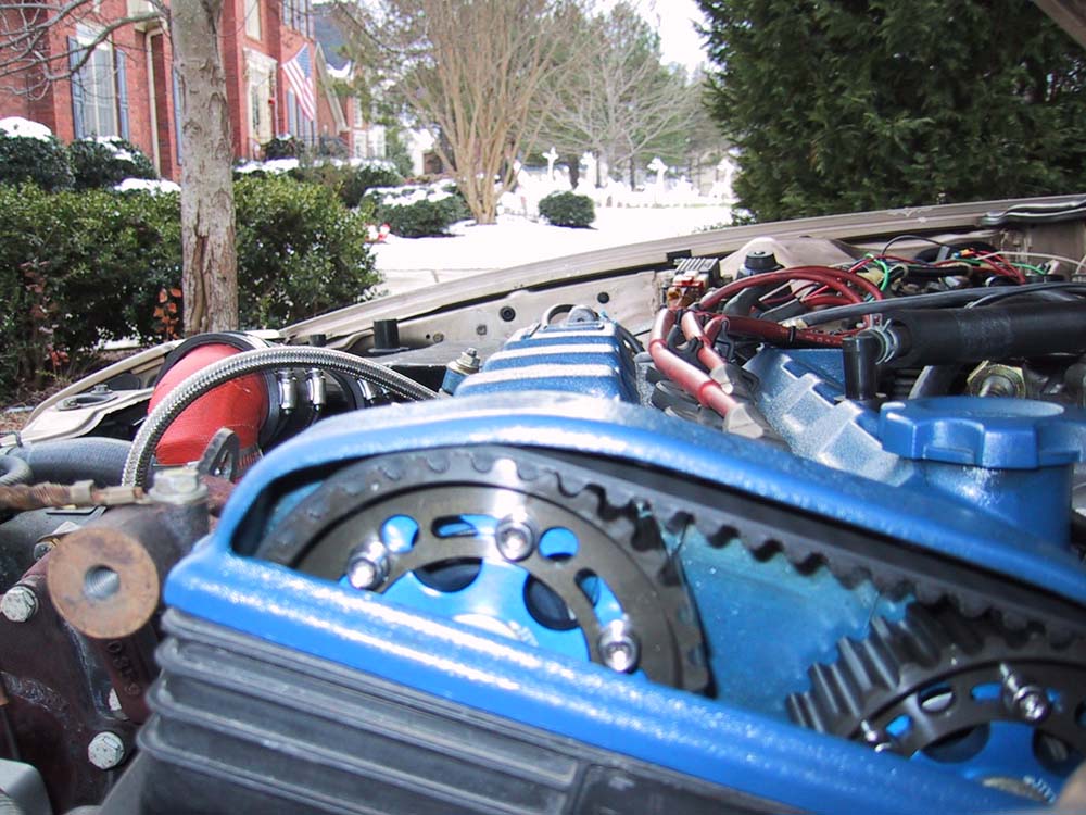

I found this on another members post so I thought I would post in this thread:
1989 Honda Prelude Si Turbo
Atlanta, Georgia, USA
Car:
- 1989 Honda Prelude Si Turbo (16V DOHC 2.1L)
Engine Mods:
- Garrett T3/T4 hybrid turbocharger
- LudeSPEED Liquid-Air Intercooler (using A/C condenser as heat exchanger)
- GReddy Type-S BOV
- Wiseco (7.5:1) Forged Pistons
- Total Seal Piston Rings
- Pauter H-beam Forged Rods
- Bored 30 over; iron-sleeved back to stock displacement
- Vortech FPR
- Skunk2 Adjustable Cam Gears
- LudeSPEED Turbo Manifold
- LudeSPEED 2.5" Downpipe
- Polished and Balanced Crankshaft
- 3 Angle Valve Job
- O-ringed head, Copper Head Gasket
- ARP Head Stud Kit
- Unorthodox Crank Pulley
- APEX'i S-AFC -
Car:
Engine Mods:
- GReddy Type-S BOV
- Vortech FPR
- 3 Angle Valve Job
- ARP Head Stud Kit
- APEX'i S-AFC -
If you want to see his whole page here is the link:
http://www.geocities.com/rolin5_jason/prelude/
