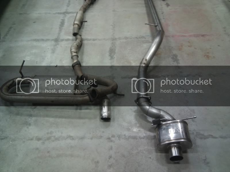

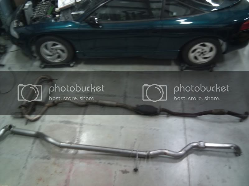

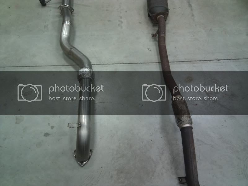

talked to the shop about a custom 3" SS turboback and the price is right so I'm starting there

wow, awesome exhaust, but a little curious as to why you decided to go with no resonator.... it would still be free flowing, but a little quieter, considering the tubing diameter, and the small muffler...
