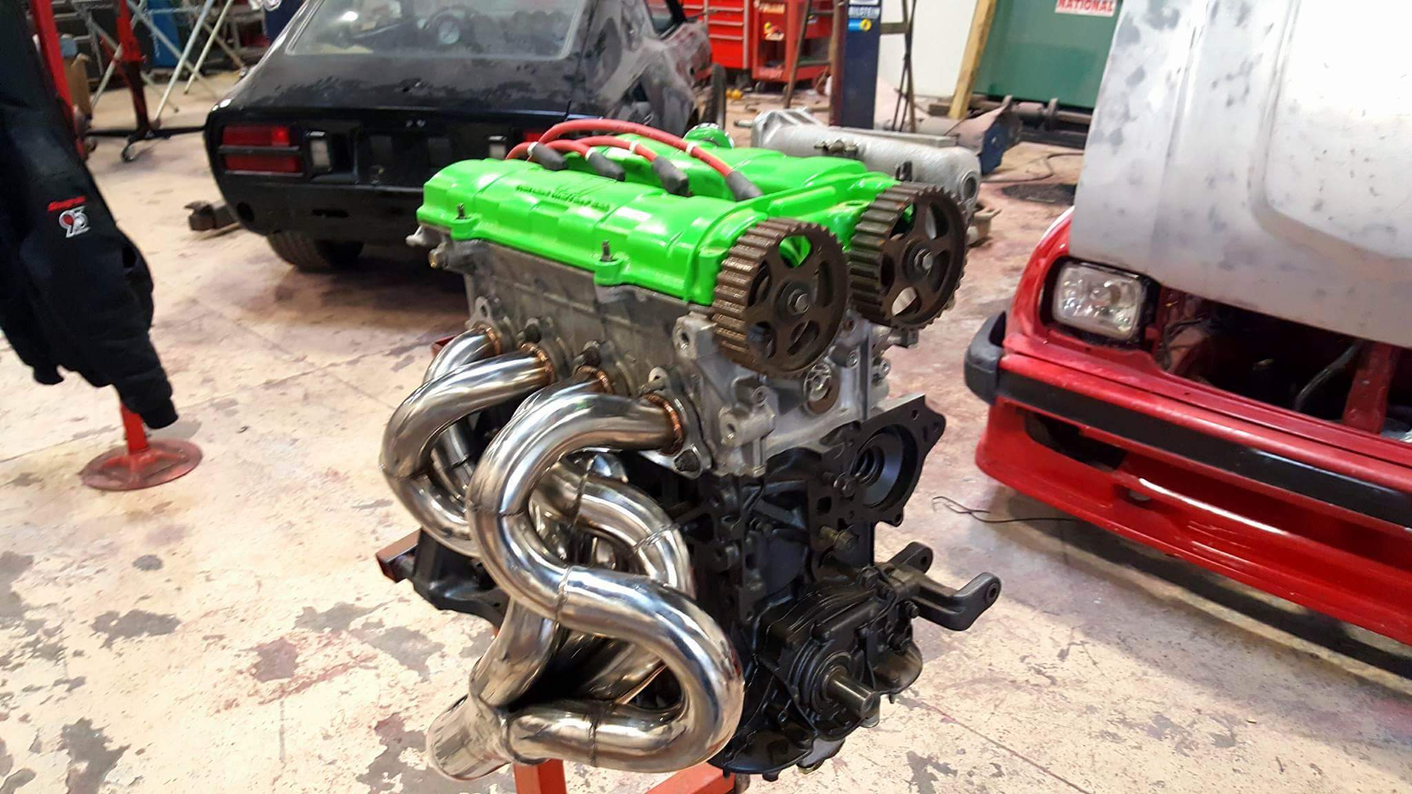

insert 84-87 dohc zc please and thank you then you can be gangster dual cam dseries like me
