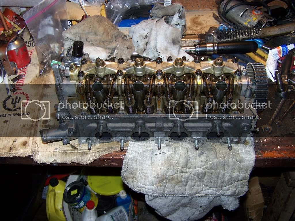

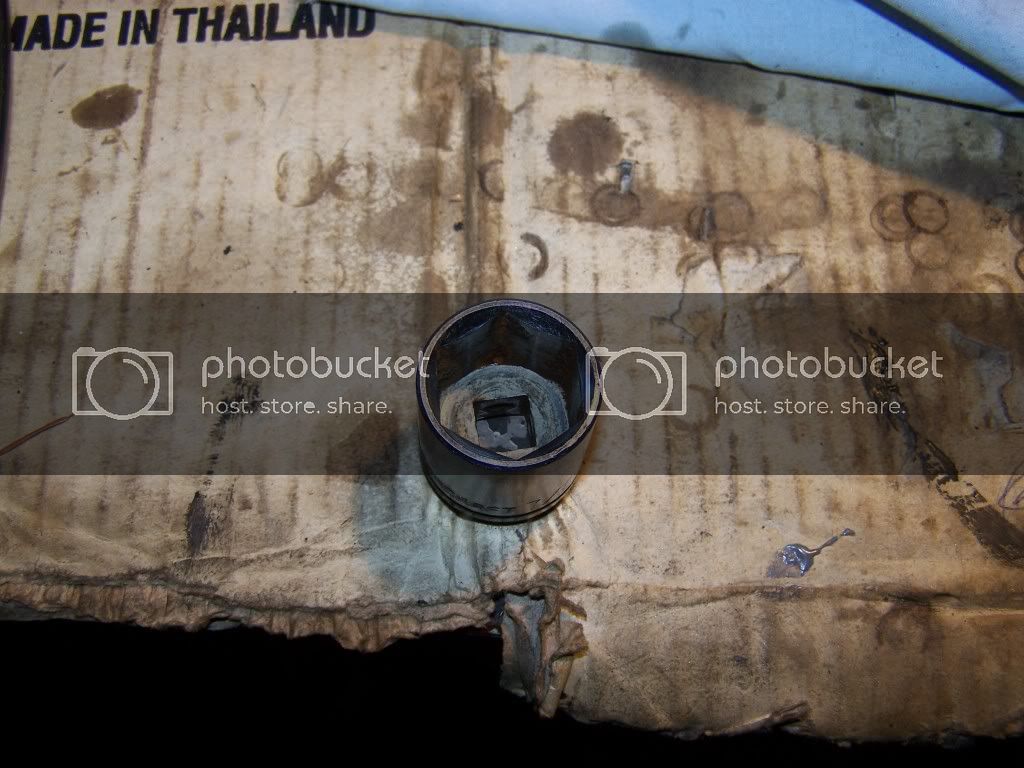

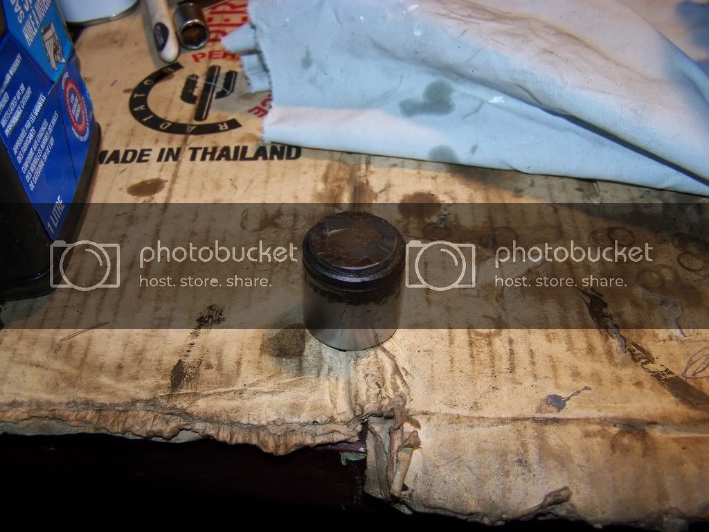

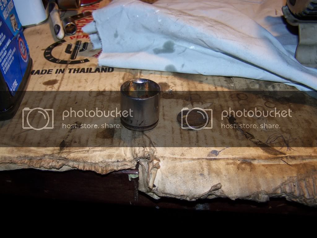

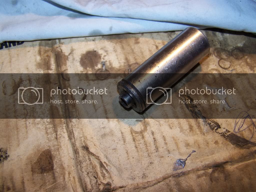

Ok. Tool no. 1.
7/8 short socket with a magnet on top. Put the socket over the valve spring and push down or hit it with a hammer. The keepers will go right into the socket.

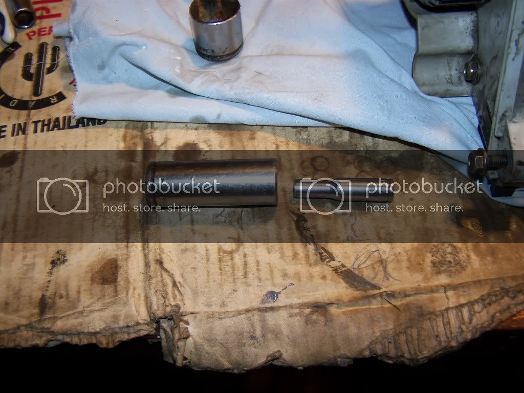

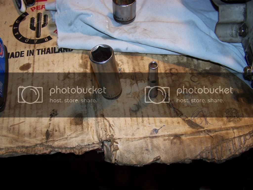

Tool no. 2.
17mm socket and 6mm socket. Both long.

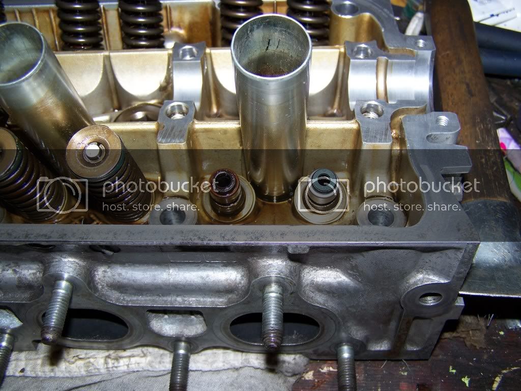

After your valve seal are in and your spring is back on, put the retainer and keepers in place. Then put sockets togther like this.
Make sure the 6mm socket is sticking out only about 1/8". Push down on the 17mm socket to compress the spring then the 6mm socket will put the keepers in place.

and then how do the seals come out and then go back in?

To put them back on you push it down til you hear the keepers click in. My hand way red by the end of all 16 but I did it for free.
I had to cut the seals off, they didn't come off with plyers, clean the stems then pop the new ones on. Watch some videos on Youtube.

now do you have pix of the seals so i can see if i took the right thing off lol
