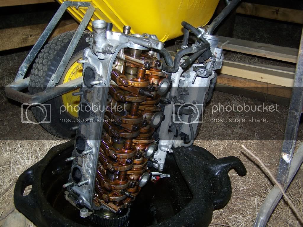

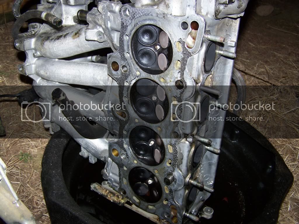

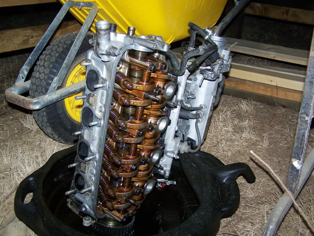

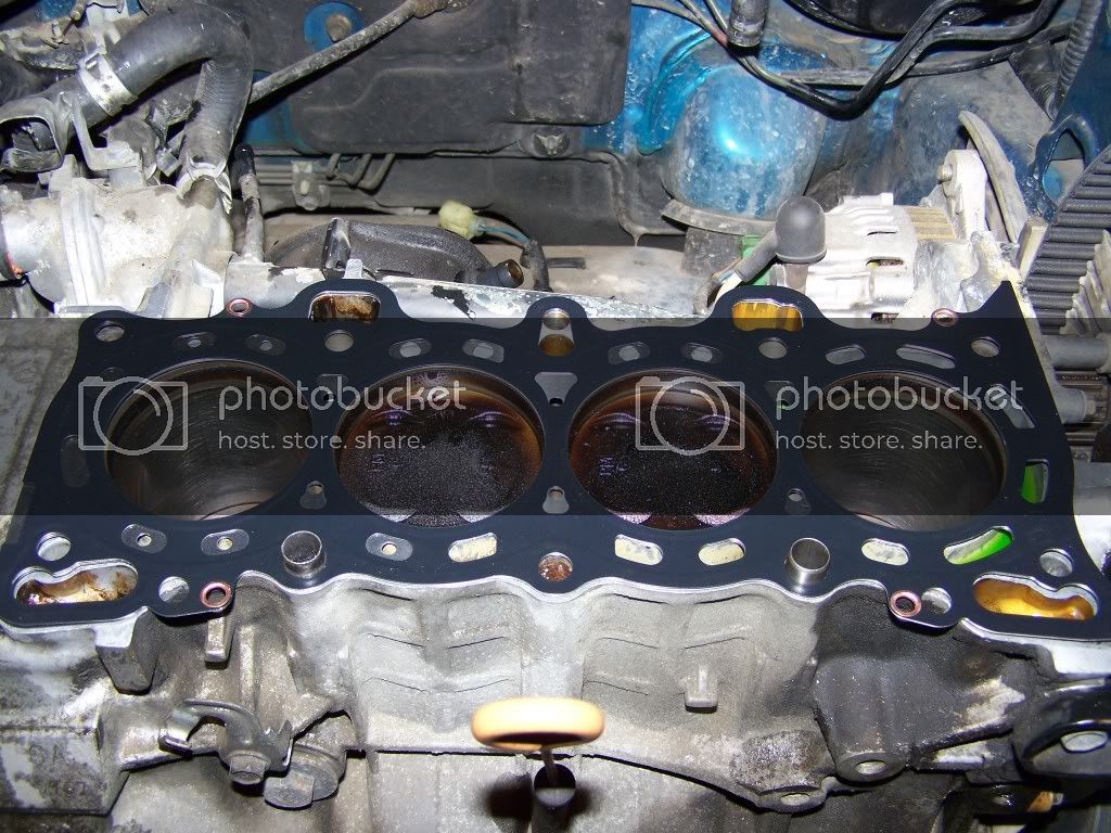

Fuck...Just took off the head but when I took off the timing belt it was super loose! Like the "mechanic" didn't touch the tensioner. Its a good thing I'm taking this apart right now but I'm now worried about my bottom end, the "mechanic" took it apart too. :ph34r: :(

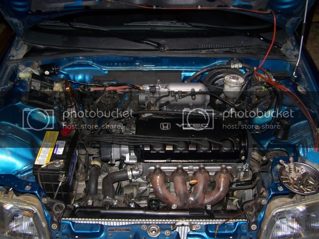

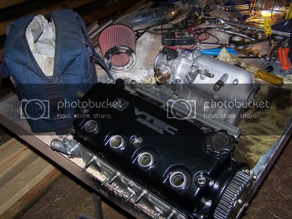

Notice I got rid of the fire-wall MAP. After this thing is running reliably I'm going to wrap the header.
And yes my bay is dirty, I heard Simple Green is good.

SHE'S ALIVE! Yay!

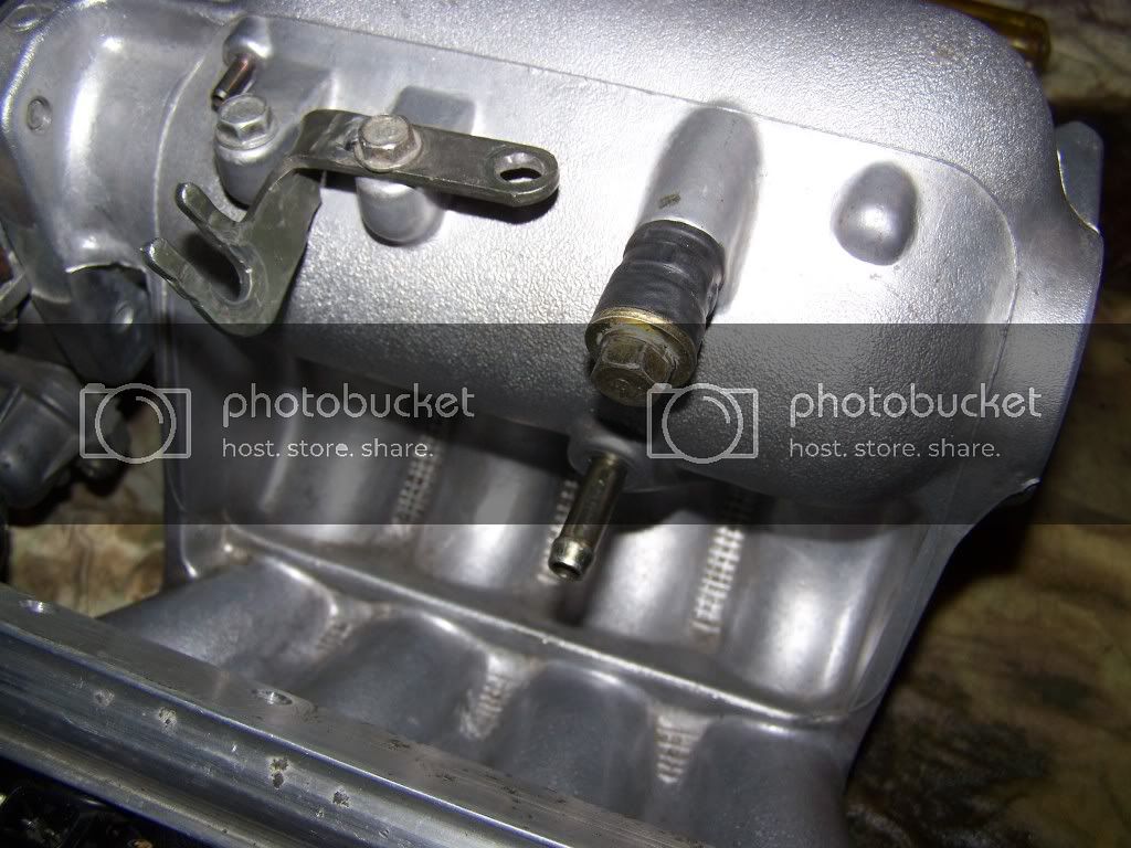

Timing was way off at first but I got that straightned out. After that it started right up. I didn't let it warm up because I still have to get a longer IACV hose. It also sounded like I had a vacuum leak still from my Y8 manifold but I'll get to that after I get some coolant in there and its actually ran for awhile.

So far I found:
A loose timing belt
A bolt missing from the water pump
Drivers motor mount was loose, all three bolts
Crank pulley bolt was loose
The damn thing was about to self-destruct.

Holy balls, almost sounds like it would be worth it to do a mild tear-down and check everything, whoever worked on it last was obviously a hack.
lol the mount.crank pulley bolt and loose timing belt would all be from him..he had to change the timing belt
wait//what timing belt did you use???
Z6, what I'm supposed to.
Yeah, I'm glad I took it apart but I'm worried about my bottom end, especially if I'm going to hit 7000 RPMs.
Yeah that and there is a new water pump in there so it all makes sence.
