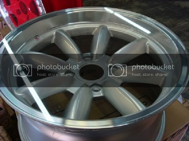

What do you guys think about these wheels? They'd go good with the blue and lowered. But still suspension first. And I know they're a copy of Sprint's. They're Rota Track R.

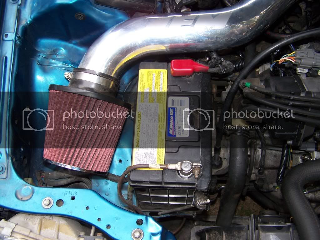

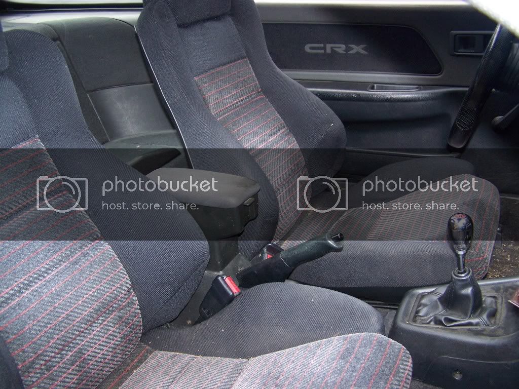

Installed the arm rest. And my battery kept moving around so I knew something was up. I took out the battery and found the plastic tray was upside down! It stays in place now and I straightned out the battery cables while I was at it.
