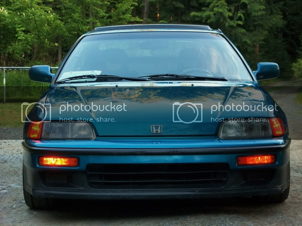

I'm having second thoughts on the headlights because I got to see them in the light of day today. But I'm happy with the amber lights... $8 vs. $60 for the set. :D

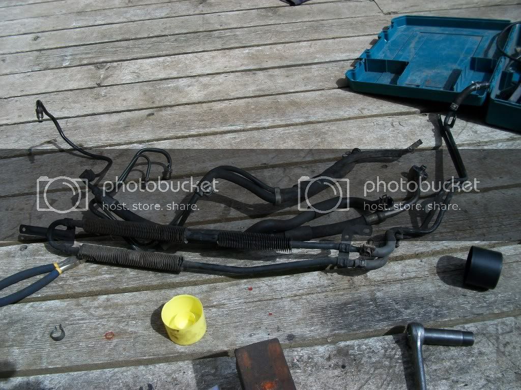

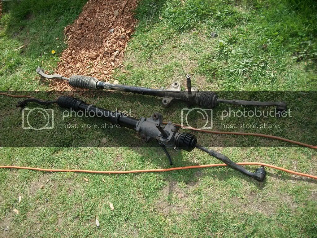

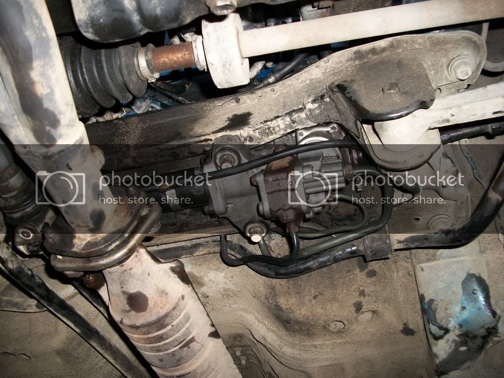

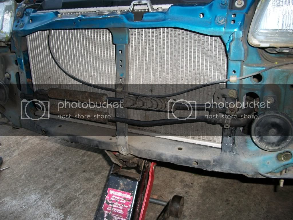

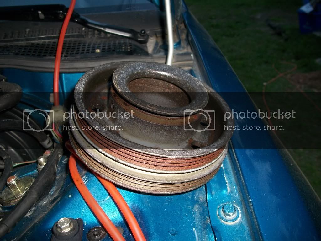

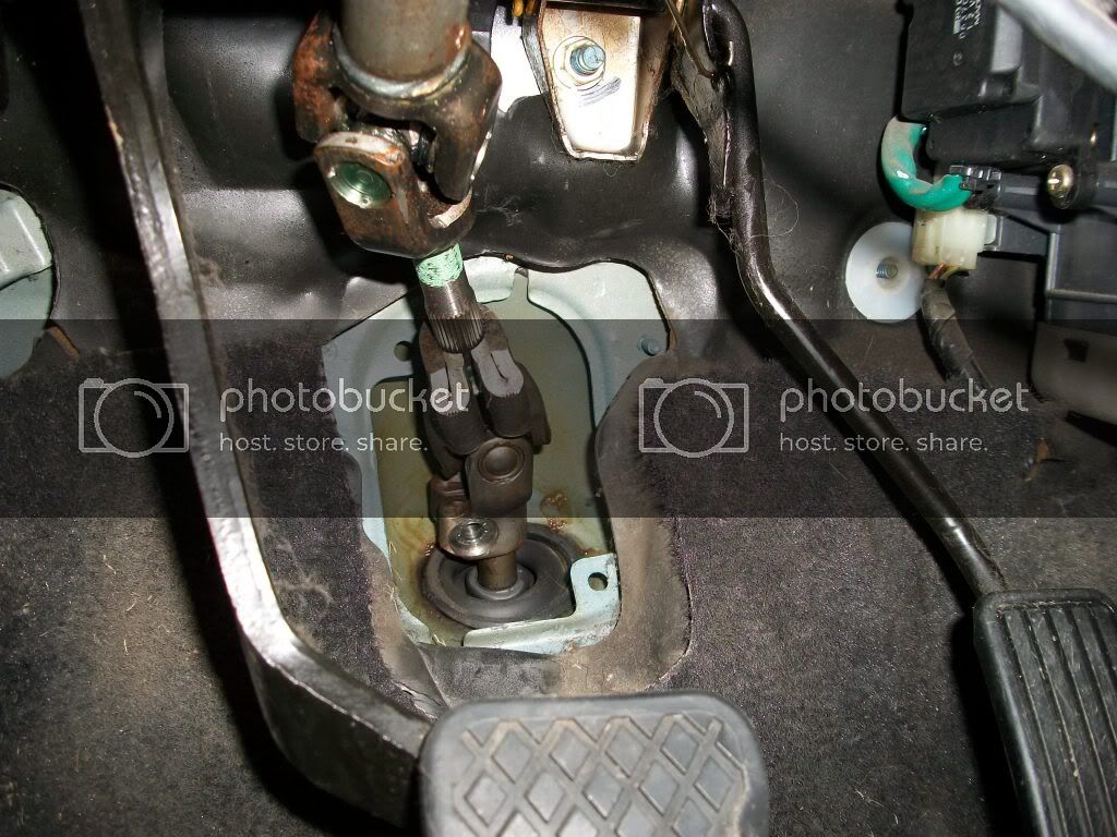

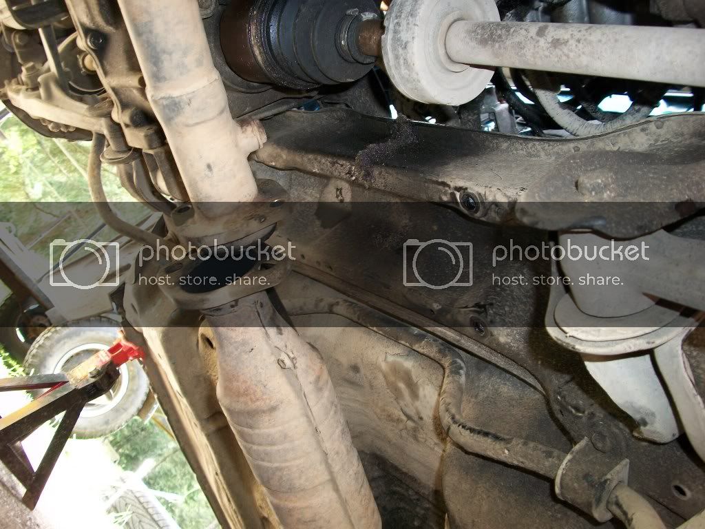

I installed power steering today. It came out of a 1989 hatch. Tomorrow I'll install the pulley with a new belt and new fluid and I'm done!
If I don't like it (which I probably won't) then its easy to put back. I want to get rid of some torque steer so I can handle the car better with one hand.
Well its all done now...and I got what I asked for. :D Its working great. I bombed around the block a couple of times but didn't want to take it on the highway because I still have the bumper off. For the whole hour I had it running I lost no fluid. :)
If I was smart I would have measured both racks while they were out then adjusted the new one to my new alignment. But I'm not smart. :( At least my alignment was free. I should get a camber kit then get it really aligned.
