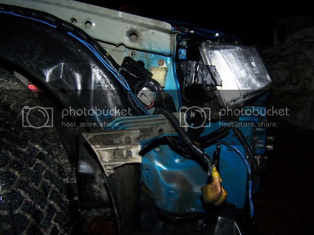

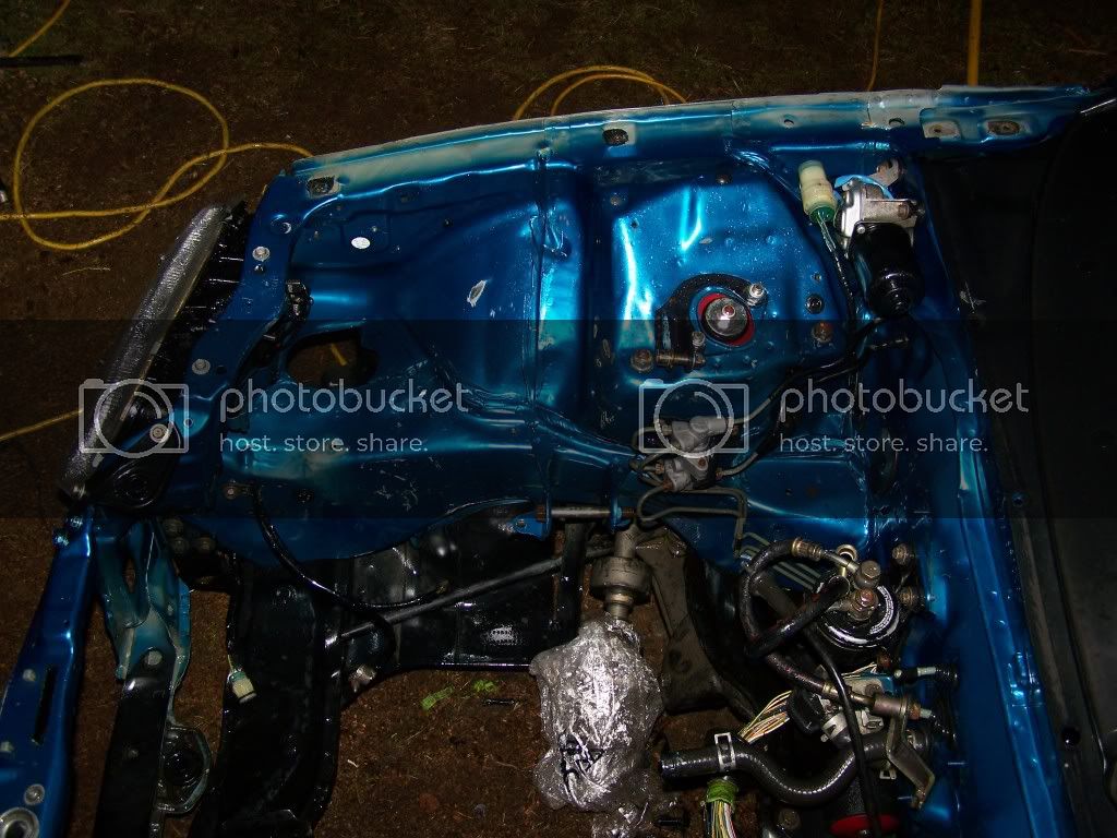

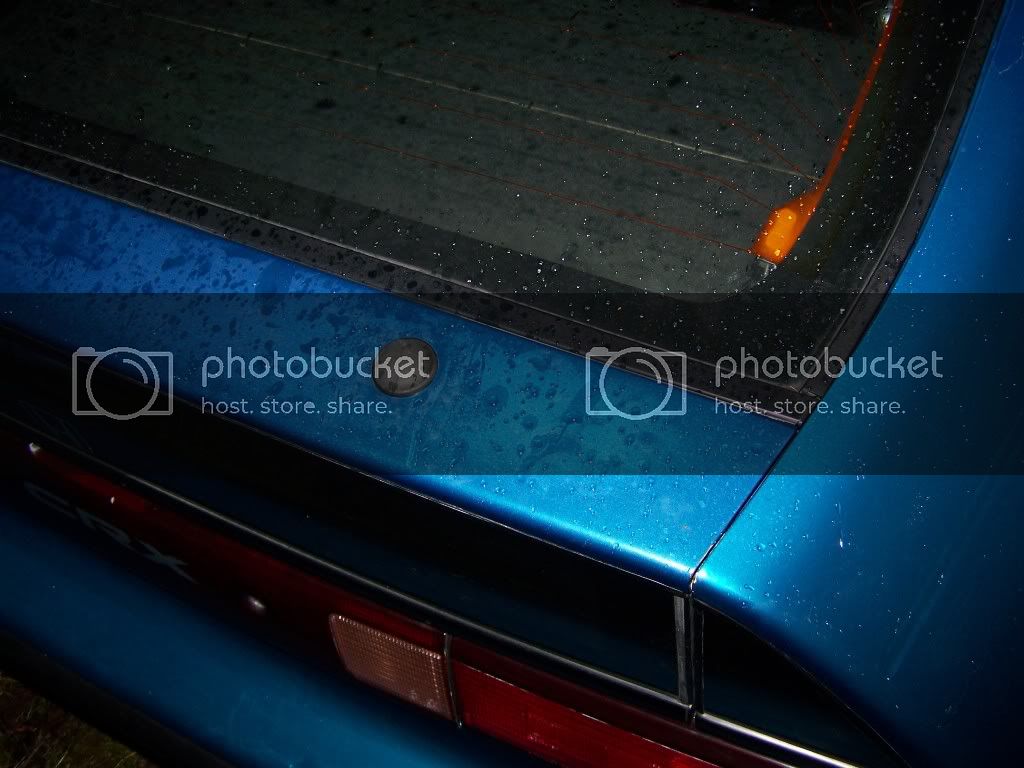

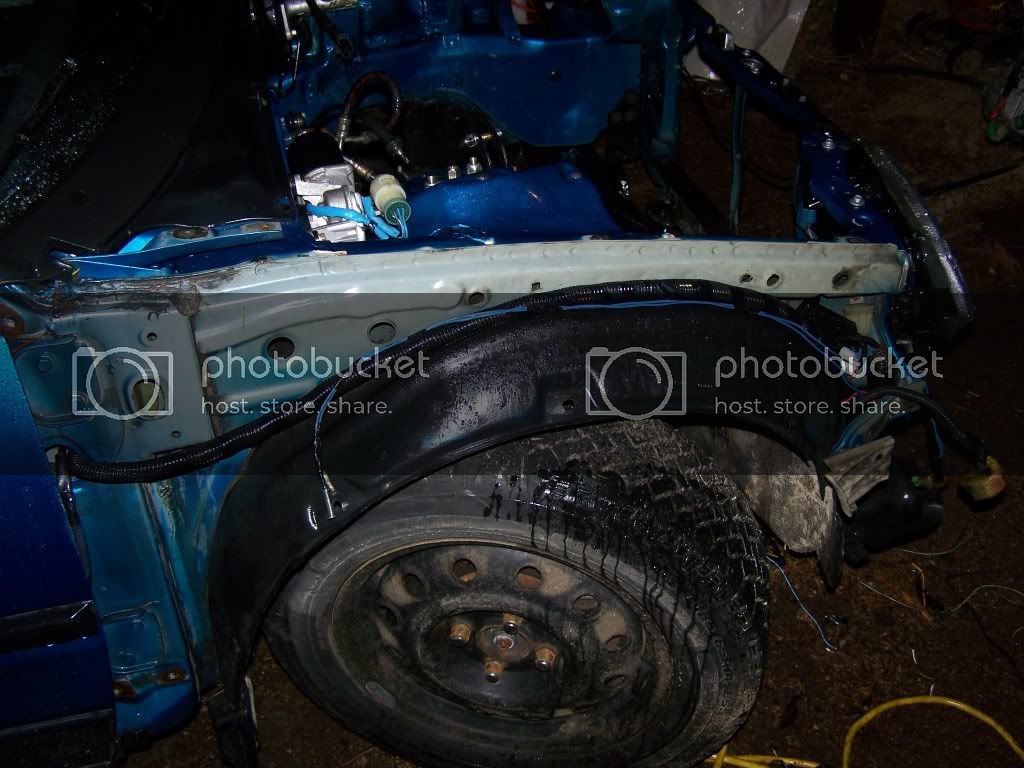

Billet cam seal taken from LS and insalled onto B16. Wire tuck done on passanger side. :) Put a battery in and eveything tested great. No camera to show work though. :( Also did a rear wiper delete. Just need to make an engine harness and put the motor in.

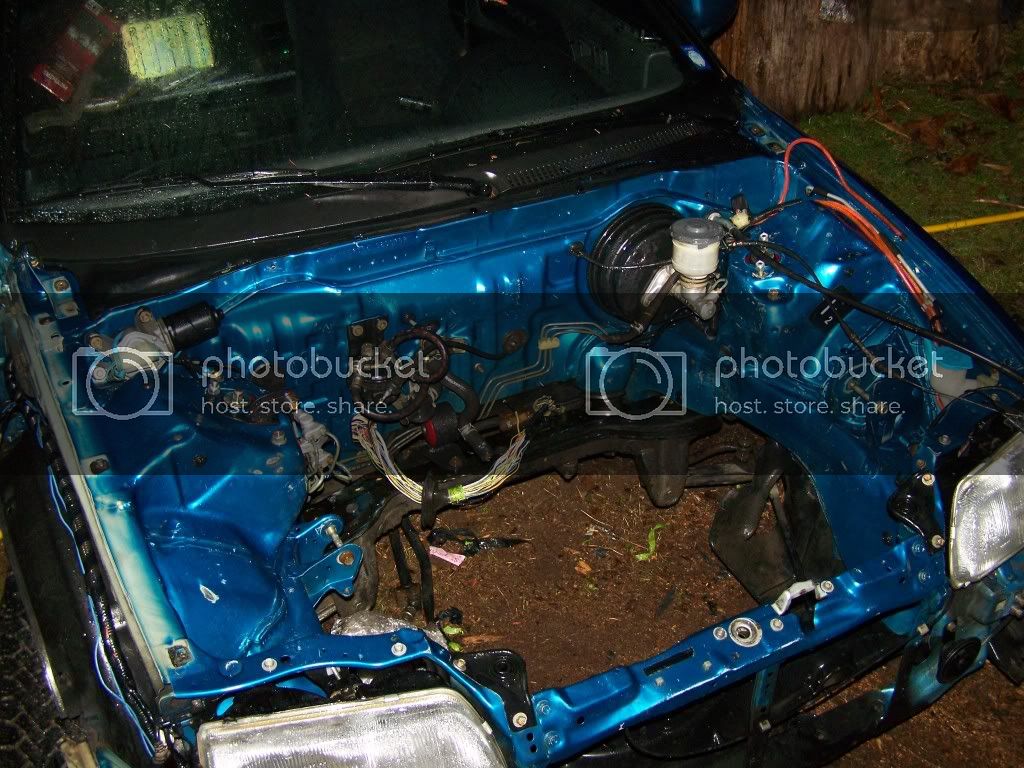

Got me some Simple Green, I'm gonna go over the bay with a toothbrush now. :D
Haha I like the sounds of that. I just did the first once-over in the dark. Probably go over it again tomorrow.

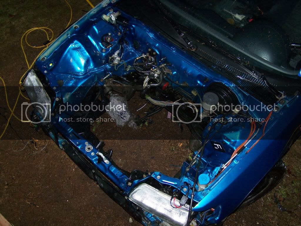

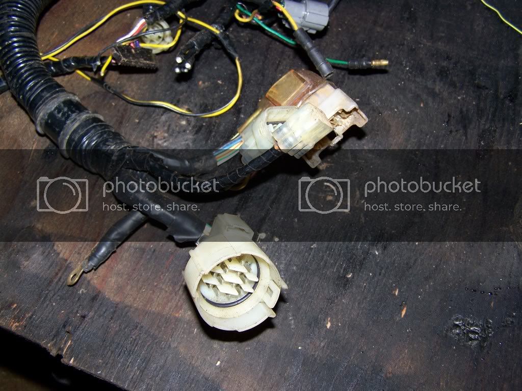

I located my spare (and partially cut up) Si engine harness but it has everything I need to make my B16 engine harness. :) Got started on the fuse box relocate too, just need a couple wires for it. Then I'll grab my chipped P28 back from my dad and the 4 wire O2 sensor.

Rear wiper delete.

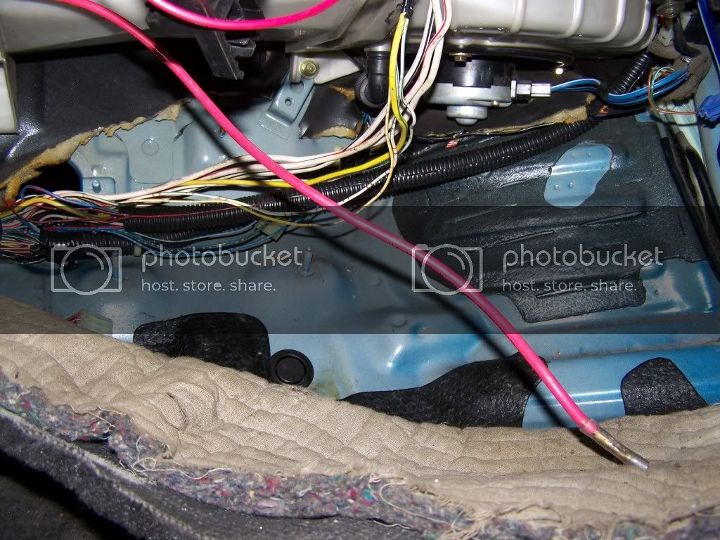

The plugs I need off the Si harness.
The grounds and HID ballast tucked in there.
All wrapped up.
Passanger footwell.
First bay claning.
Cam seal installed.
