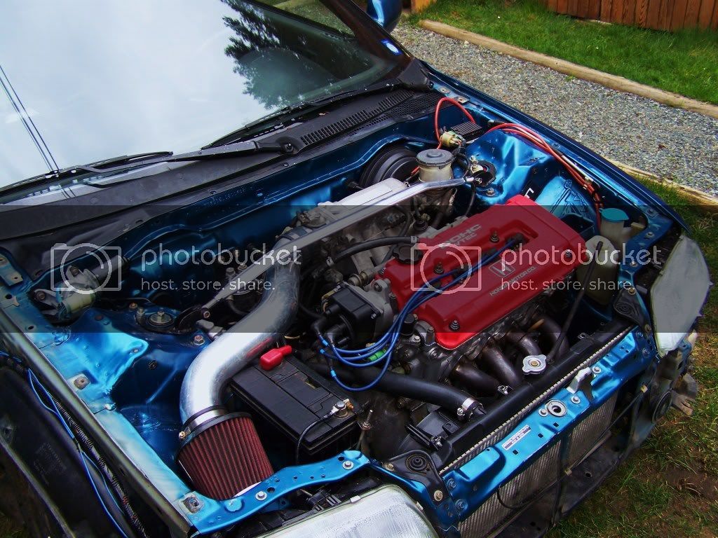

All wiring done...body wiring, engine wiring, fuse box wiring, ECU wiring. And I replaced the broken TPS (came like that from shipping :()
It's going in tonight. Updates later.

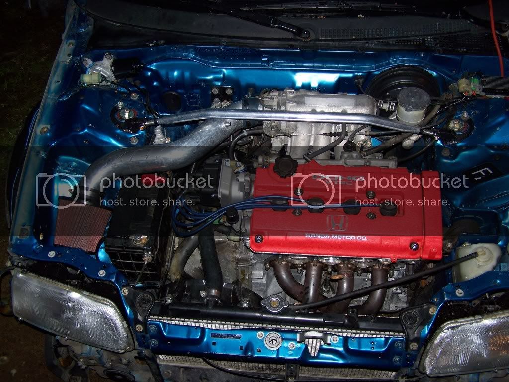

Did ya clean the motor up a little? The last pics I remember seeing, the block and tranny looked pretty nasty. Red valve cover looked nice.
Yep, cleaned up a LOT.
Its all in and RUNNING !!! Started up fairly nicely, runs super smooth but a little bit of a tick and code 9 CYP and hesitates to rev up. I will take apart the wiring and check it out tomorrow. For tonight I'm done.
So the rad has been connected and it's been run up to temperature. The tick turned out to be a bad timing belt tensioner so a whole timing belt job next. Did a compression test 235 all across . No temp reading in the gauges though, just says cold even though its fully circulating. And I forgot to calibrate the TPS sensor ! :shocked: ...the joy of working out bugs.

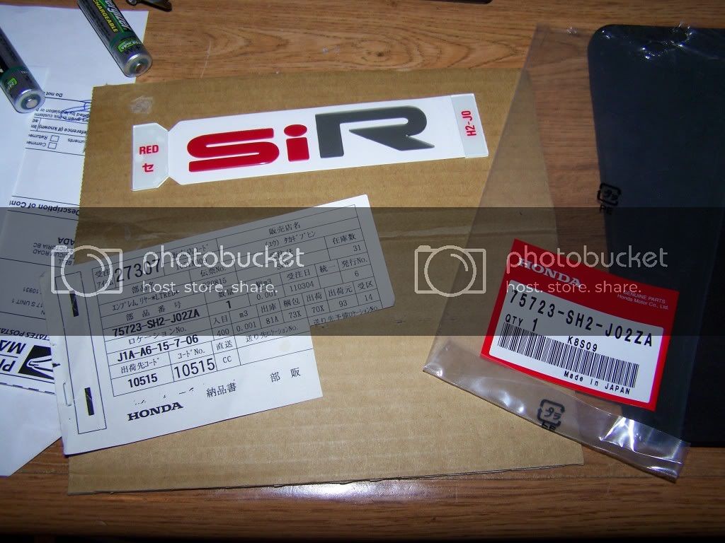

Looks great. I hope to get there some day too. I think I've got a little while to go though. Damn do those washer fluid tubes stick out! Also, why do you have a sticker with a diatomic Fluorine molecule on it? Are you running the battery to the back?

Yeah I should tuck those tubes. Sticker is my suspension like Si said. I don't know if I want to tuck the battery anymore, it's not really needed. Maybe later if I really want to.

After trying 3 TPS sensors I got one that worked and it's not hesitating anymore. :) Still have code 9 and no temperature reading. But the motor is running better and better so as soon as those issues are worked out I can tell its going to be a great motor.
