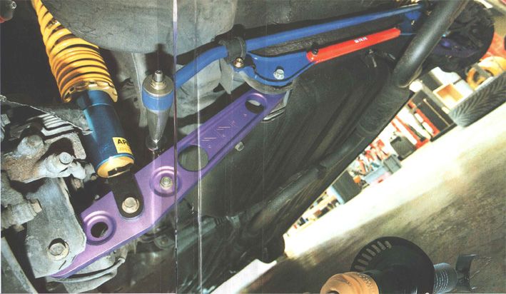

ya, so you can or cant put a sway bar on non vtec models? without itr lca.
Yep, but if you want a oem one you still ned to swap LCA's. Any 92 up Integra, VTEC Sol, or 99-00 Civic Si ones will work. There are even a couple aftermarket ones available (lighter) now. There are aftermarket Swaybar setups that do not need new LCA's.
as far as aftermarket ones...you mean the purple lca?
