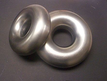

I had to buy one of these in 3" to make the downpipe in my ED7 hatchie fit right. Ended up using the two 180* mandrels I bought in trade for other parts... What a waste, but they just wouldn't fit.
where did you buy them??? and what was the problem .....
Quoted post[/post]]
The crossmember was too close to the outlet of the turbo for a standard bend pipe, so we had to find the smallest bend possible... that's a donut.
It BARELY squeaked in, had MAYBE 1/4" clearance at the bottom of the DB to the crossmember.
But OH MAN, it looked and worked SWEET.
