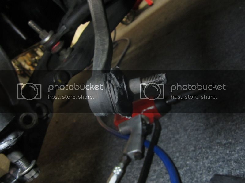

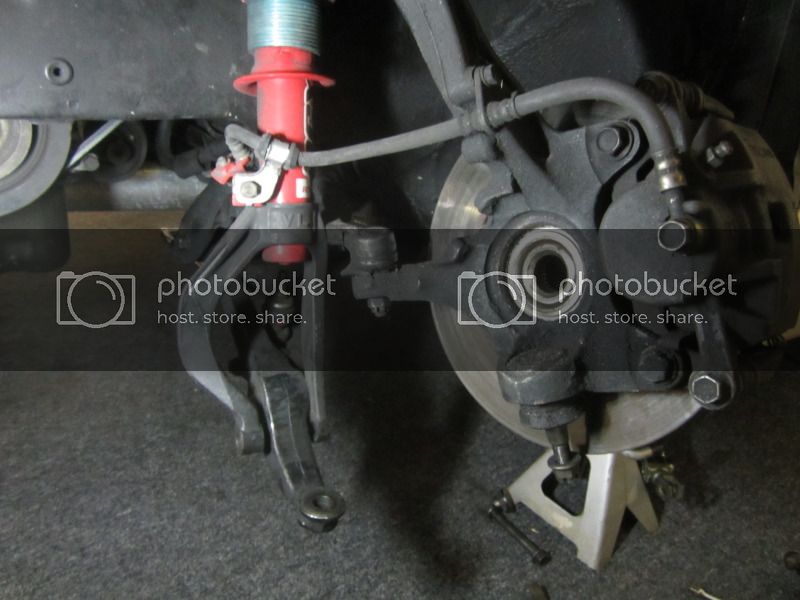

Some pics so you guys can see what ive been riding around on lol

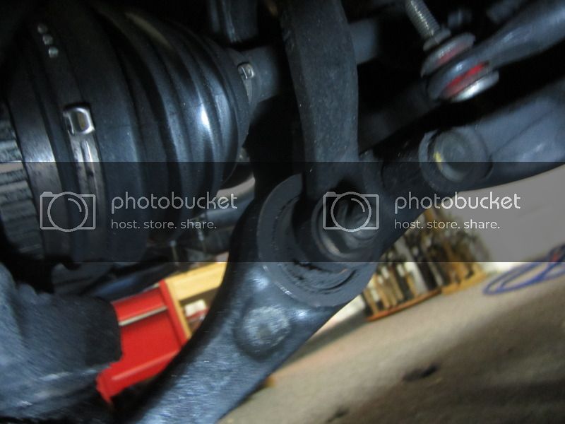

Here Im starting to make some progress, getting stuff apart...

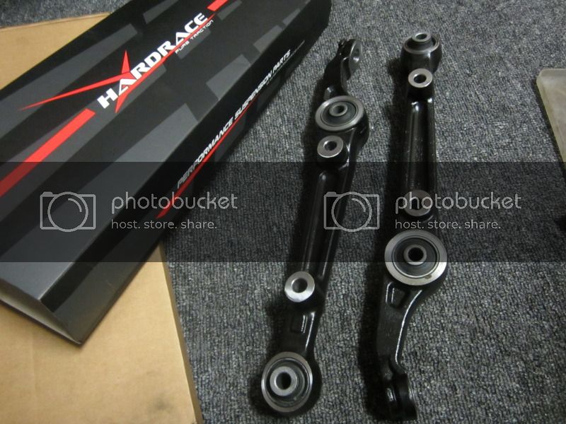

check out these pretty new LCAs about to get installed :)
