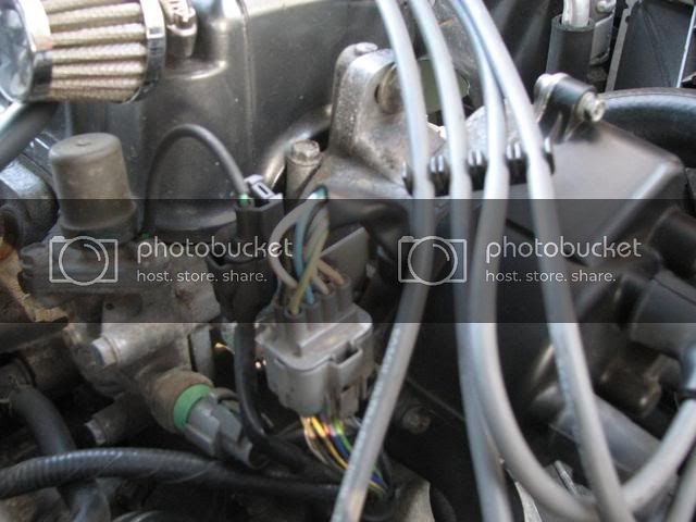

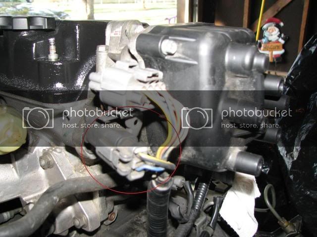

    ok now on the b18c distributor there are two plugs, and when i use the ex harness there is only one plug up at the distributor, what do i do with the extra plug? The one i am talking about is longer and more rectangular and only has two wires going to and from it.

    Well it sounds like the motor you bought is obd-1, and yours is obd-2b. It's not going to be plug and play. You really need to find out what year your engine/ecu is before continuing. Your options are to:
    A. Buy a 99-00 si dizzy and it will plug right in
    B. Hard wire each wire on the dizzy to the correct pins on the ecu
    C. Get an obd-1 engine harness then buy a obd1-2 jumper harness.
    This is all assuming your engine is obd-1 (94-95). From what I have heard, some harness plugs are the same on obd1 and obd2, while some are different.
