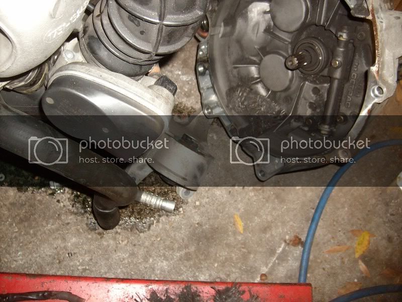

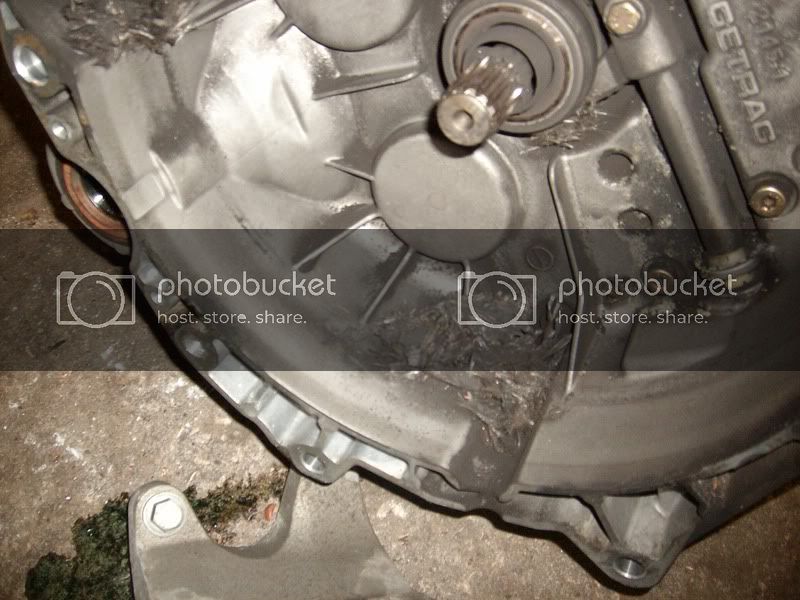

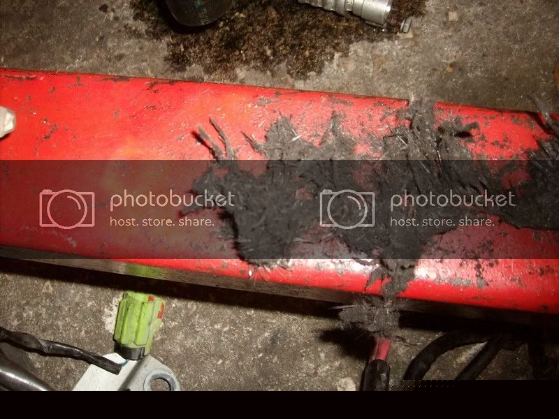

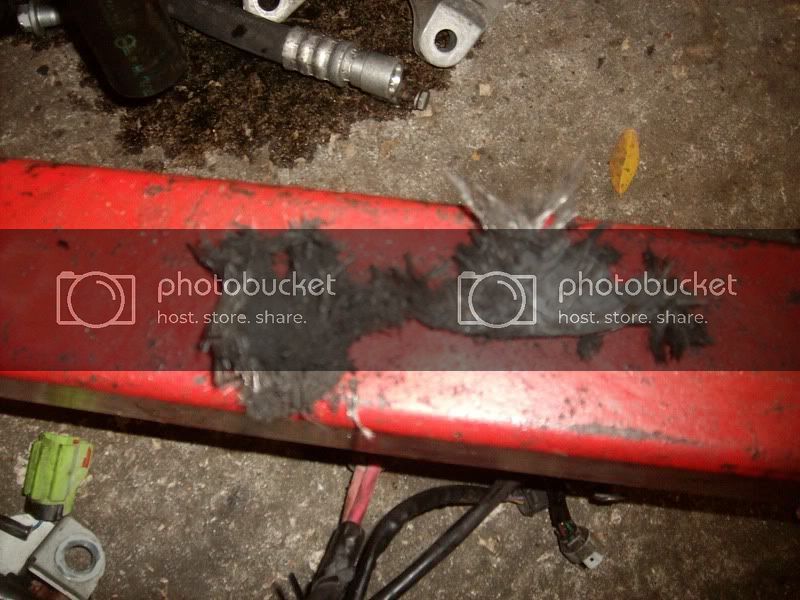

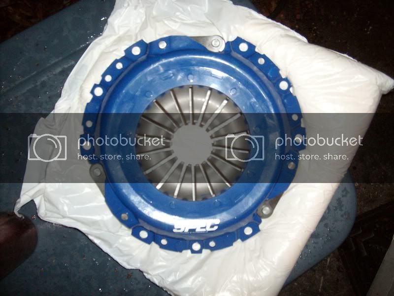

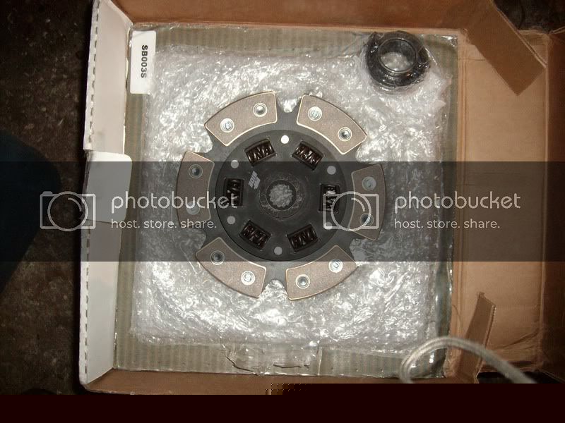

  17. 94H_Ex
    94H_Ex Under employed
    1,453
    33
    Jun 17, 2008
    Florida

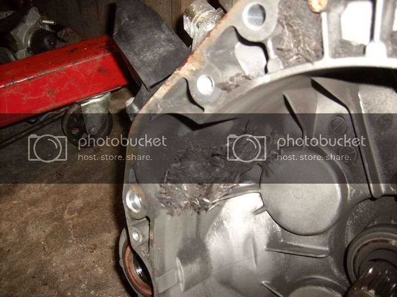

    So of course I was right. the clutch is bad, and heres some pics.
    This is what i collected around where the starter is located.
    Heres the new clutch he wants in it.
    I ll load a vid some time soon

  19. 94H_Ex
    1,453
    33
    Jun 17, 2008
    Florida
    Well, now im just f'cking aggravated with Mini. I got the old clutch out and i went to go check clearance on the flywheel for the new one. and guess f'cking what. The clutch doesnt make contact with the flywheel. why? because the f'ing fly wheel bolt heads are sticking too far up and they make contact with the clutch, instead of the flywheel surface. wtf.. So now he's either got to scrap the money up for a new flywheel, or I have to break ass to try to find some type of f'ing bolts and can tourqe on, and are low pro so they dont touch the clutch... I will never work on another mini. ever, High grade BMW enginering my ass. Honda has always went out and made more sense then Mini. At least my after market clutches will fit on my stock flywheels.
    Mini can blow it out their ass.
    /rant.
  20. hosmer
    3,160
    83
    Jan 26, 2005
    B R I D G E W A T E R
    maybe thats why the old one blew apart?....I know a couple people who've specifically used *that* brand clutch (Spec) on a stock flywheel with no issues
    are they loose?
    -theres a TSB on the early Minis flywheels BTW
