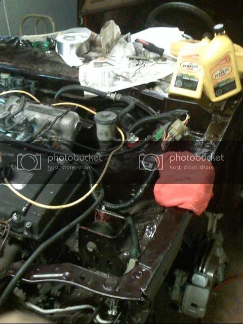

heres a pic of the MC installed
DRAINED the old "DEATH" black oil and put fresh oil.
Also did the brakes, bleed them all.

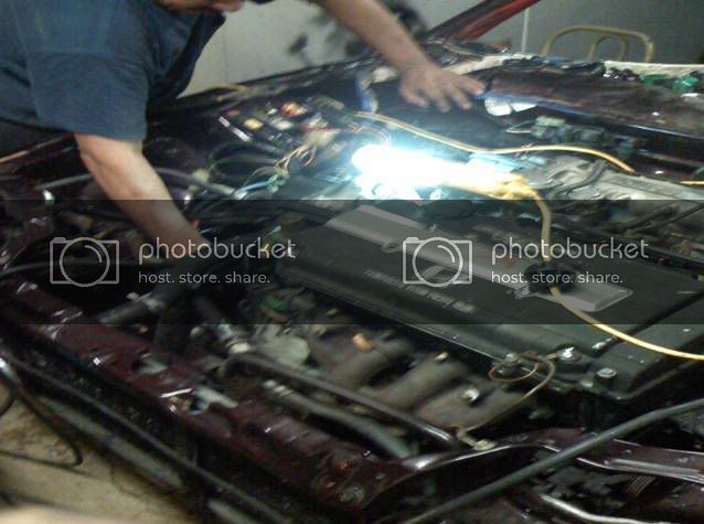

my dad doing some last minute adjustments for the cooling lines.
Since we didn't have the Del Sol rad hoses on hand. We used the metal zip ties with the bolt that tightens the strap...you know what i'm talking about just can't think of the name of the thing.

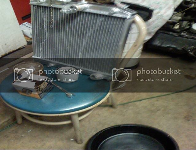

And here is the Rad
here it is installed and being filled up with antifreeze
I'm really concearned if the Rad is gonna have any issues with the hood. I haven't put the hood on yet but I want to make sure that there will not be any CLEARANCE ISSUES!!!

that rad does look kinda high...

I also found out that the radiator that I bought was for a 94 Del-Sol and won't fit into the engine bay.
I have seen alot of other guys post pics of their swaps and used a slim radiator which looks OEM but wanted to know what car that radiator is off of?
A 99 Civic Si, 93 ITR? Any help with this would help me finish my project!!!
Slim? You mean half-width? That's the 92-95 Civic radiator, and the high capacity one is the one from the del Sol VTEC. It's a dual-core half-width that copes very well with high heat loads.

but I would say use either the 92-95 one, unless your using a small turbo, then your stock one should fit
