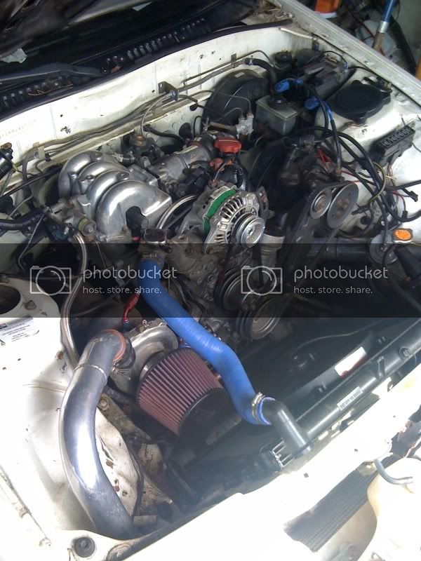

    I bought this car about 4 months ago and have been putting it together, finishing up the engine and moving onto suspension, exterior, ect in the near future
    1991 Mazda RX7 Turbo II (original tII, not a conversion)
    86k on this chassis
    Engine:
    S4 13b block
    S5 manifolds/accessories/sensors
    Streetport
    3mm Apex seals
    Racing Beat top mount manifold
    Greddy compression tube
    Precision SC61 ball bearing turbo
    Tial 44mm ext wastegate
    Tial BOV
    Godspeed front mount w/custom piping
    RC Engineering 1200cc primary and secondary injectors
    Management/Electronics:

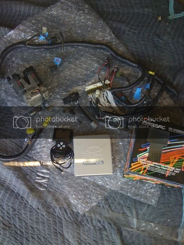

    FD3S Apexi Power FC w/hand commander
    Banzai patch harness for the FC3S
    GM 3 bar MAP
    Simplified engine harness (11 plugs total in the engine bay including the 4 for the injectors)
    PLX SM-AFR wideband
    Blitz boost gauge
    Autometer oil pressure gauge
    Installing the Power FC and injectors
    Put back together

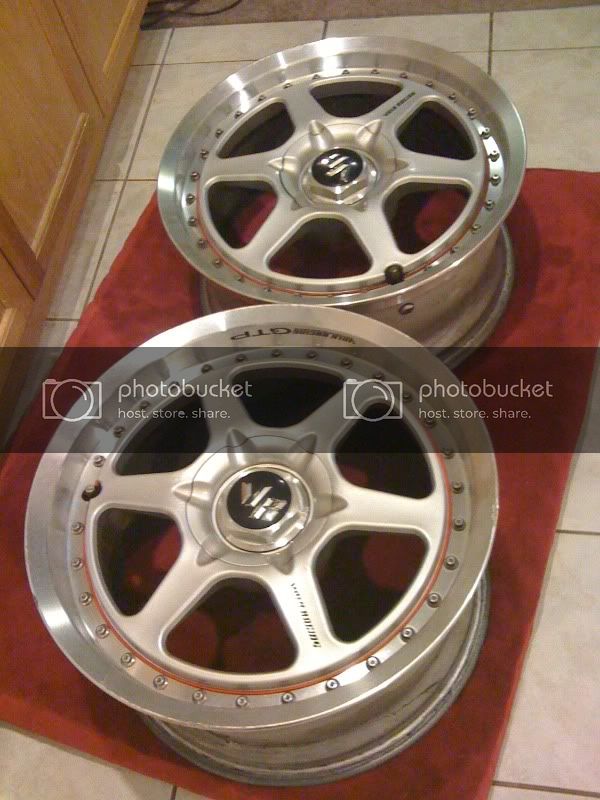

    When I get it back, next purchase is tires for the wheels I picked up for it.
    17x8, 17x9 Volk GTP's..offset should be decent for a flush fit

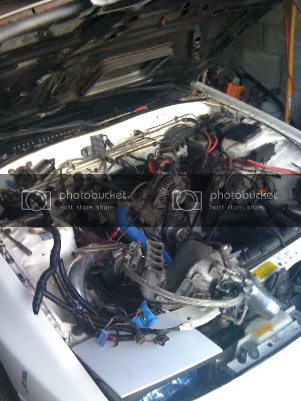

    So it went in and all we could do is load a (custom made by Chris@Banzai in IN) base map to get it to start and idle...cuz it was only running on 1 rotor :mad:
    Well I traced that out to a faulty injector plug. The wire had broken inside the insulation about 2 inches from the plug...how the fuck that happened is beyond me but whatever, it was only 3 hours of my life with a stupid multimeter and testing injectors/rails/ect OFF THE MOTOR (the injectors are a bitch to get at on the motors, they're under the intake)
    I'm still getting this weird issue where the car breaks up sometimes at anything over 25% throttle, I THINK its the TPS but who the hell knows. I rang out both side (has 2 sensors, a wide range and a narrow) and 1 side came back .3 ohms over spec (5.4 instead of a 5.1 max)...so maybe, we'll see when I find another one to swap in there
    When it does run correctly its scary fast...so heres this for now:
    YouTube - Modified 1991 Mazda RX7 Turbo II SC61 BB idle
    -It shuts off after I rev it the 2nd time because I need to adjust a bleeder...I took the 2 stage fuel pump system out (resistor that cuts voltage to the pump at idle/cruising) and wired in a relay to get 12 volts all the time to the pump...the 1200's kind of need it
