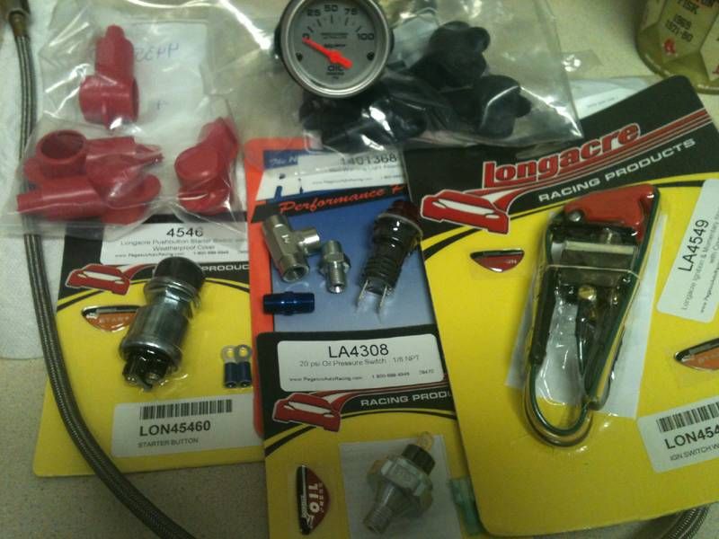

I bought a bunch of wire today and other cool parts from skycraft which has everything you could ever want....wiring, switches, hoses etc. I also got my pegasus order in
ignition switch, push start, low oil psi sensor with red dummy light, fittings 1/8bsp to 1/8npt for the block, 1/8 tee, braided line, additional oil psi gauge. I also bought about 16 feet of 4g wire as well as 8g wire.
