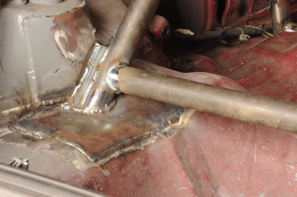

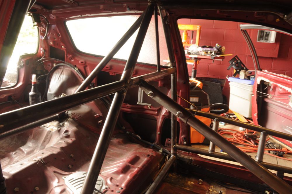

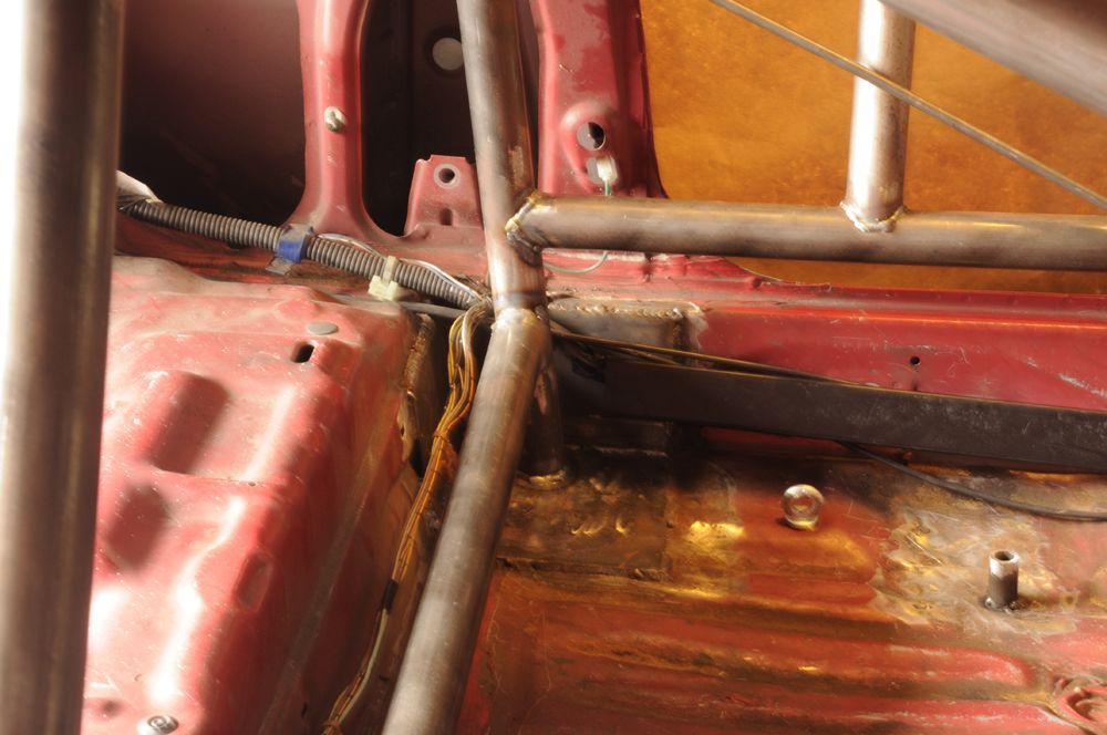

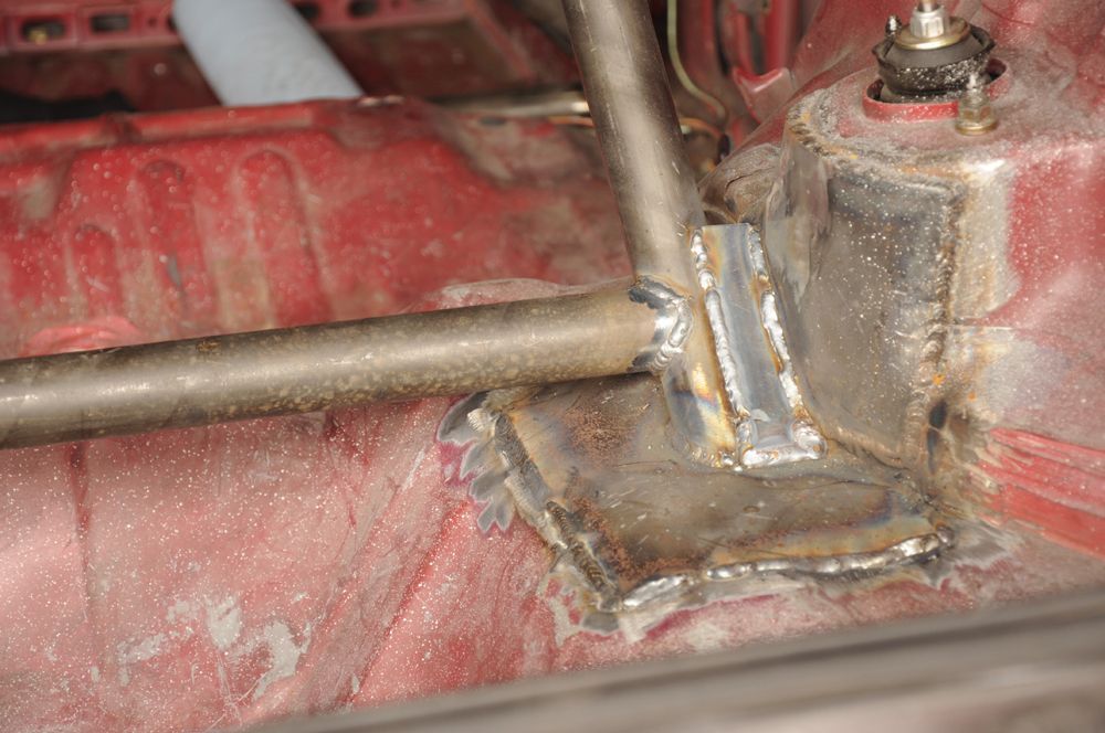

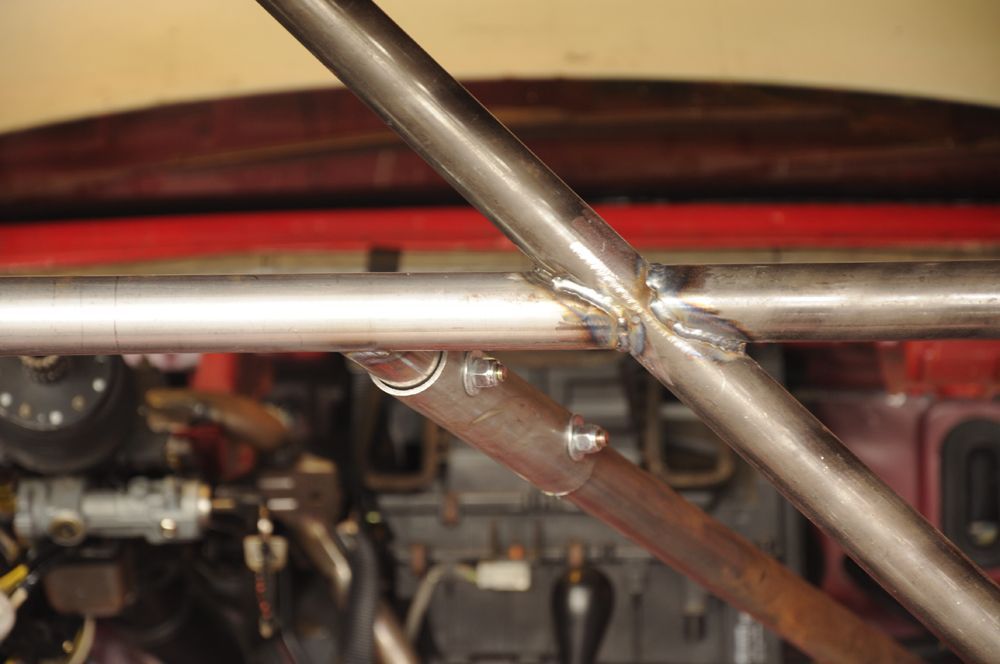

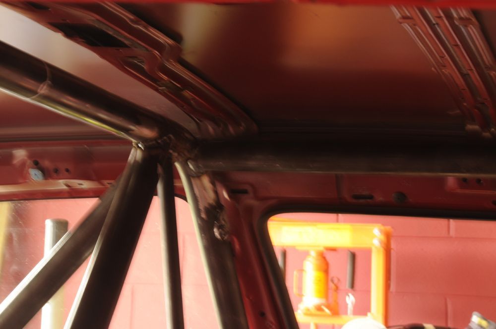

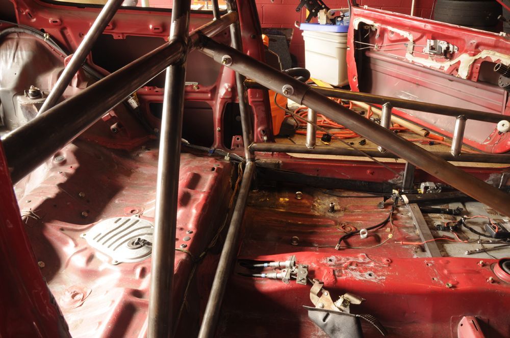

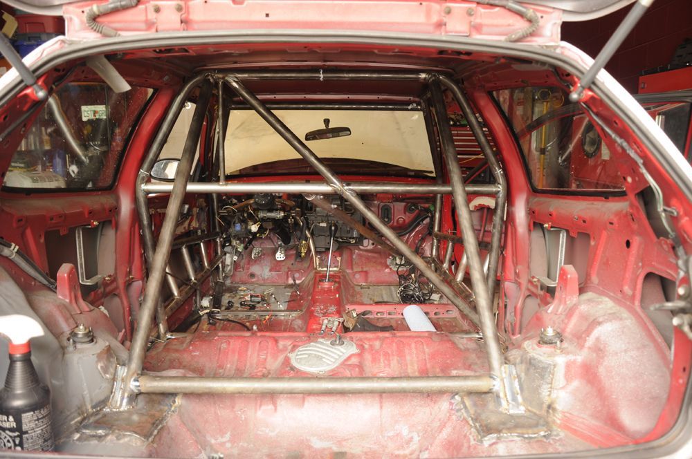

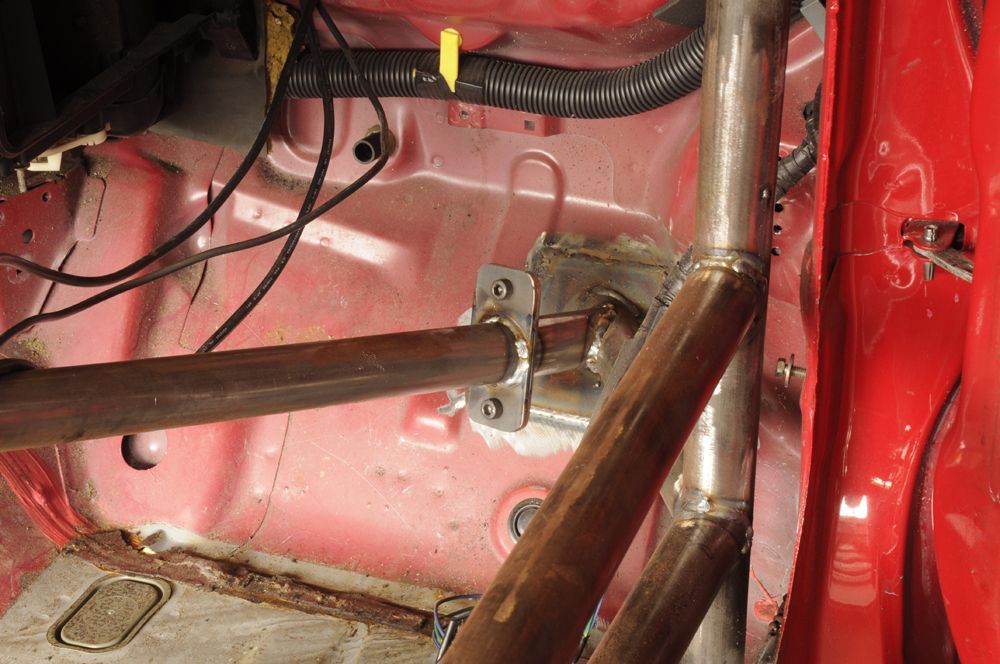

Roll cage shots. Sorry a few didnt come out so hot and I was trying to get a lot done so I didnt get a lot. I will get more after I paint it.

No I paid to have it done. I actually need to go back and have a triangulation done meeting at the petty bar from the rear shock towers. That could have been what gsrcrx was talking about.
