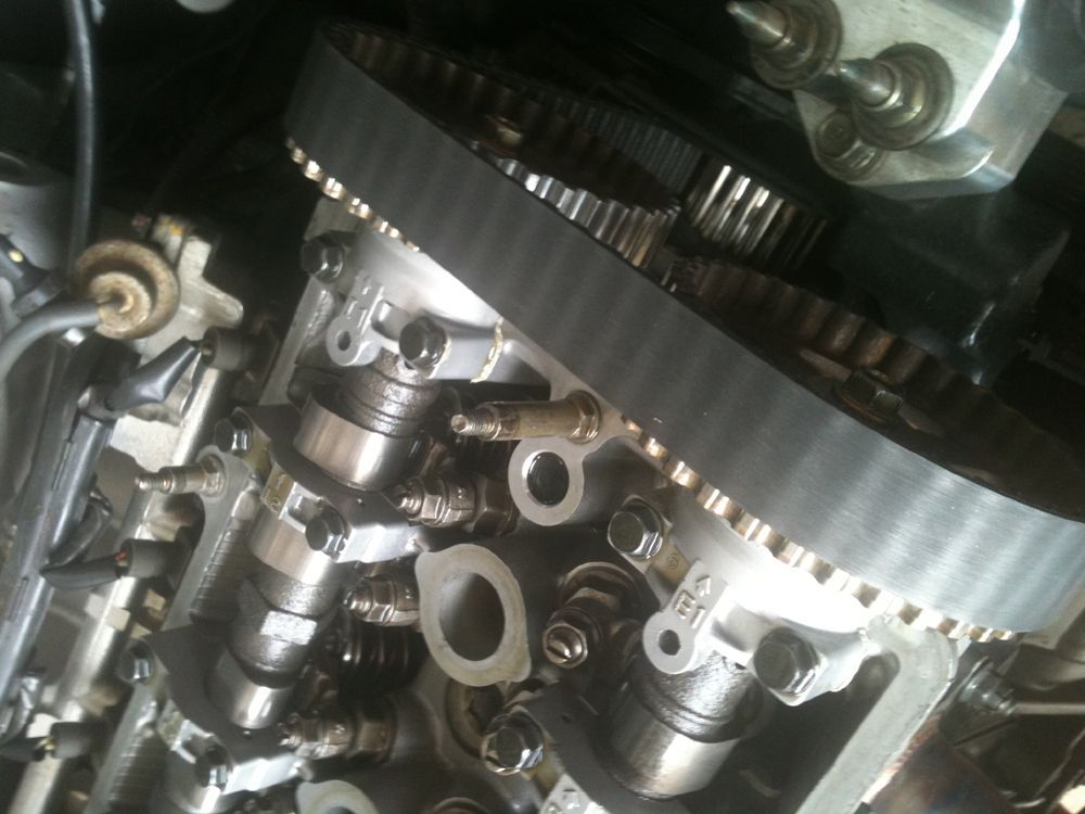

So I got to taking it apart today to put in the new water pump and timing belt.
Pretty lucky, barely hanging on.

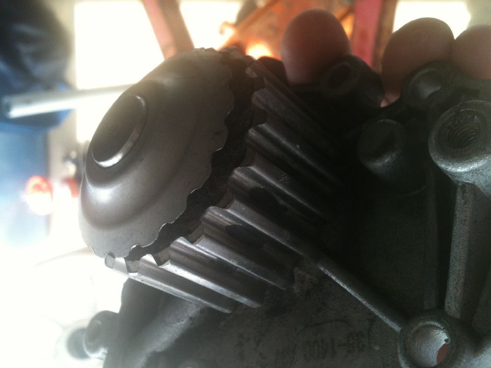

Ahh wtf thats not supposed to happen. I have never seen this type of failure.
I checked the valvetrain and everything looks intact and really clean so thats good. Im going to see if I can get it all back together today. I hate doing the timing belt, major pita to get tension right etc at least to my liking.
Woooooow to that water pump. WTF. I have changed dozens of those little Honda pumps and never seen any indication of that even beginning to happen. Yikes.
Sucks to hear about the water pump.....and the one session with over heating.
