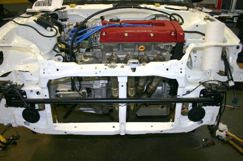

    If you're also into more custom stuff like that while you're welding anyway. Consider fabbing up replacement bumpers for your car (the real ones, not the plastic covers). The generally rust out and provide very little real assistance in wrecks (we drive 20-16 yr old cars man). Lemme see if I can find an example picture of one.. it's on Larry Widmer's personal FOURTH GEN BABY:

  10. Exodus
    Exodus Junior Member
    137
    Jan 5, 2006
    Dayton, OH
