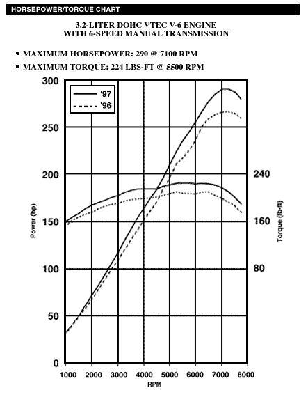

People really misunderstand VTEC and the difference between power and torque.
The first misunderstood fact is that acceleration is a function of torque at the wheels, which is engine torque times gearing, less any drivetrain losses. Not horsepower per se (but see more below).
The second misunderstood fact is that variable valve timing does not increase torque (or, as a result, acceleration) at higher revs. Its objective is to prevent torque from dropping as revs increase. When you look at the torque curve for a VTEC car like the NSX:
you can see that it's quite flat from roughly 3500 RPM to about 7500 RPM, and there is no huge increase above the VTEC crossover point of 5800 RPM. If it didn't have VTEC, you would see the torque drop rapidly as revs rose above that point.
The advantage of a wider, flat torque curve like this is in gearing. Cars without VTEC would be forced to upshift by around 6000 to 6500 RPM for optimal acceleration, and when they upshift, they lose acceleration because of the loss in gearing. This is why VTEC cars are so much faster than their torque numbers would imply - because they gain an acceleration advantage from their ability to stay in a lower gear before upshifting.
If you would like a more lengthy explanation, including how horsepower numbers reflect this, read this excellent article about the difference between torque and horsepower, and how gearing comes into play.
Another informative website, that explains how Honda's VTEC system works, is here, with links to similar topics on that site.
