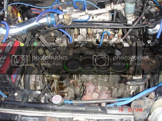

Dude, you need to pull the head and fix your leaky headgasket, pronto. The coolant probably won't hydrolock the engine, but it will wash all the oil off the rings/ rod bearings and it will start knocking, then eventually blow up. Pull the head before you do serious damage, and this time make damn sure your block and head are clean when you put the new headgasket on. Also, use the copper headgasket spray :thumbsup:
I reconnected the exhaust last night because I got tired of the obnoxiously loud free exhaust, and thats when I noticed the hugeee ammount of white smoke, but yes, the white exhaust smoke comes out when I rev it. I'm going to go with the headgasket as well, since you and one of my buddies says thats what it so. I'm not starting the car untill I get the chance to pull the head again and clean everything/buy yet another headgasket. What exactly does the headgasket spray do?

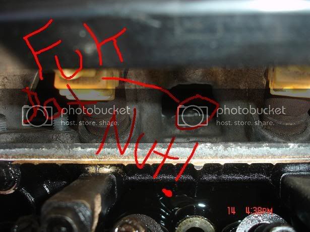

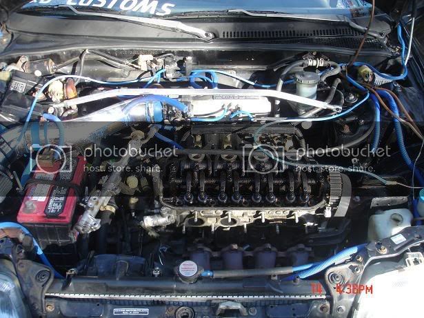

And here's some more pics just for fun.

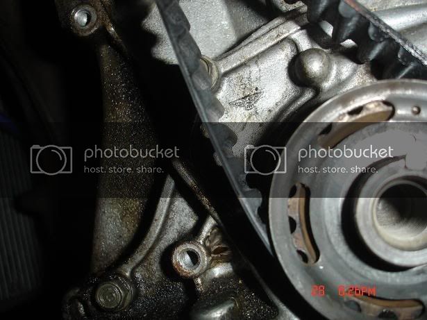

^Does everyone elses block have that little eagle? What exactly does that stand for?
When you pull the head off make sure that both the head and block surface are completely straight. Just a few thousandths of an inch (less than you can probably see by eye) is enough to cause problems. If either is warped at all you'll need to have it resurfaced before you put it back together.
Werd, get a straightedge to check it.
That eagle means that your engine hates jews and believes that the Arian nation will rise again. Zieg Heil!
Did you already put a new gasket on? Or are those old pics?
I planned on doing this also because the last thing I want to do is buy another gasket, do all this, put it back together, and it still leak because it's warped the slightest bit and I didn't take the time to check.

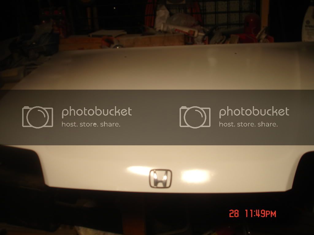

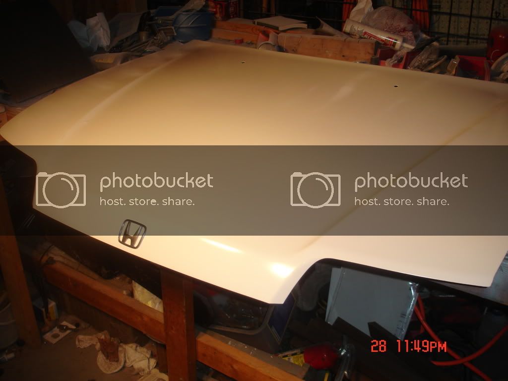

And now this has turned into an entire rebuild thread. I did some paint today. I'll post pictures tomorrow when it's dry and on the car.
EDIT:
2 pics from tonight, pics of it on tomorrow.
Spray Can :)
Flame if you'd like, but I've read of a few people who actually use spray can paint, but take the time to wet sand and blah blah. So I figured, hell, why not give it a go. So that's what I'm doing now. And if it turns out like shit, then I'll just pay a shop in the spring to paint it.
That's what I'm hoping. And even if I miss a spot sanding or something, I wish you all could have seen all the crap in my stock paint. Horrible. So many scratches, chips, chunks, etc. So This, in the very least, will look much nicer than that.

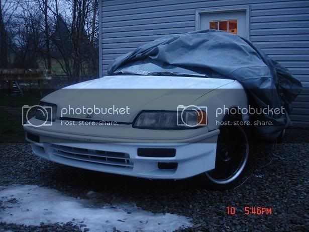

Yeah but I think this is gonna turn out just fine. Here's some pics of what I have so far, I'd probably have more done but it's been pourin/snowing all week, so I can't really take anything off for paint.
Yes, I know my bumper sags a little, it was wrecked before I bought it, I believe.
