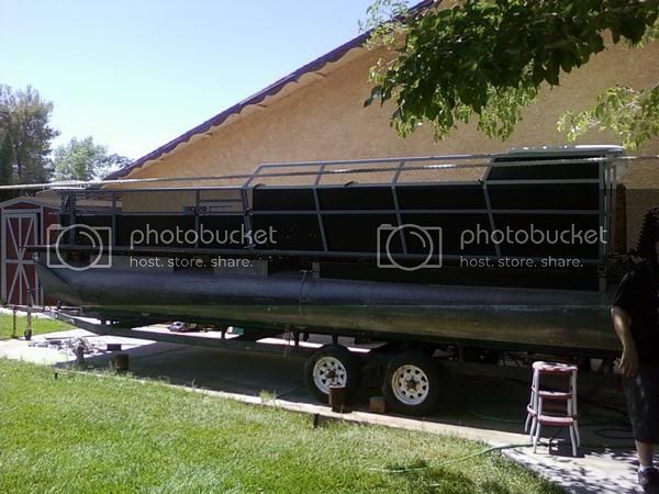

Pontoon boat - half finished

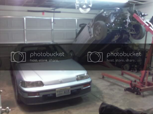

89 crx - disassembled entire car, stitch welded it, then did nothing with it...left it at the property when he moved...
