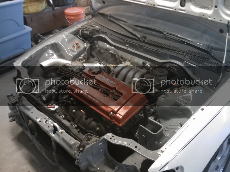

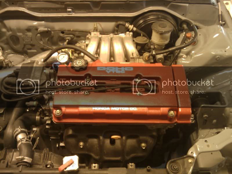

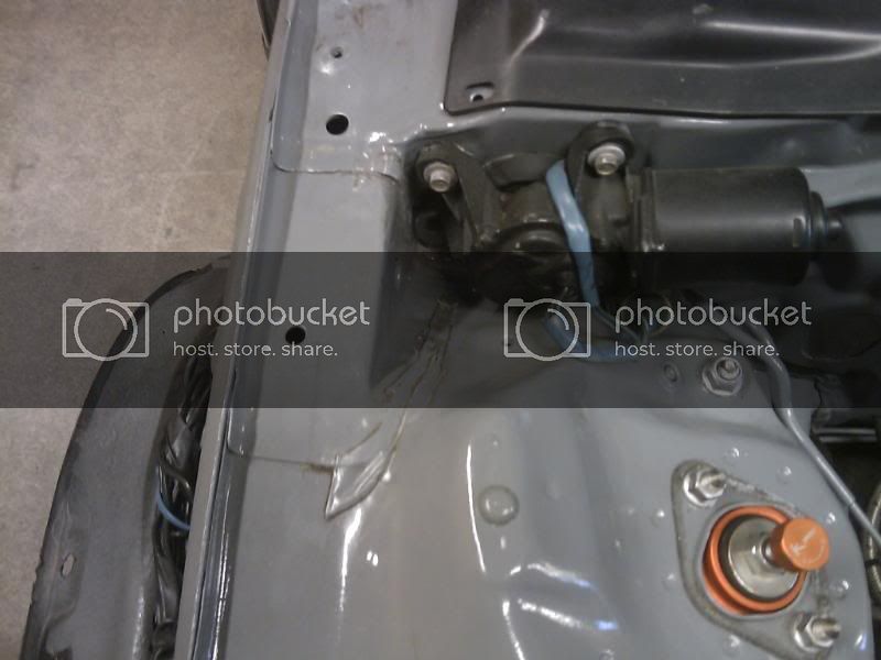

Anyway, I did some cleaning up of my CRX lately (and have been driving it daily for the last few weeks) including redoing some wiring through the passenger fender (and adding new extra wires for future needs) and repainting the valve cover and intake to match. heres a few pics for now. Gotta get some more of the full car since it's put back together!

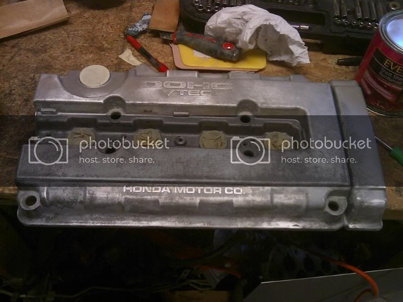

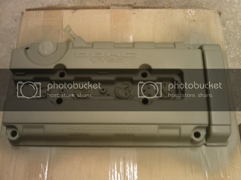

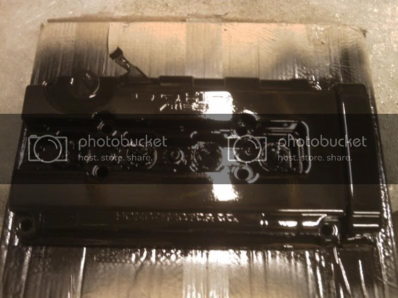

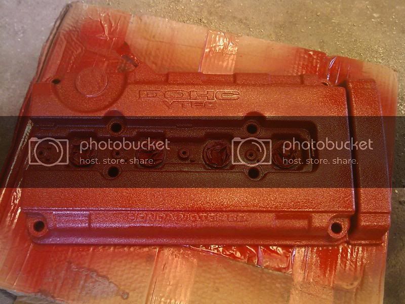

Valve Cover:
Notice on the valve cover I shaved a couple of the ground tabs and the casting lines after it was stripped
Self Etching Primer (better bond to bare metal. use it!) 2 solid coats

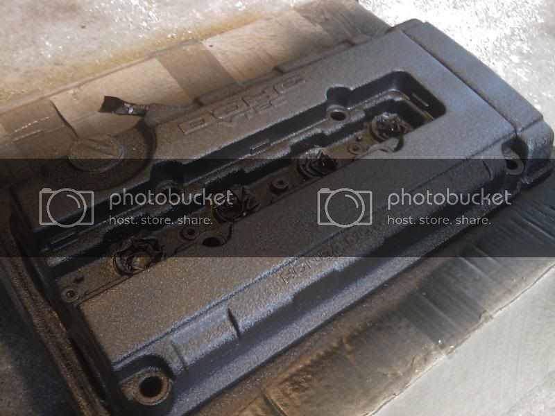

Wrinkle black. This stuff can be tricky. I've heard and seen (Mac_24_seven) bauch this up somehow, but mine worked out fine. You just have to lay it on very thick. it's not like normal paint where you do 5 light layers. GLOB this stuff on and it'll settle into a nice wrinkle finish:

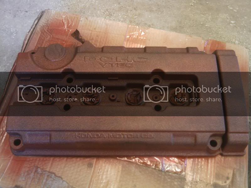

Like so:

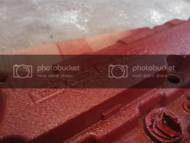

Then 1 day later(should have baked it in the oven. The black wasn't cured all the way through yet, but hard/dry to the touch. I'll know next time!) came the red. I decided to use Brake Caliper paint on this, just for the heck of it. turned out GREAT!
Tack layer:
3 coats:
Razored the letters then sanded them with some 220-320.

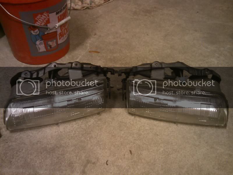

Also freshened up the headlights while the front end was apart. (forgot why I pulled the front end...)

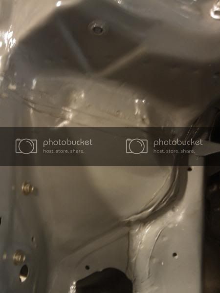

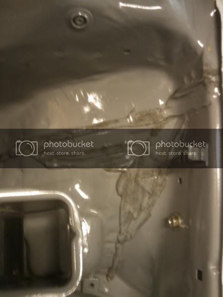

Also took some Acetone and cleaned up the jams where the seam sealer has collected the dirt (this stuff is like glue!?)
Before:
After:

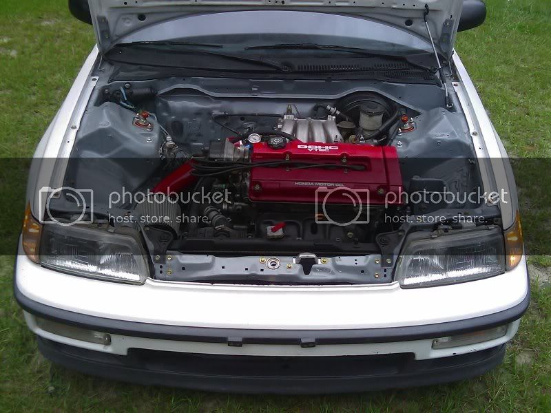

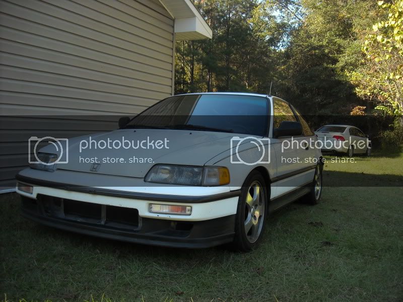

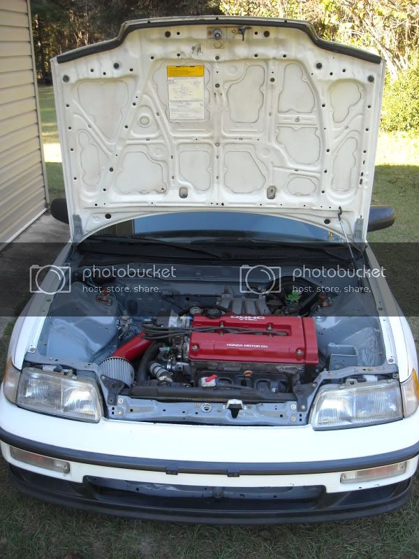

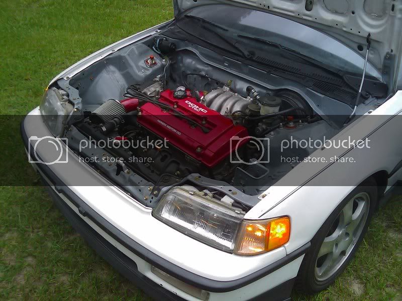

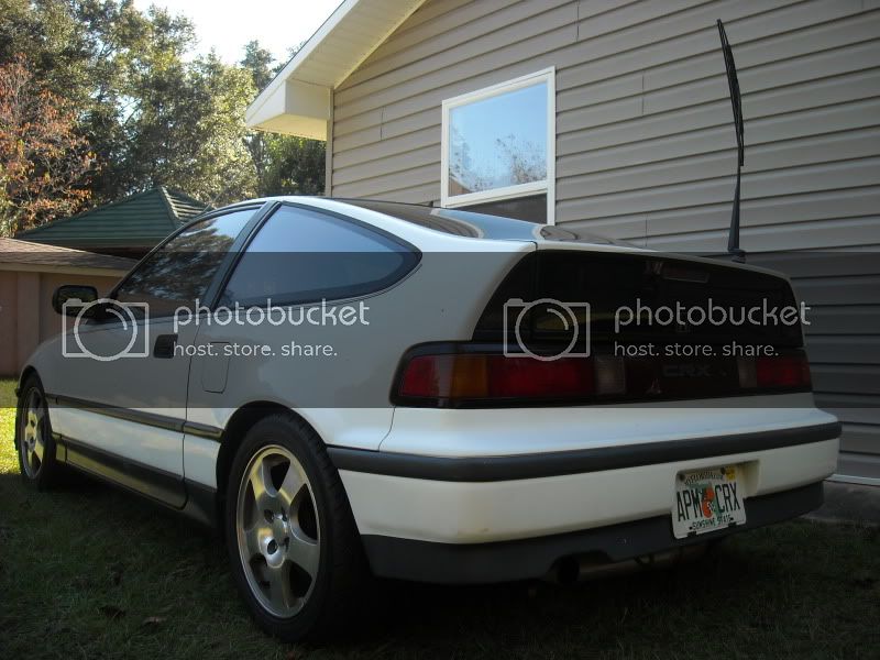

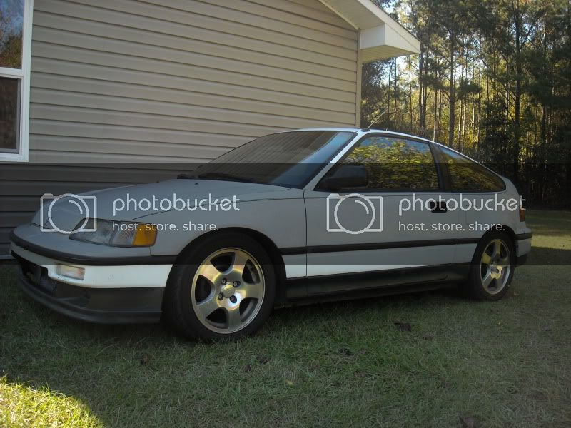

Heres the pics, guys! I need paint, bad. This is after a wash/wax, clay-bar, and ICE wipe on polisher/protector (I like this stuff!)
Going for the RC Car look :)

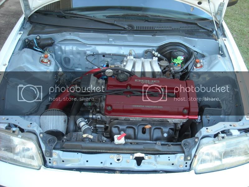

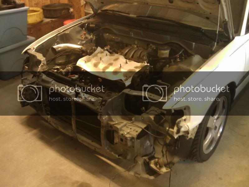

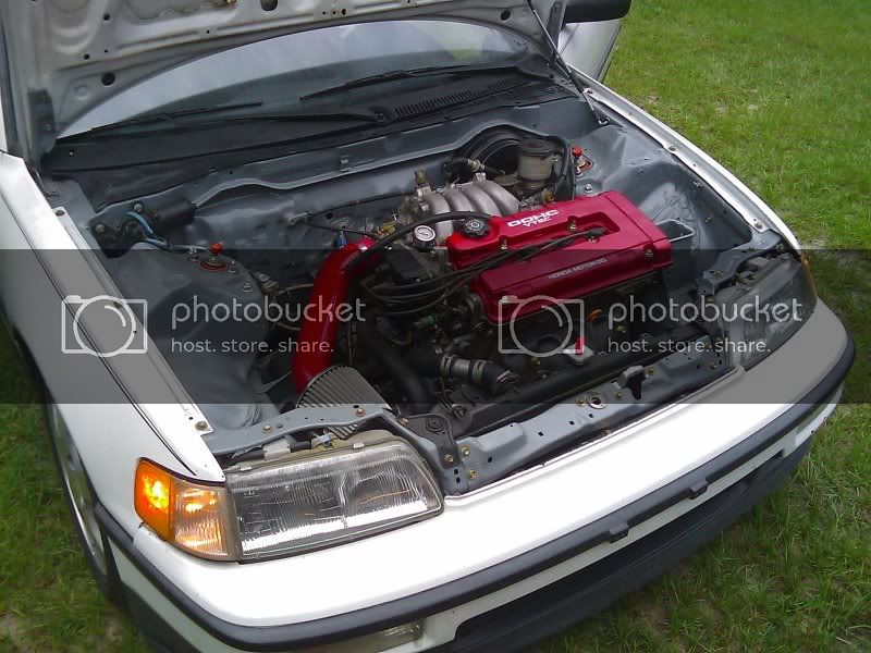

Coulple e-bay shots from before the wash:
And a couple e-bay shots after the wash.
And a couple random points of the bay that are new :)
-Andrew

I meant E(ngine)-Bay :D

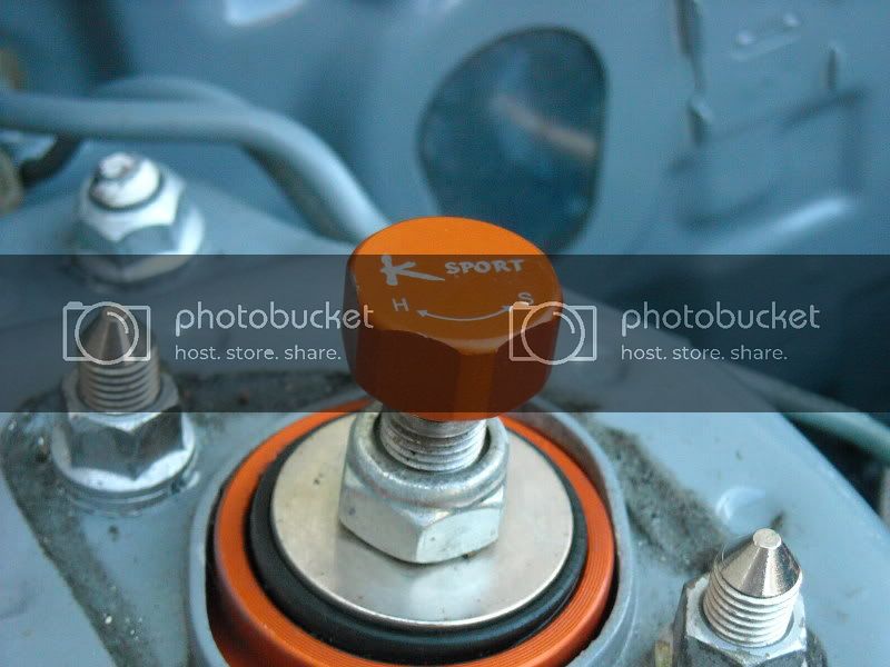

When did you get K-Sports on there? I have a set on my EJ, and I love them. and you have fat fives too! Jeez.
good eye! yeah my hood is rubbing a little, and I wasn't as careful as I should have been while I cut/sanded the letters... so a little imperfection here and there.
And yeah man I traded my old suspension setup plus some skrilla for th Ksports. I love em too! However i am not complimenting them with new bushings and sway and strut bars yet. that will make a big difference I think.

looks like ur motor sits lower on the driver side.. or higher on the passenger side.. wrong/bad mounts?
