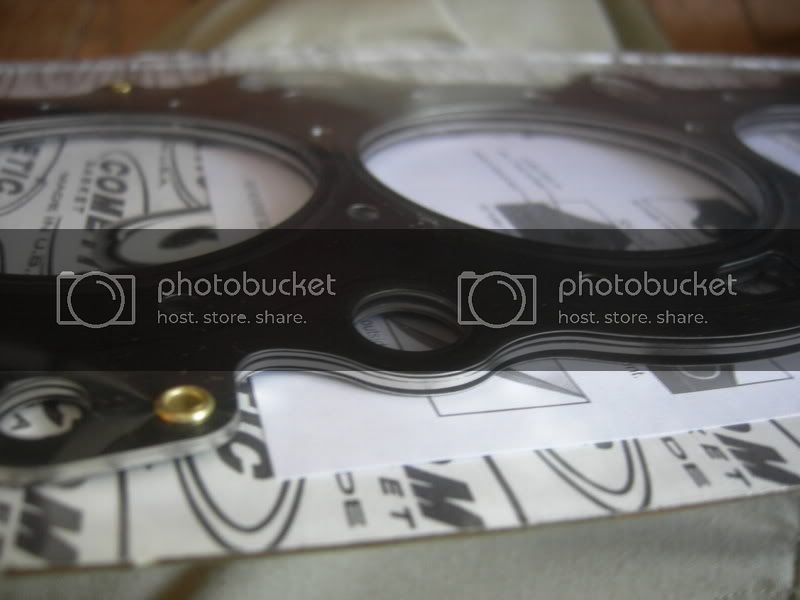

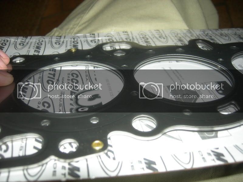

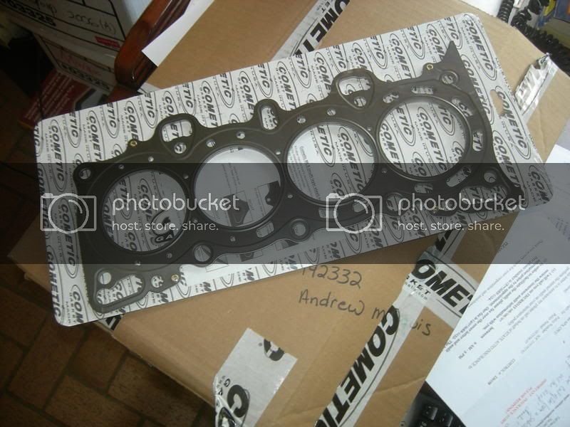

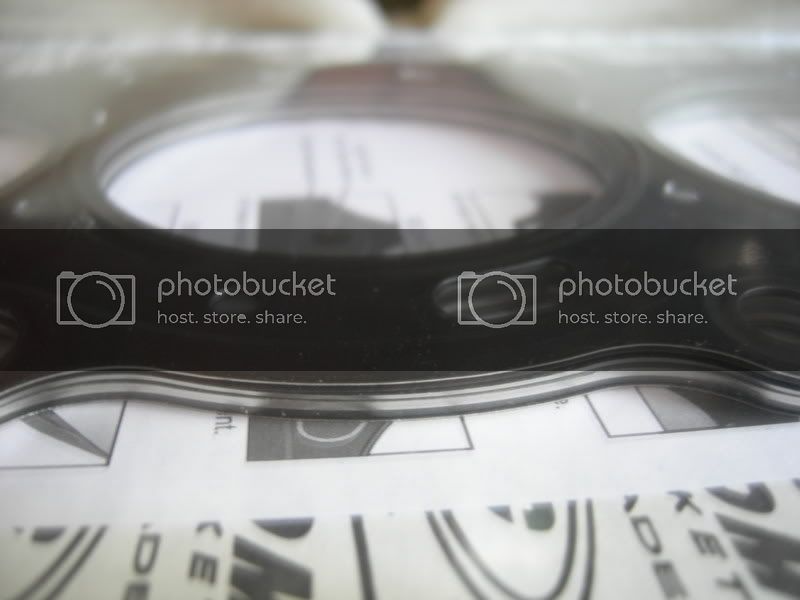

New gasket showed up from Cometic today!
75.5mm bore
0.074" thick! it's a beast, but it's all metal and will drop my compression to 10.05:1!
-Andrew

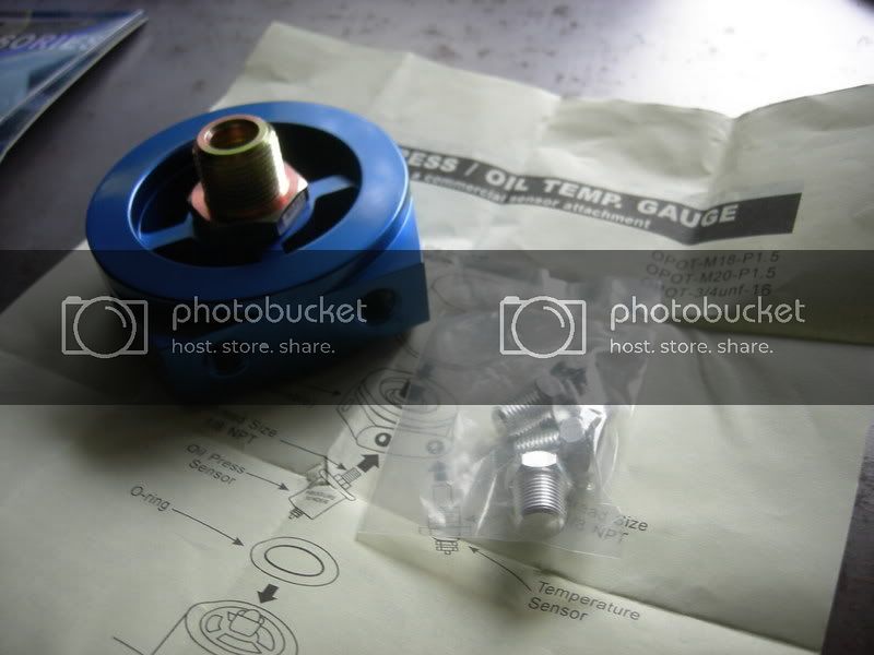

I've got my oil sandwich on the way so I can run my oil pressure gauge and my turbo feed line
And yeah man, this is probably the thickest one i've ever seen too!
Just think dude, they also sell 0.125". Thats almost twice as big! my compression would be 9:1 with it!

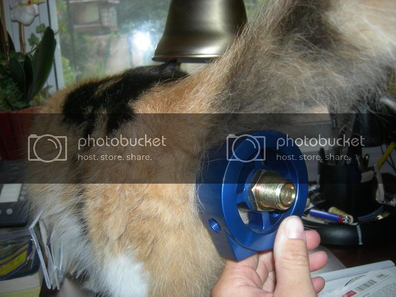

Oil sandwich came in. kitty wanted to check her oil temp and pressure, so I did a quick and simple install on her:
