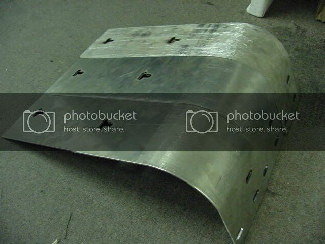

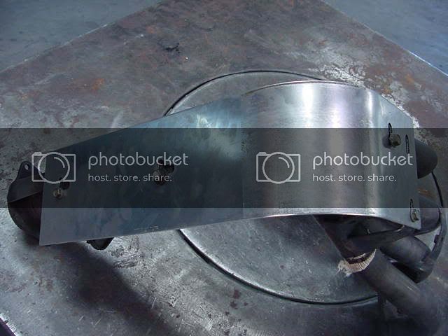

One custom ITR skid plate!
You like, yes?
For those who don't know the details.. I did it out of 1/8 as a prototype to make sure the holes lined up and whatnot, which they did. From Autocad to the finished product... 50 minutes.
I can make one now in about 25 minutes, maybe less. I dunno if I'm gonna be able to do 1/4" though (the material this is made out of) 3/16 is gonna be hard. Heck, making the bend on 1/8" wasn't easy at all.
Oh and as far as weight...
1/8 = 1 lb
3/16 = 2.2 lb
1/4 = 3.0 lb
You would think 1/4 would weigh 2 times what 1/8 does.. But it doesn't. Interesting.
Regardless... Anybody want a skid plate for their ITR header? ;)
I'll make one out of (or try to anyway) 3/16 this afternoon or tomorrow if I don't have the time.

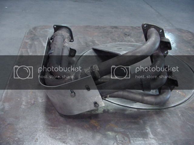

He'll update on why I have that header.. but I figured I'd borrow it for the week so I could duplicate the skid plate :)
I haven't had time to upload those pics yet... but basically it's impossible for me to have that ITR header... It's seriously like 2.5" ground clearance. I can't drive it down my driveway.
I put the B16 header back on. It's nice and tucked up there in the oil pan. plenty of clearance now...
Interesting facts about the difference between different headers:
B16- 30lbs
GSR- 20lbs
ITR w/skidplate- 20lbs.
Plus the ITR header w/ skidplate was about 3" taller than the B16. Thats why my ground clearance sucked so bad...

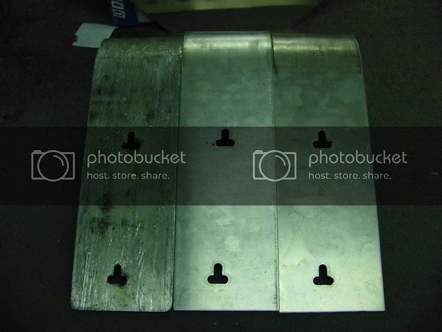

I finished bending the 3/16" one.. And it was as hard as I figured it would be.
BUT... I did figure out a different technique to bending it that won't be as hard... We'll see how it works out on the 1/4" tomorrow.
In the meantime.. Here's the 3/16" one in line with the original and the 1/8".
Took me about 7 minutes to bend the 3/16 one.

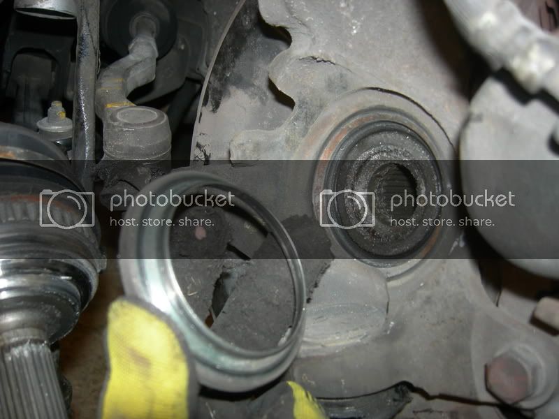

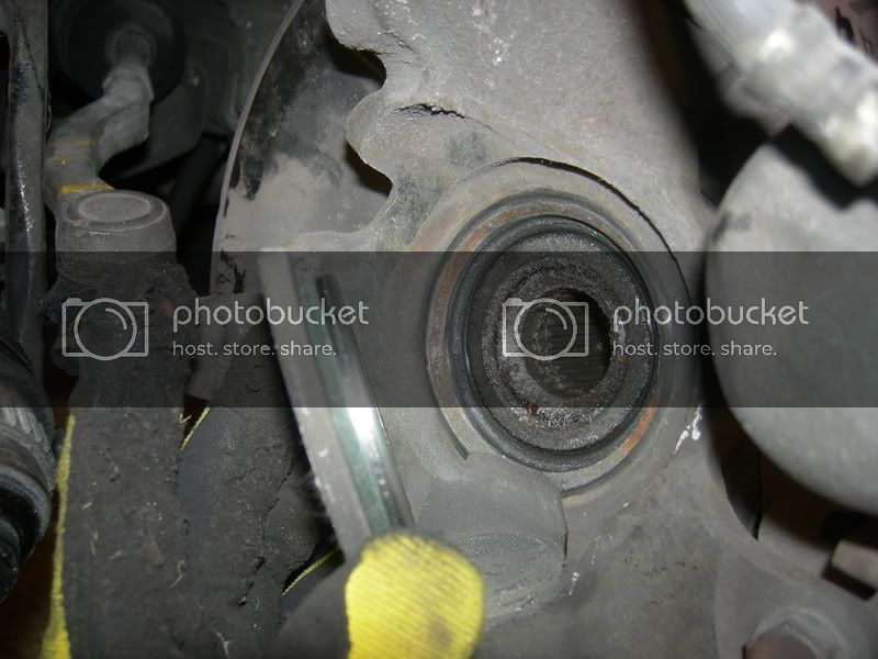

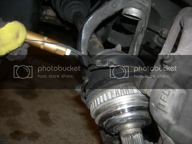

Heres whats been going on guys... the shaking is still happening. I realized that I hadn't removed the dust seals on the hubs during the install, so thats what I did last night:

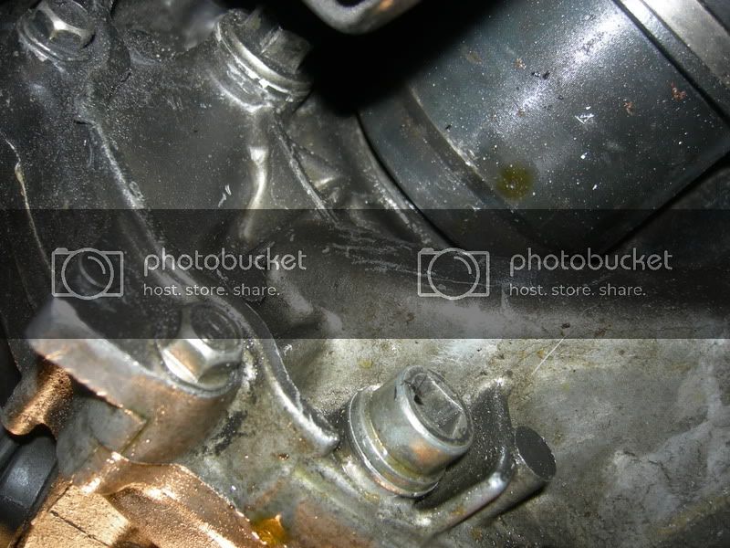

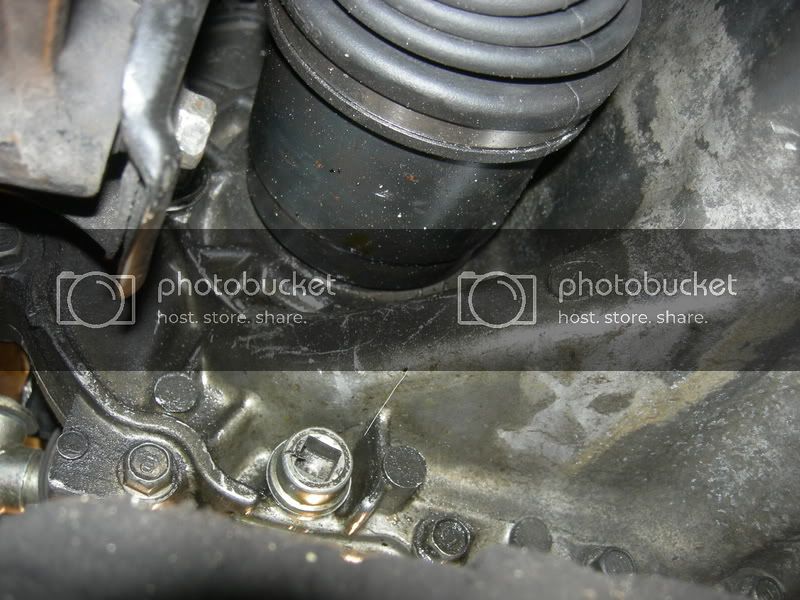

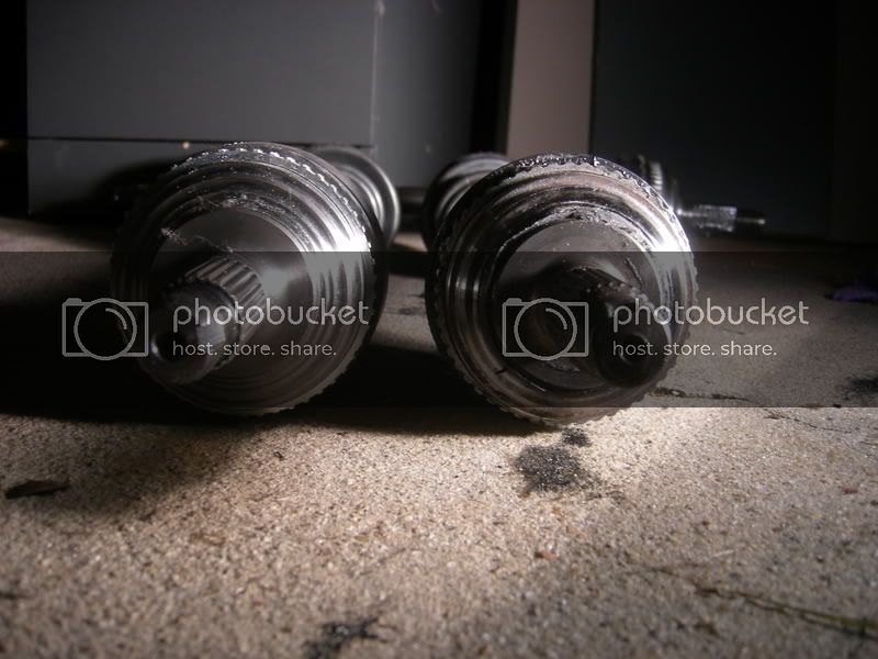

This is why I need to change my axle seal(passenger side)

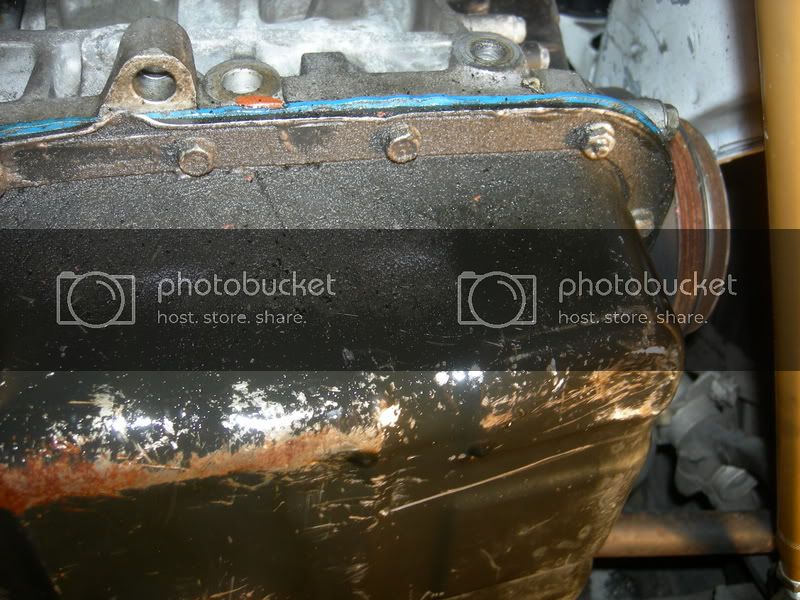

And my oil pan gasket:

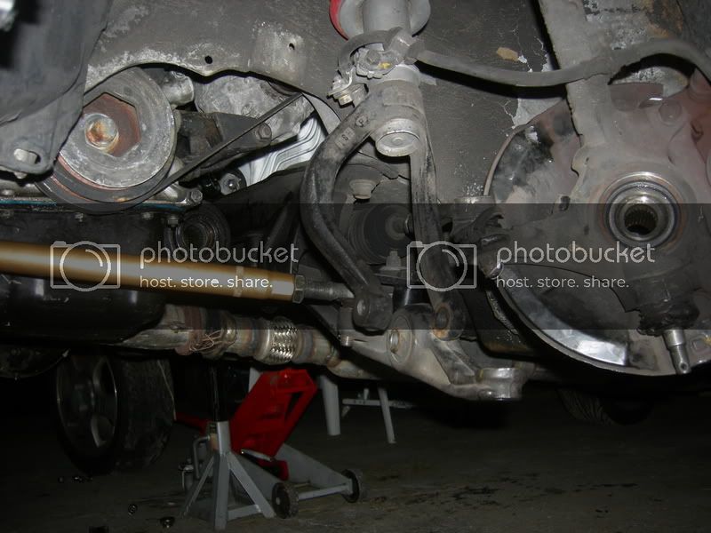

Temporarily wired up my exhaust to get me around until I can get to the exhaust shop.

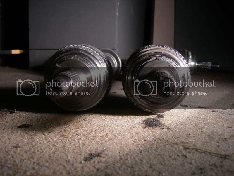

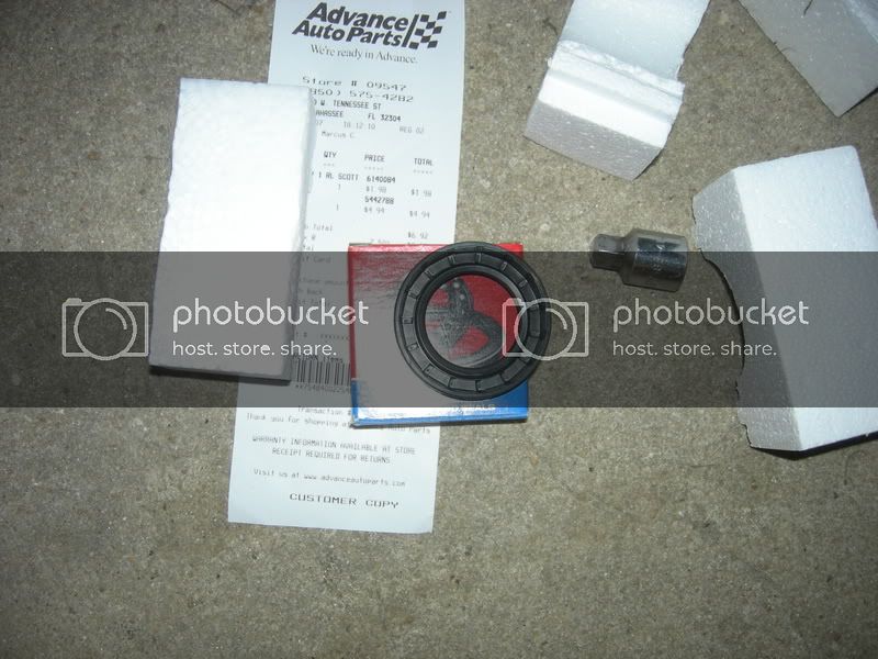

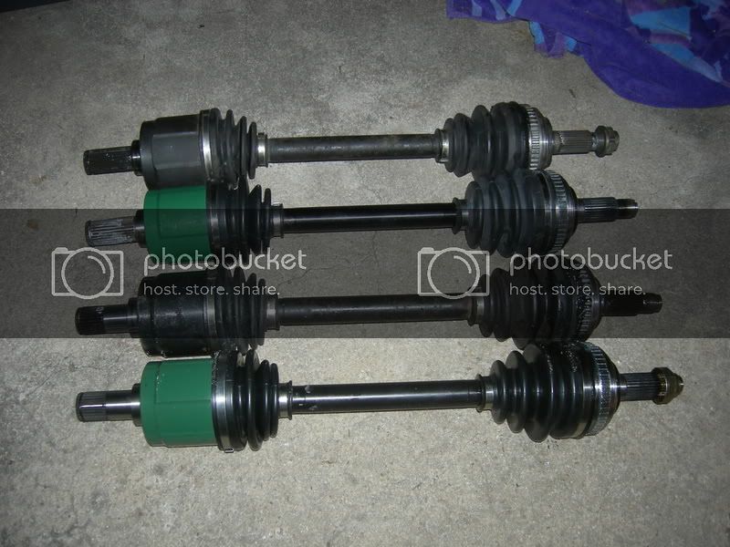

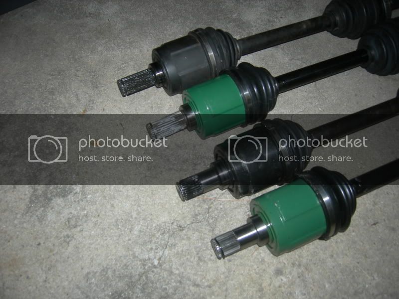

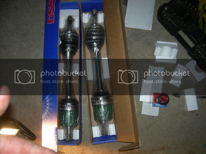

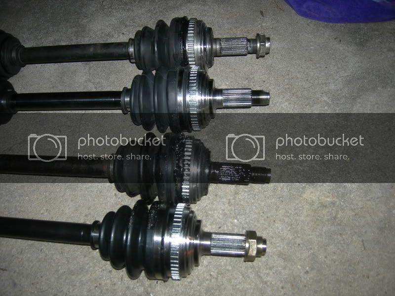

Got the new axles ($75 a piece BNIB!) and an axle seal(unfortunatly it is the wrong part. I just wiped the seal down really good and hoped it would be ok... we'll see.)
They all "look" the same...
But for some reason the passenger side is acting up on me. (drivers side is in and seems fine.)
It fits in (with enough "oomph"), but when I slip in the LBJoint and turn the whole assembly, it locks up when I try to turn it 'straight' ahead. Like it's too long.
I'm going to ask Emily(the chick I bought the car from) what mid-shaft they used. It's possible they didn't use an LS mid-shaft.(I bought LS axles)
So It's sitting there like you see it in the last pic. Waiting on me to fix it :(
