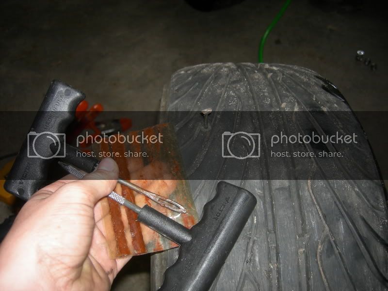

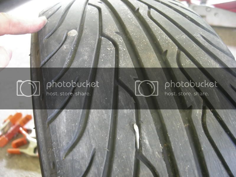

I just went out and rotated my tires and it's the same deal, but I found out what was making my right rear tire slowly leak....
The little piece on the bottom was just a piece of a nail... and didn't actually puncture the tire.
