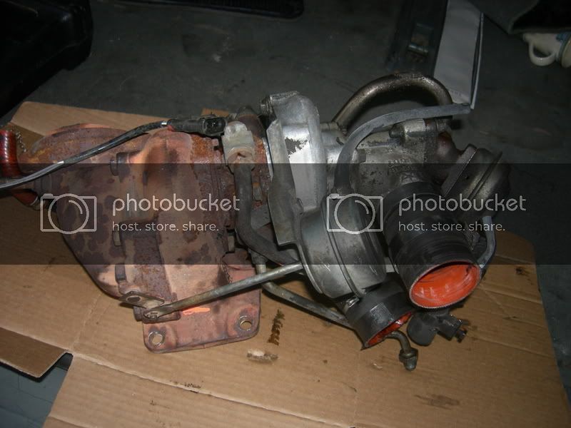

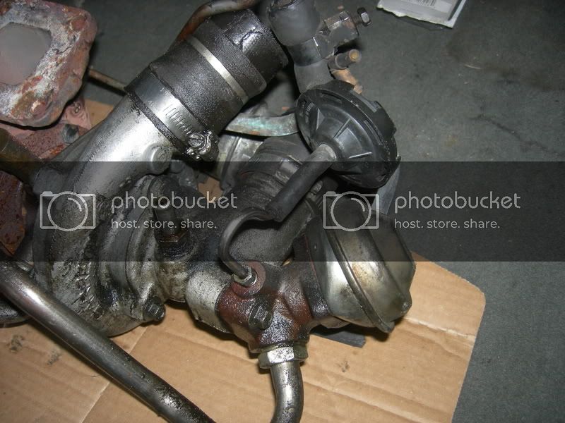

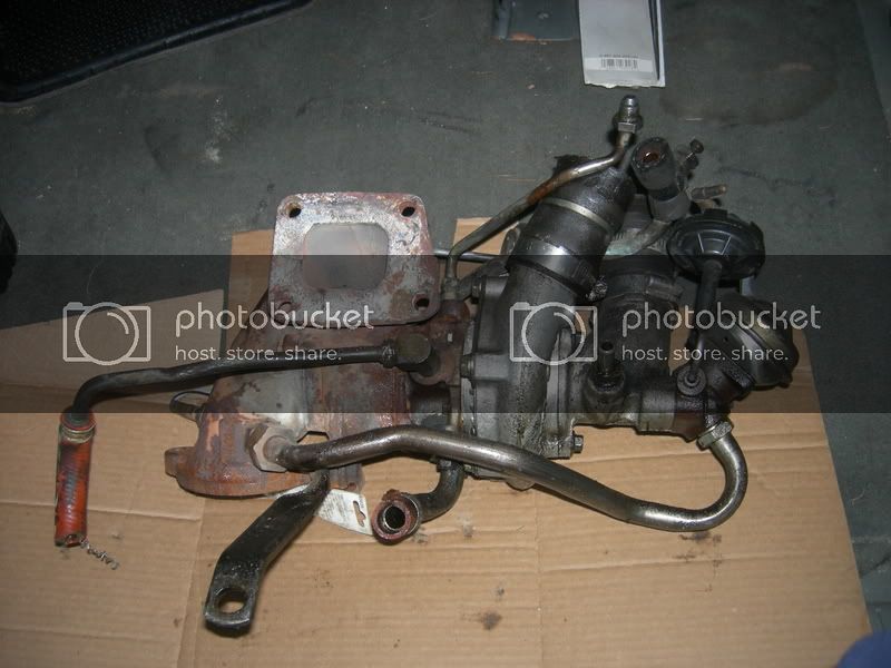

Heres some pics of it:
You can see the dump tube for the BOV going into the downpipe.
The BOV itself:
Wastegate:
Definatly going to rebuild it:

I'm just trying to figure out what I'm going to do for my downpipe/exhaust situation.
The way it's setup now is I'd have to make a custom log to point the turbo straight/forward and use the stock cast exhuast elbow, or I can just get a weld-on 5 bolt flange and do a custom 3"er. That will obviously make more power... so I bet thats what I'll do. Maybe not right away, but we'll see how things turn out as I start to tear it apart and rebuild it.

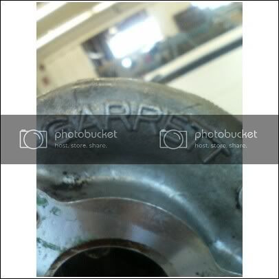

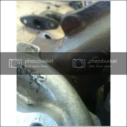

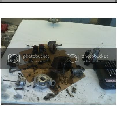

I disassembled the turbo a little bit in class today:
(sorry, didn't bring my camera, so heres some crappy camera-phone pics)
Diagnoses:
It was siezed, but I broke it loose no problem. I'm positive the bearings are shot. it will not spin by hand, but it's not that hard with a socket.
One of the 5 bolts on the DP broke at the head, so now I've got to extract 1 bolt.
The 6 bolts holding the turbine side are siezed(surprise surprise), so I stopped trying- I didn't want to break any more than I had to. I'm going to heat them up with a pencil torch and plenty of PB Blaster and see if I can get them loose later on.

Where did you source that turbo? I remember a few pages back that it was some junkyard gold, but do you know what vehicle?

Oh, and it's off of a '87 Chrysler New Yorker.
