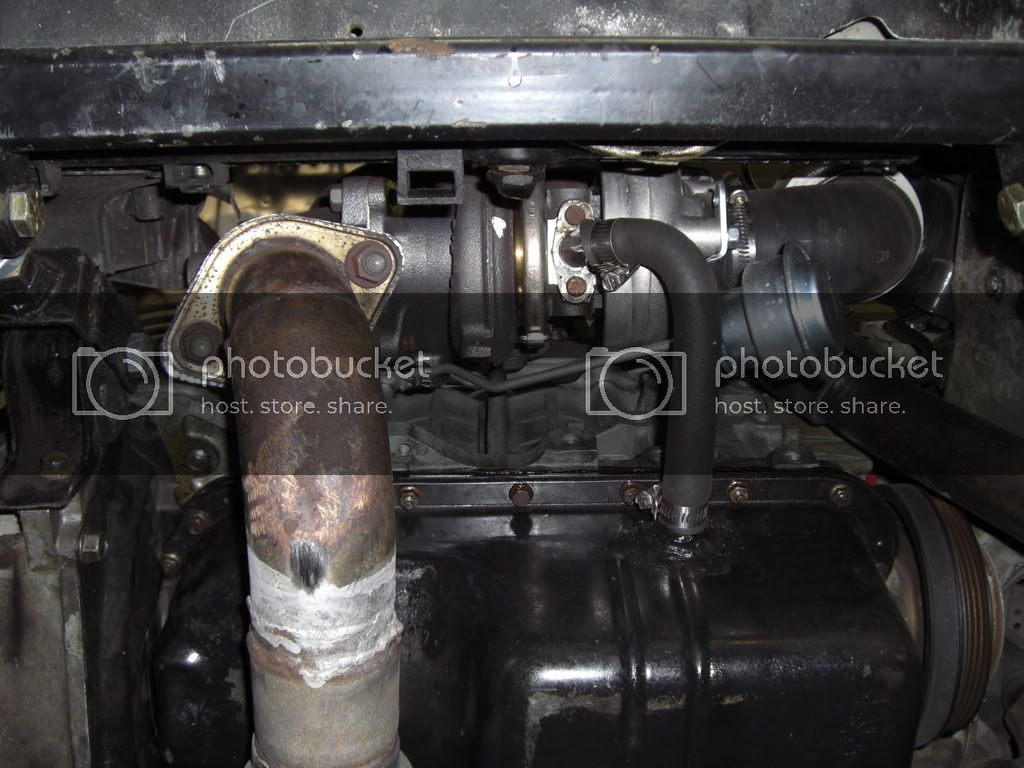

Hi andrew, i just sat and read the entire thread. Its nice to see another "panda" CRX owner staying with the D. I too have a 90 CRX si :) I see your debating boost or NOS, I think you should go boost and never look back. if you dont mind i can post a few links to pics and videos of my D16z6 at the track and what not. and if you have any questions or want to talk about boosting your rex with a DIY turbo set up like i did feel free to contact me.
here are a few pics and some vids. By the way the turbo used in most of these videos is sitting behind me and it is for sale, i ran a best time of 12.37@ 116 with it. it has no shaft play and has less then 10k miles on it. I recently upgraded to a different turbo and was going to keep the old one as a spare but if you want it and it will help get a fellow panda CRX owner into the 12s i would sell it to yah. any way pics and vids :)
this is with the old turbo the one i am selling
YouTube - Turbo D 16 verses GSR Integra
and this is with the new turbo
YouTube - Should have been my first 11 second pass
you can browse my you tube account and see more if you wish. Boost is what your D needs!! My car is full weight street car with stereo system, the head is bone stock the intake is bone stock EVERY thing is bone stock except the pistons and rods and i have a cometic head gasket and ARP head studs. any way I will be sure to follow your build.

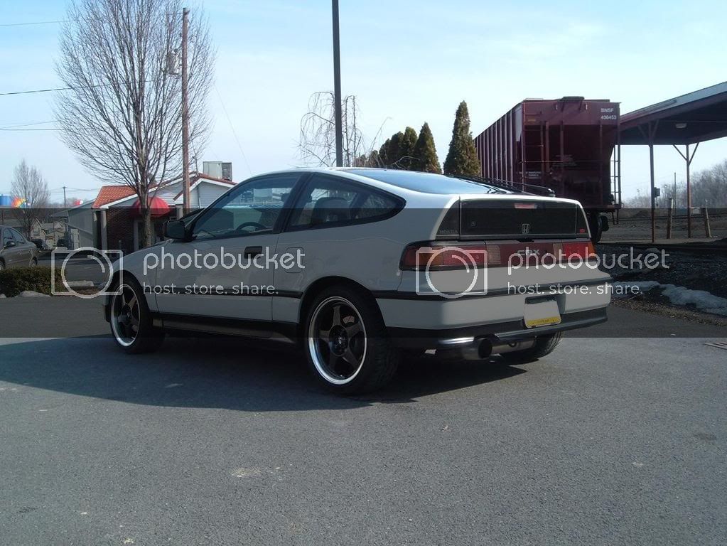

Thanks a lot for sharing man! Awesome times, and a nice looking car! (Love those wheels. D2's?)

the turbo is a big 16g I payed 700 for it and the o2 housing brand new about 7-8 months ago, i would sell it and the o2 housing for 300 plus shipping oh and i used DSM 450 cc injectors which you can get at any pick and pull or refurbished for like 100 bucks. let me know it would be perfect for the d if you lowered that compression a tad with that gasket. course i was running 20 psi with just under 9 -1 with 10-1 you will have to run less, closer to the the factory waste gate setting which is around 12 psi i would say to be safe. yeah i honked because they was bragging up how fast his GSR swap was and even with a 2.2 second head start the SOHC caught him pretty easy.

oh and andrew the street rims are 16 inch rota slips gunmetal with polished lip, the front drag rims are bogarts.

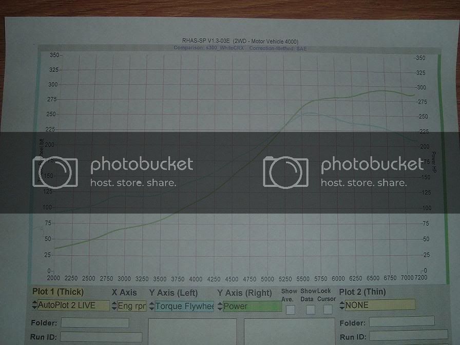

So that ~290hp was with the 16G? Same engine setup as in your sig?
What are you tuned with?

yes and same set up cept with dsm 450 cc injectors, and i am tuned on hondata s300.
The only upgrades aside the injectors are the scat rods and srp pistons and cometic head gasket the rest is OEM honda.
