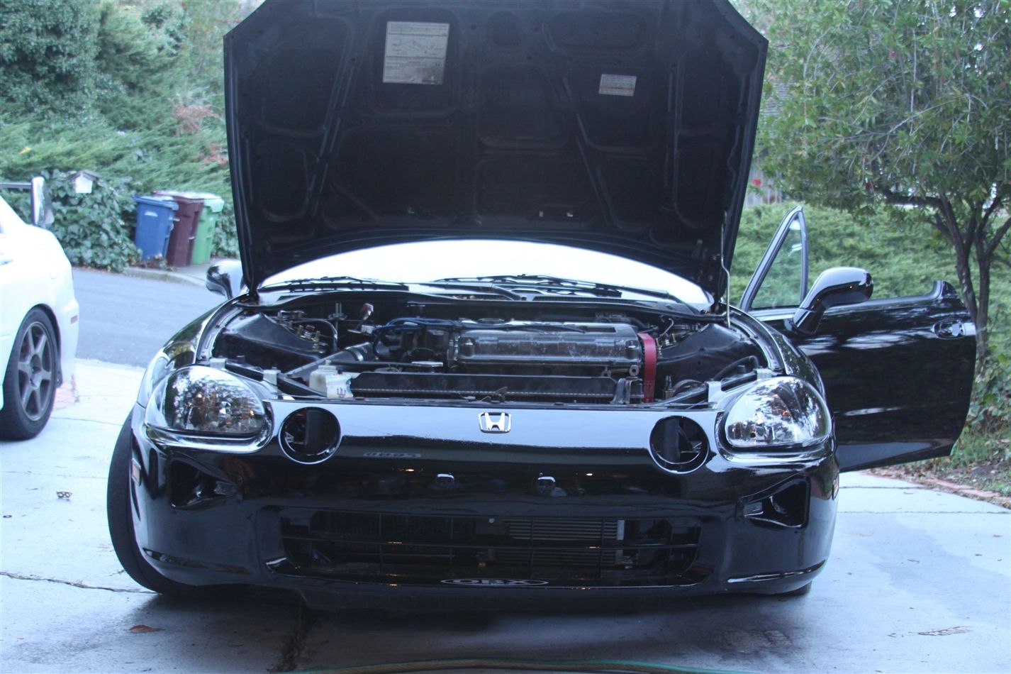

Wonder how much diff a CF trunk and hood will make?
My CF Fit hood was easy to lift with one hand. The stock hood took two hands, and some coordination.
If you get a decent CF hood, it'll weigh 20% of what the OE hood weighs.
Chris's CF trunk lid is insanely light compared to the OE lid. I'd say his CF lid weighs 15% of the OE lid.
You might save 75 lbs by both hood and trunk.

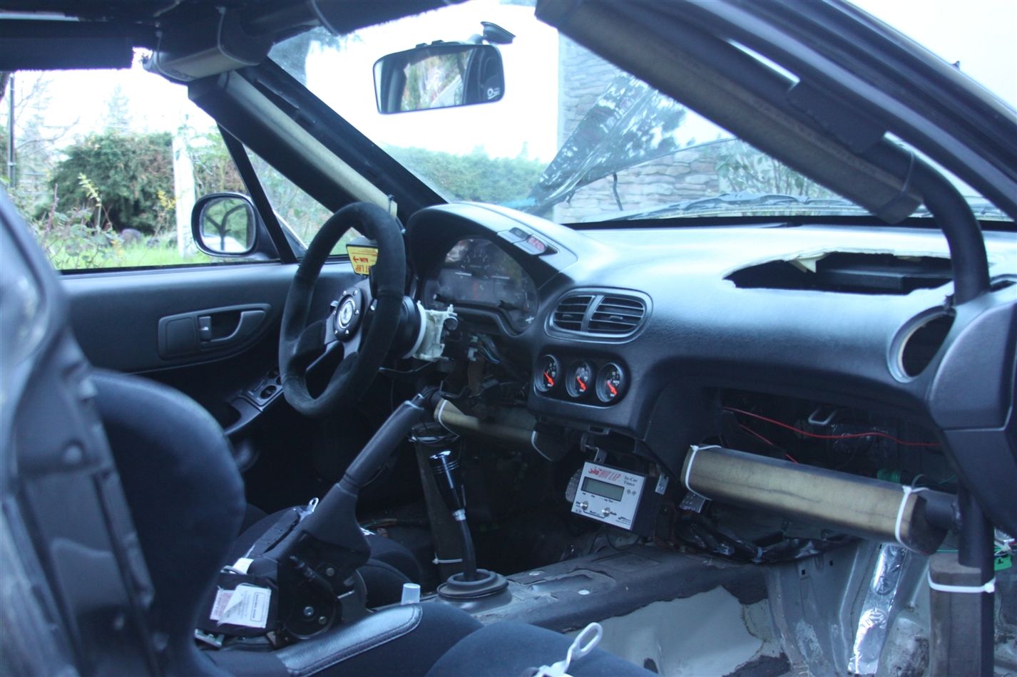

sick build. you give people like me hope with my car. one ? tho on the dash for the heater controls. did you make the gauge pod or did you buy it.
75lbs would be nice. I guess it could be that much if I removed the latching mechanisms and everything along with it, just using hood pins.
Thanks!
I made that gauge pod. I made a template in cardboard and took it to TAP Plastics and they cut it for me.
lol thats where i got my CF and resin when i made my leg brace... they were extremely helpful on the phone

no problem. ive been thinking about something like that but i think i may use my controls a little to much to put one there.
