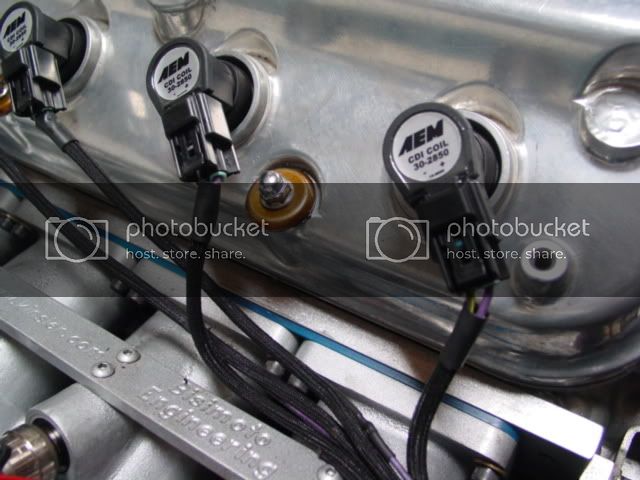

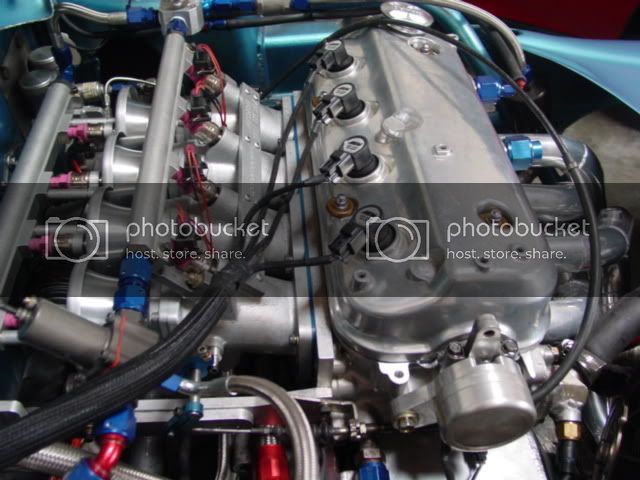

wow, now this is an engine that makes sense right here. sohc w/itb's .. go bisimoto
apparently, its a 9.522 second engine mounted in a drag crx.. notice how the top fuel rail is mounted so that injectors squirt into the stacks for an optimum fuel/air mixing environment... a beautiful naturally aspirated machine. in fact its making me hard and filling me with lust. i wonder if that top fuel rail is for nitrous, or if he is running 2 rails. but then why 2 rails? hmmn
Correction; that's a Honda Insight. His CRX is gone(when that motor was in the CRX, it was still using carbs).
You need to run two rails for two sets of injectors. He's running staged injection I believe. He does NOT run nitrous. With that ITB setup, he's just running methanol.

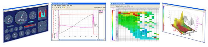

  • Log directly from the LC-1’s digital output into laptop w/included software:
