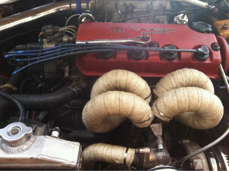

Yay bad news. So car ran strong the whole 1.5hr drive home, im nearly home, i step into it and make full boost, do it again and only make 4psi. So i pull over, to see the wires to my boost solenoid rubbed my PS pulley and split, so i reconnected them and the solenoid wont come one. I make 11psi but its not 21 i was tuned on. Tested the solenoid and its fine, the wires from the ECU show no power.. Hopefully i didnt fry anything when they split, its a 1.5hr drive back to the shop.. Ugh
Im gonna have to make the trek back to Carlise (1.5hr drive) soon to have some bugs worked out, making 10psi less thn what i was tuned on.
Sad day. My turbo seals are almost shot and smoking bad, and my ramhorn is cracked around the wastegate.
I found a full GSR swapp ( ecu, axels, harness, full motor, trans, axels, linkage etc) for 1200$ Is out of a running GSR. So im selling my 300whp SOHC and going with a GSR. Then im adventuring down the path of all motor :D
seals are like $50 to replace (and get a friggin restrictor) and a mani can be re-welded to patch the hole, probably for another 50 bucks.
why you want to spend 1100 more to be slower is beyond me...
