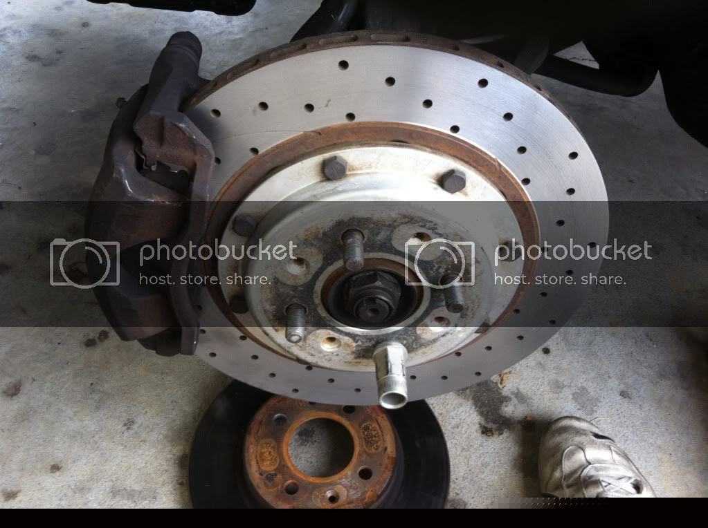

Ok so now the swap was in and now it was time to address a few things before the boost came. First order of business was the wheels/tires, suspension and brakes. I ended up going with the Eibach Pro System Plus, complete with springs, shocks and swap bars. As far as brakes I ended going with an AEM big brake kit for now with hawk pads. Will probably end up going with the Willwood kit before long! As far as wheels go I went with some 16" polished Rota slips, wrapped in Falken Azenis (215-45R16) to round everything out!!
More pics:
And yes these brakes do fit behind 16" wheels, I still have about 1/4 gap between the calipers and wheels with this setup. These AEM brakes kind of suck, good thing I don't have to much money in them. I wonder if Fastbrakes has figured out a way to mount the willwood calipers on the AEM big brake kit? Will have to find that out. Oh and by the way I ended up doing a complete 99-00 front end conversion (headlights, front and rear bumpers, both fenders, hood, foglights and both front and rear lips). I'm probably going to end up going with a Back Yard Special (BYS) front bumper before I finish the exterior though.
And now pics of the new stance:

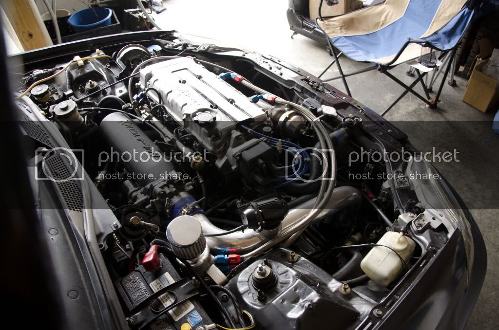

Ok now the next order of business was to have Mainstream fabricate me a valve cover ventilation/catch can system for the boost to come!!
Lines and catch can mocked up:
Valve cover stripped and prepped for some welding:
Ok now that the ventilation system was taken care of it was now time to swap the Skunk2 intake manifold for an Edeldbrock piece:
End results:
Next up was mounting of the intercooler and some modifications to the intercooler piping to get everything to fit snug. I got the intercooler off of ebay and the dimensions are 28x8x3.
Next I ordered some 1000cc injectors from Fuel Injector Connection up in Cumming GA (freakin awesome deal) and a Walbro fuel pump. Now you would think that all the hard crap was done...........wrong (rant time!!) I swear I had never seen people that will post something online that they are trying to sell and then when you call them and tell em that you want to buy it they flake!!! I probably found 3-4 nice quality turbo kits ranging from $1500.00-$3000.00 that people were trying to sell that I could not buy for some reason. I would get in contact with them and say:

Next was the tune which Scotty @ Mainstream did for me. Setup ended up making 360hp @ 14-15lbs. The turbo responds very quickly and was at full spool around 4k rpm. The boost comes in real smooth and has a very broad power band. We tried to go higher (19psi) but the waste gate spring (6lbs) said hell no. No worries because very soon I'll be purchasing some cams, valve train, throttle body, equal length mani and some other crap that I can't remember then I'll retune and see where I'm at. I am very happy with the power output or hp per dollar spent. At 300hp (9-10psi) the car is a beast (ripped the welded driver's side motor mount 3 times and counting). So don't hate on the egay to bad, when this turbo decides that it wants to take a poop, I'll replace it with a 60-1 Garrett variant FTW!! I don't have any pics from the dyno but as soon as I'm done posting this thread I'll upload them to Youtube and edit in a link.

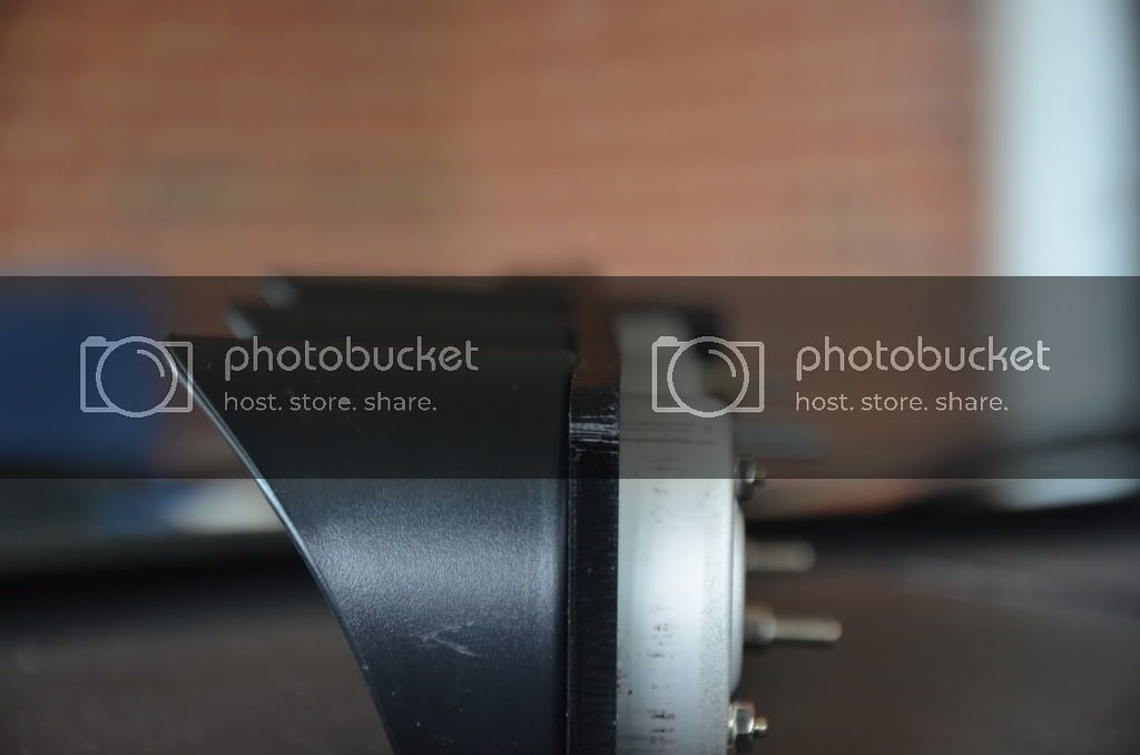

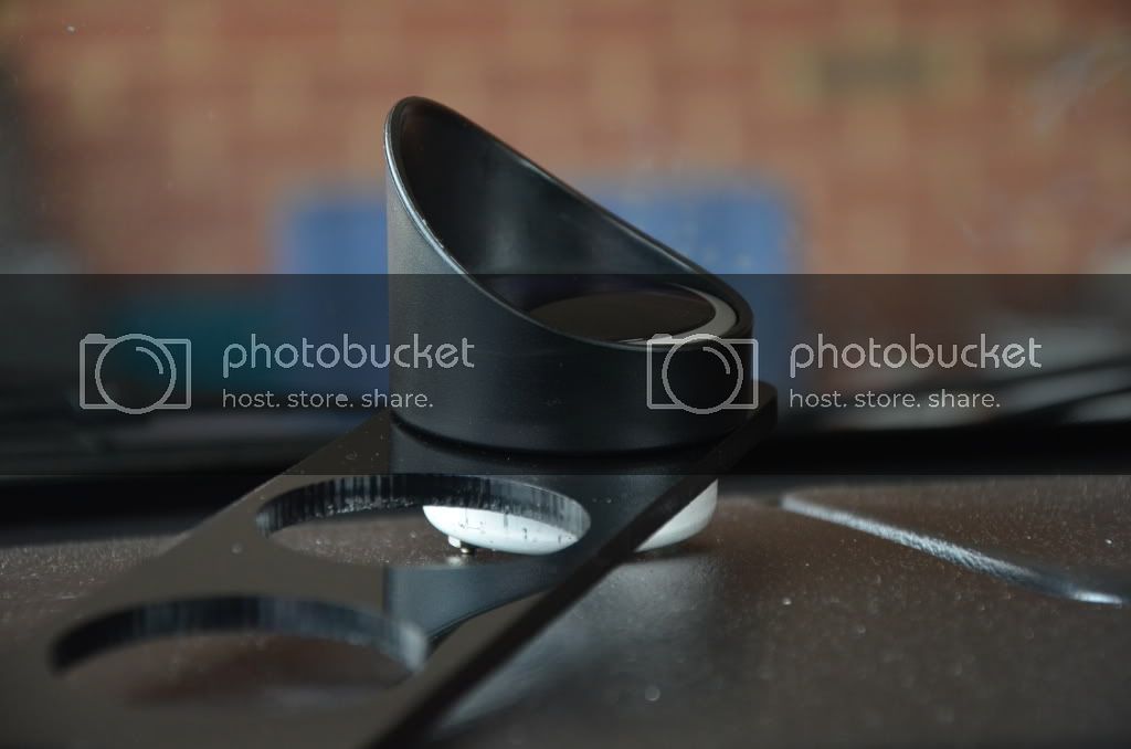

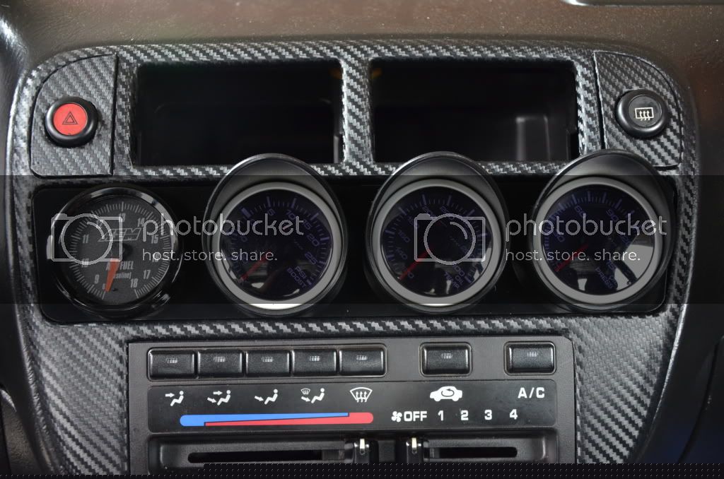

I just took some pics of my gauge holder that is finally out of R & D (pics are in the first post). I'm very happy with it, took a while because there are two different angles on each side where the gauges are located. I think we were able to get it almost perfect. The holes in the gauge holders were cut to 52mm. After test fitting all the gauges in we were finally able to get a snug fit on the the gauges without having to use any shims or anything. I even turned it upside down and none of the guages moved or acted like they wanted to slide back out (very happy). Another important note was after installing the new holder in the dash there was an even amount of spacing between the dash and the gauge holder, each gauge and from top to bottom. As mentioned in the first post the default color on these holders will be black 1/4" acrylic. I went with the 1/4" because it needed to have enough depth and thickness to fit flush in the dash where the factory radio and coin tray were. When looking at the photos keep in mind that its installed in a 1997 civic ex, I have 4 gauges where a radio and coin tray used to be with plenty of room to spare. Also remember that if you wanted one of these I can do them in almost any configuration whether it's 1-4 gauges, 2 guages and a turbo timer and an electronic boost controller, etc,. I'm still working to get the exact measurements of all the popular boost controller, turbo timer and even apexi for there vafc/afc line. I'm doing this so that you can now have all your gauges and electronics in one central, clean location thats easily accessible with a quick glance while driving down the road. If you have any questions about any of it, shoot me a pm and stay tuned, got plenty in the works like (S2000 gauge cluster into ek/eg civic adaptor kit, other gauge holders for other cars and a whole lot more). And as always thanks for the compliments and feel free to offer suggestions that might make it better!
Pics as promised:

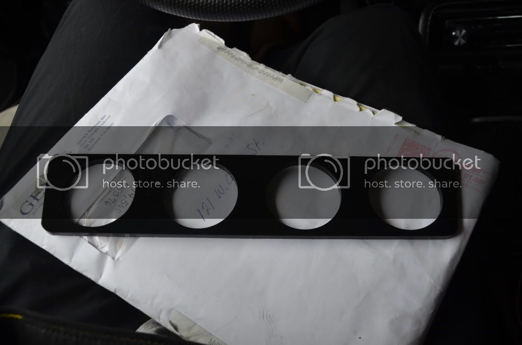

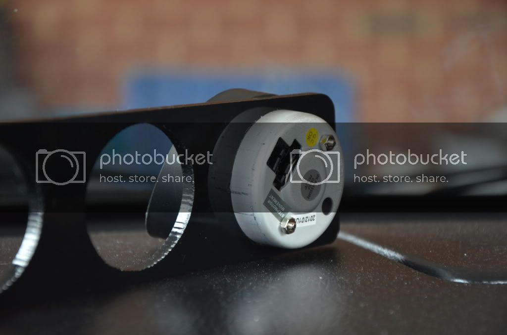

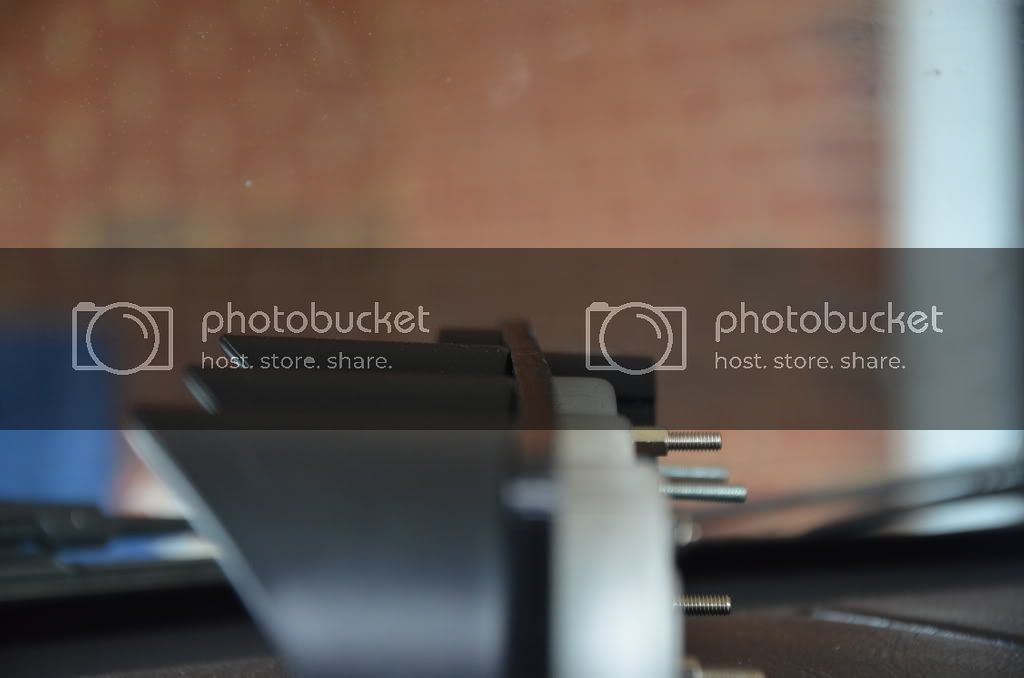

Pic of the gauge holder not installed yet. These holders are cut with a precision laser cutter so that duplication and a snug fit is effortless. Again this one was cut out of 1/4" acrylic, in the future I will also be offering holders that are 3/16" thick, as some applications won't need such a thick piece.

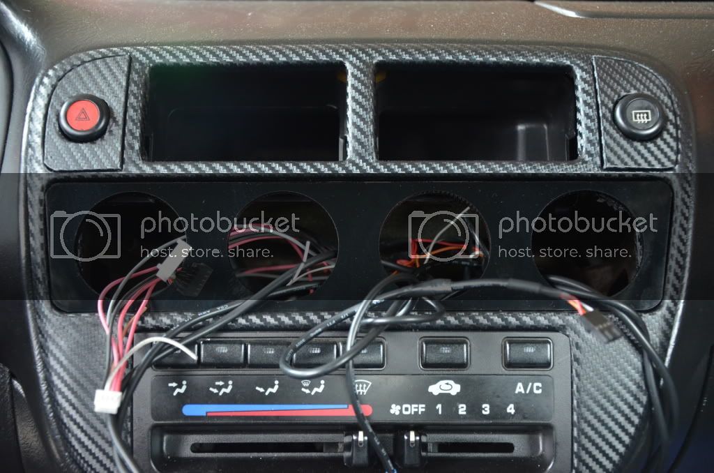

Holder installed with no guages inserted, look at the space between the holder and the dash, doesn't really get any better than that. Ok it could have but dang this is the first one lol!!!
With one gauge installed, achieved an almost perfect snug fit around the gauge itself.
Another view.

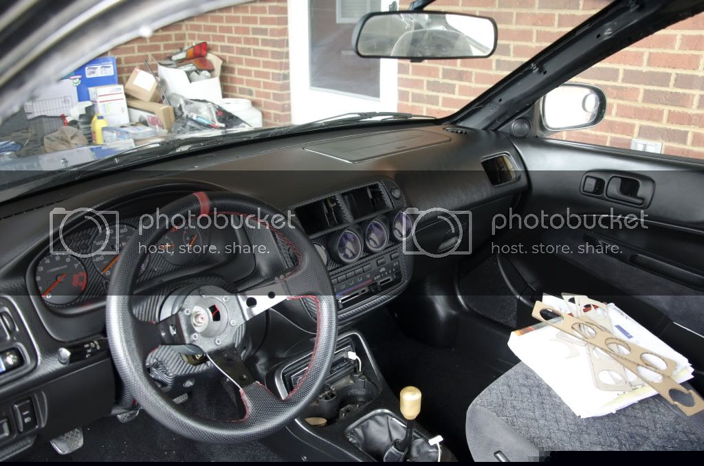

This pic is with all 4 gauges installed, look at how flush they all fit. Even with my particular gauges having a hood to block sunlight the gauges are all flush with the top of holder and not hanging off.
Another view.
Everything installed, check out the spacing between each gauge as it is an equal distance between them all. Also after achieving such a snug fit with the dash, only a couple of pieces of heavy duty velcro are needed to secure the entire holder. This holder will not budge!!! I've been using the same two pieces of velcro on 4-5 different prototypes and its still holding strong!
Last one, hope you guys like it as I'm very proud of them!
