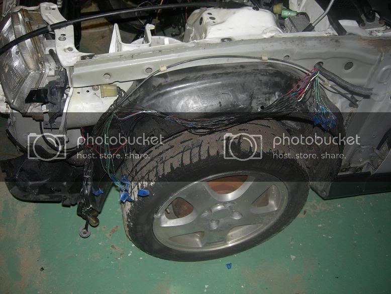

you just madea big mistake, you have to solder those connections, they are the veins of your electrical system
soldering is not hard at all : heat and apply solder
i would go back and do it over
I agree. Even though it's working now, please trust us when we tell you that it may not last very long.
Having a good connection ensures proper current flow, which is pretty important if you wanna see through the darkness at night. ^_^
Like formby said, I too would suggest re-doing it correctly. Radioshack sells a butane soldering gun and .035" solder which is (IMO) perfect for this job. you don't have to worry about power wires for your soldering gun, and you can easily manuver everything w/o the excess tension on the iron.
There was a great tech article on soldering on here... *rummage, rummage*
Here it is.
Also go ahead and buy some heat shrink tubing from Home Depot or somewhere. It's MUCH better than electrical tape, as far as keeping a secure connection sealed.

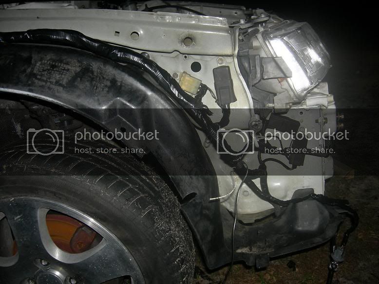

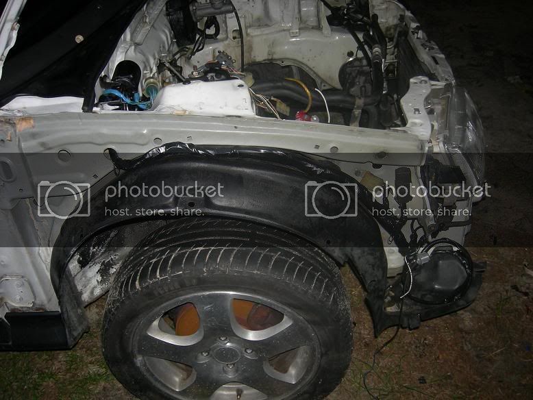

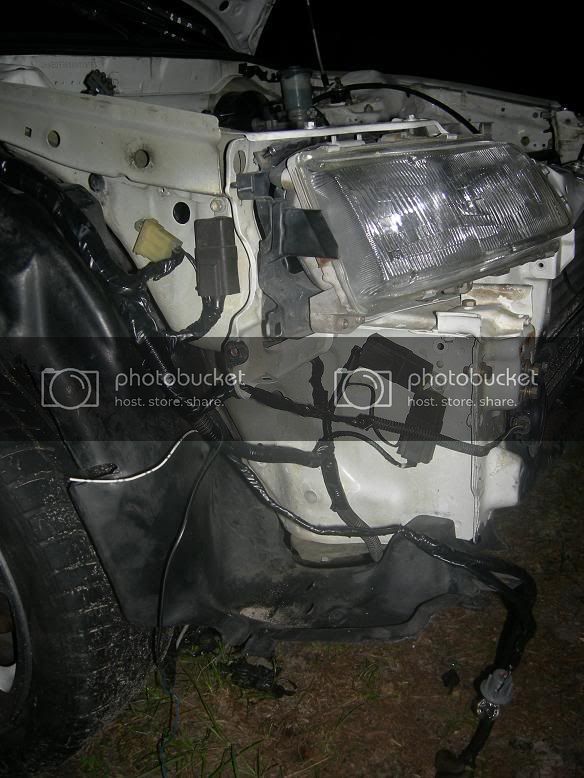

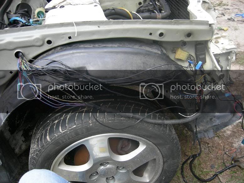

Tada!
Passenger side is DONE! (all except for 2 wires....^_^... yes it was on purpose...)

noice job!
i wouldnt want to mount those electrical boxes so low, though. i would have probably elec-taped them all together and strapped them to the outer frame inside the fender.
The Relays?
Naa. there fine. They're hidden/covered from rain by the bumper.(if thats what you meant)
well yeah, but that doesnt mean water wont get in there.
well, now is the time to move it if I really need to.
I've seen guys do it this way on their tucks, so I think it's ok, but I still wanna be able to change the relay when/if it goes out, hence I'd rather not tape everything up. but if you guys really, really think they should be relocated, I guess I'll consider it.
i think they look fine where they are... besides i think they actually ground through the mount point
damn your rotors are rusty!!
it's probably because it's been sitting forever.
also, for next time, don't cut all the wires in the same spot. stagger them you don't have a big section of wires that have had work done. space them out a little bit.
Oh No! Not a Same Color Wire Mod!!
I would have bought a spare harness & hacked that up in order to make extending the wires match... If ONE wire is wrong, your FUCKED.
Thats why I took my time and made sure of my wiring.
And I'm not color-blind...
Yeah the car hasn't driven in about 3-4 weeks, and probably won't for another 2-3.-waiting on motor....
And thats a pretty good idea. I'd probably would have been easier, but o well.. I guess I'll do it next time like ya said!

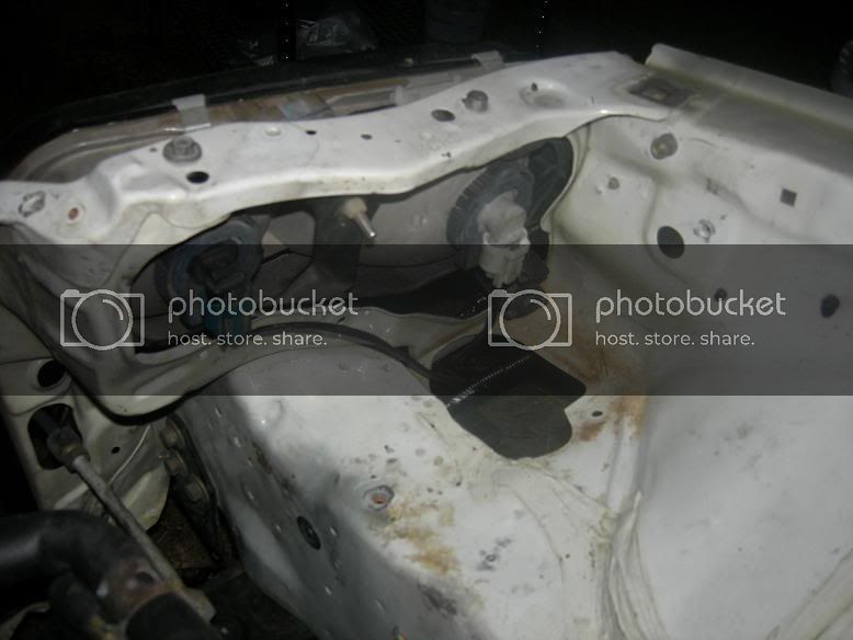

I'm almost finished up with the drivers side:

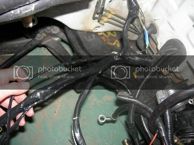

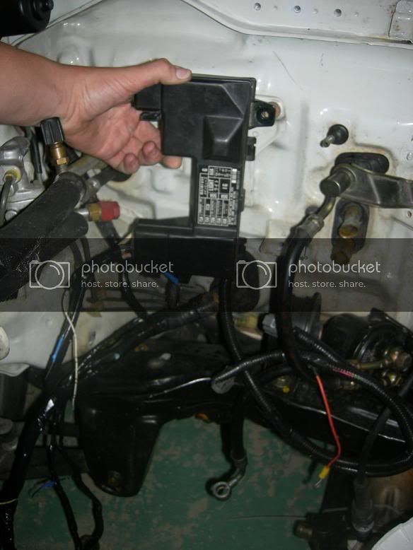

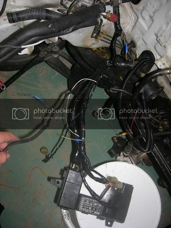

And I cleaned up my engine/cabin harness. I'm thinking this is how I'm going to mount the fuse box. (let my fuel filter hide under the IM. probably secure it with some zip-ties or something...)
-Andrew
What does everyone think of that fusebox location?
I think the only draw back is gonna be the excess length of wires coming from the cabin, however, I think the trans will do a good job of hiding it.
